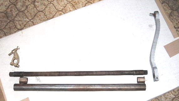

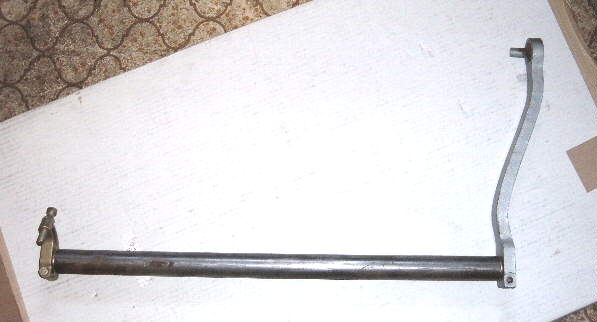

  5. Here's what I'll be using....vintage sprint car stuff. 1 1/2" Dia. X .120" wall tube housing, bronze bushings (that fit the housing I.D.) with an end flange and 1 1/8" bore, 29" long torsion bars with 1 1/8" Dia. shoulders, steel arm with 1" splines, and steel adjustable stop with 1" splines.
    They will be mounted parallel to the centerline of the chassis with the arms attached to the split 'bones via some kind of shackle. A panhard will center the axle in the chassis.
