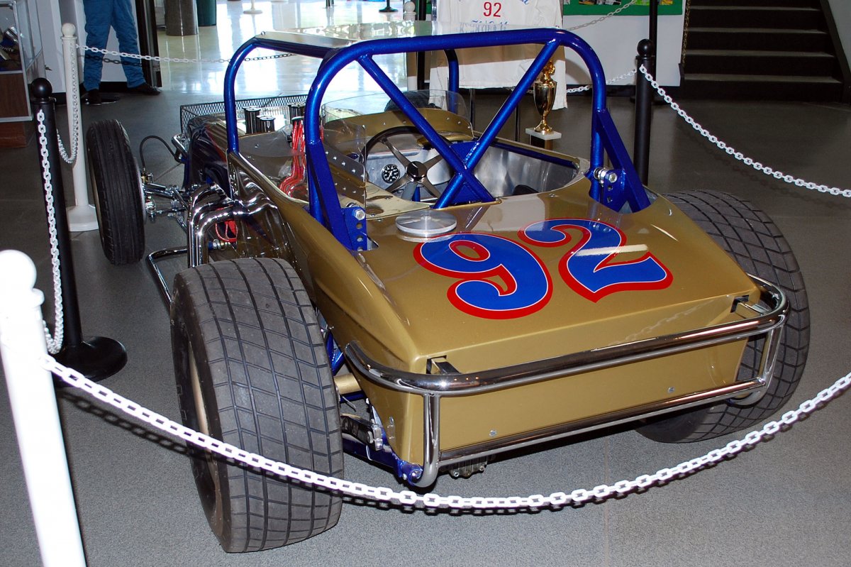

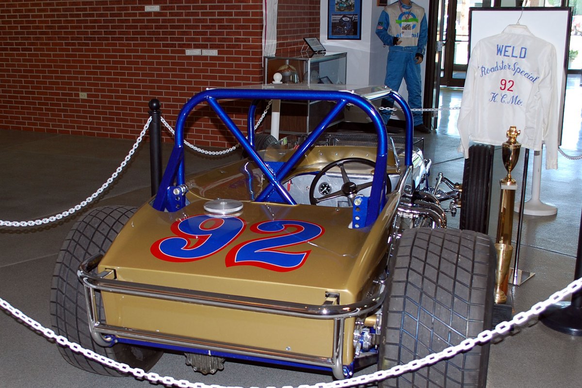

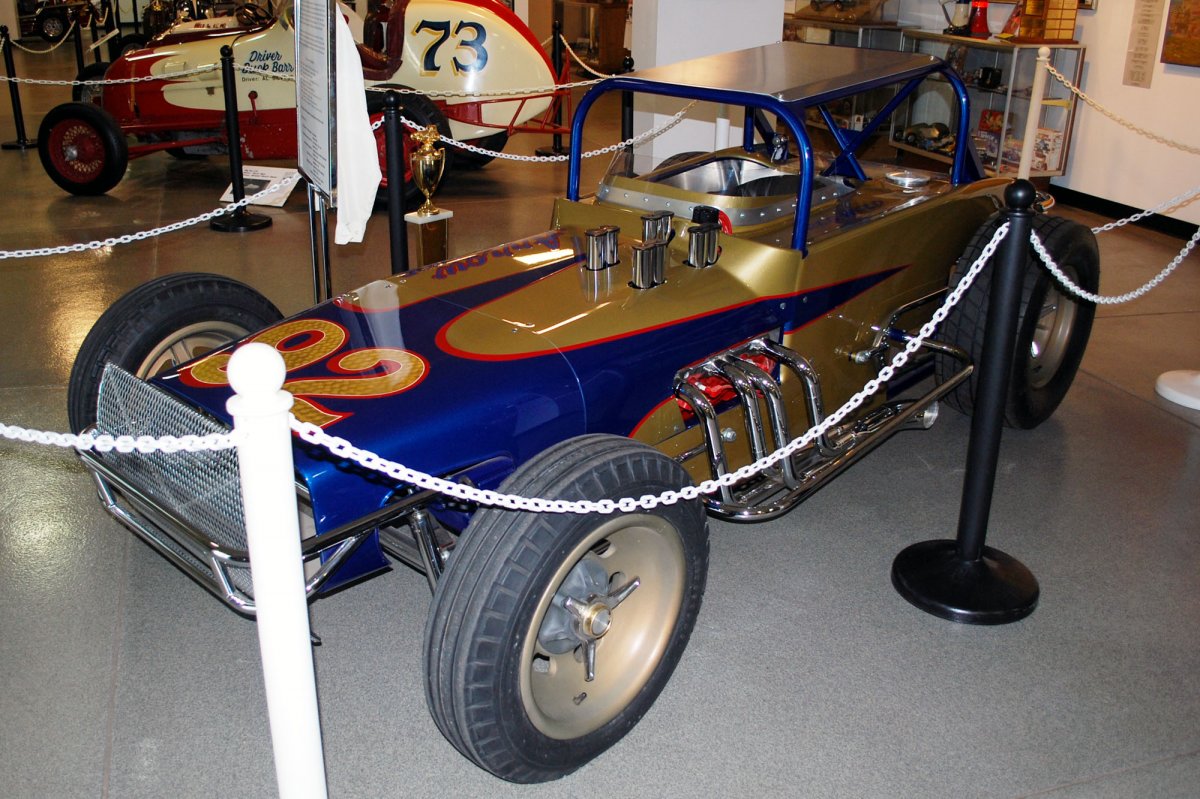

    I'm not sure if it is the same car, but a few years back I saw a similar "Weld" car with a cage (looking like a super modified versus sprinter) at the sprint car museum in Knoxville. Here is a photo, just in case it can help. And if so, it might be worth a trip to see it!!! I can't post them all now, but I can add some other pix later this afternoon if you need them. Later... added the rest of the images... sorry for the ****py composition, the car was hard to shoot with the display items. Gary

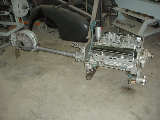

    Mocked up an engine and 301 center section to obtain dimension to do a blue print. 27 T--SPRINT HEADERS 010.JPG SPRINT CAR PARTS 009.JPG SPRINT CAR PARTS 005.JPG SPRINT CAR PARTS 007.JPG SPRINT CAR PARTS 010.JPG

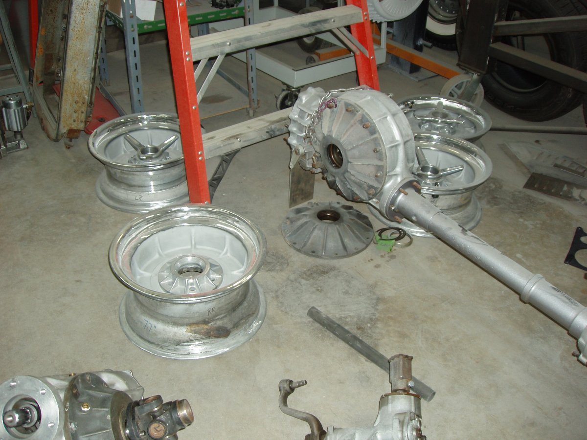

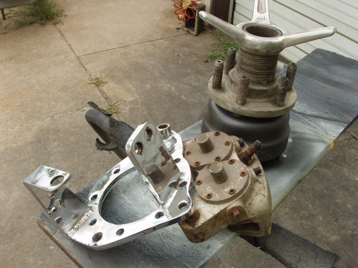

    More dumb luck. I traded the my sprint car rear end to Jay Gordon from Texas for an offset 301 rear end. Not many offset axles around. He even delivered it on a business trip up North. I really like the bird cages. The plating is still quite presentable. I couldn't clean up the magnesium so I had it bead blasted. I will paint it satin gray. I also obtained some Hurst pie crust slicks. 7" for the RF and LR. I will be using a Towel City 8" RR. Also obtained Ken's Equipment [Hawthone, CA] aluminum wheels. sun-misc 005.JPG sun-misc 004.JPG sun-misc 003.JPG Cheaper than Halibrand and won't tarnish.
