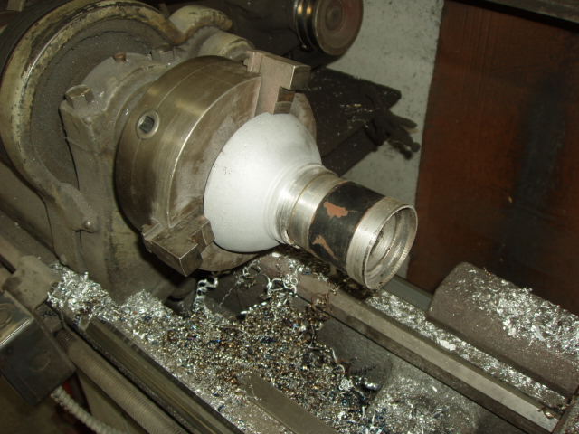

    I am building 2 other cars but did manage to totally diss- ***emble an engine that was built for racing over 30 years ago. Clean it up and put it back together. [ I used this engine picture by misstake on another thread of mine] Today I decided to use an X-Shift transmission. It was already converted for Ford torque tube drive. The sprint car bell is too small to clear the Ford U-joint. I adapted a Ford bell to the sprint car outer torque tube. I shortened the Ford tube to make room for the inner sprint car torque tube to slide back and forth. Press fits. welding tomorrow. X-SHIFT,,,45JR,,,Bud 301 004.JPG X-SHIFT,,,45JR,,,Bud 301 001.JPG X-SHIFT,,,45JR,,,Bud 301 002.JPG X-SHIFT,,,45JR,,,Bud 301 003.JPG I will be using the Ford roller bearing and seal.

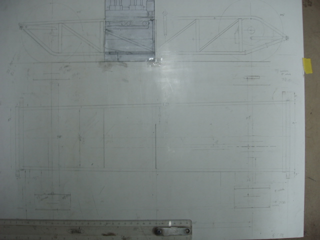

    I am getting closer to starting this build. I am working on the frame blueprint. The rails only have one bend in them. Keep it simple. The upper rail p***es over the torsion bar tubes so I can plug in the front nerf bar. The rear torsion bars and the upper frame rail line up with the bird cages that I have. The lower rails will be 3" off the track to eliminate the bent under loops. 6 PIN--BLUEPRINT 001.JPG
