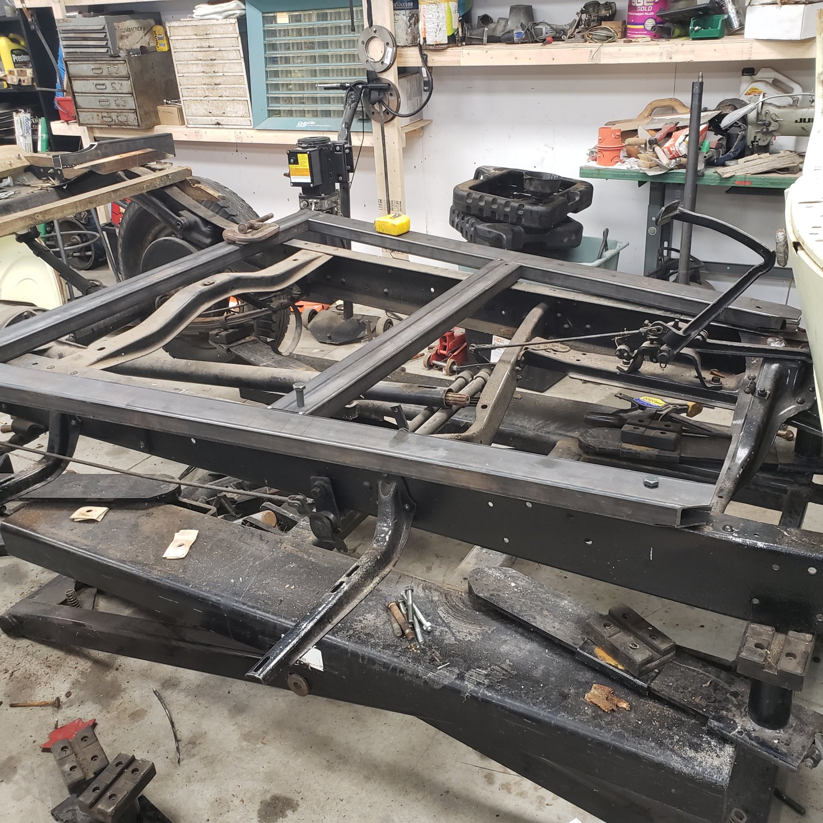

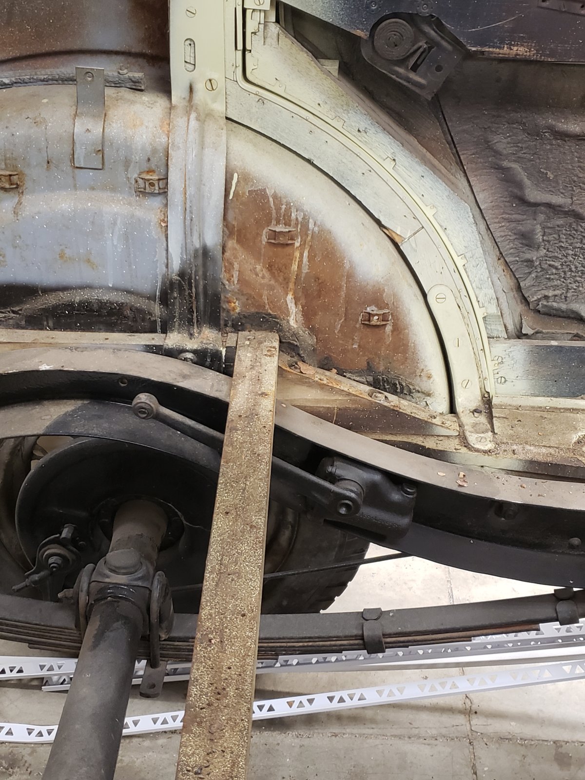

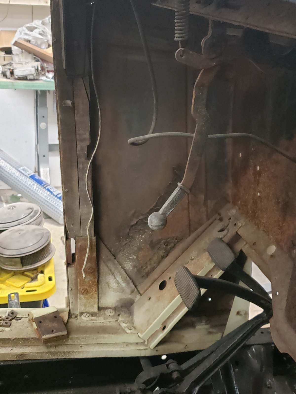

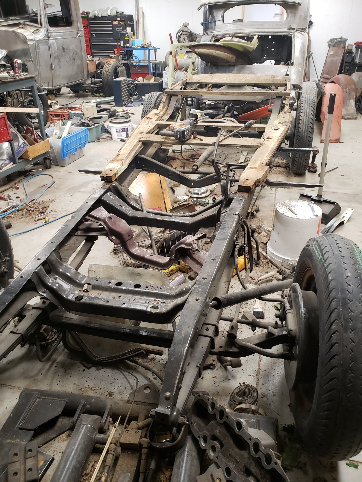

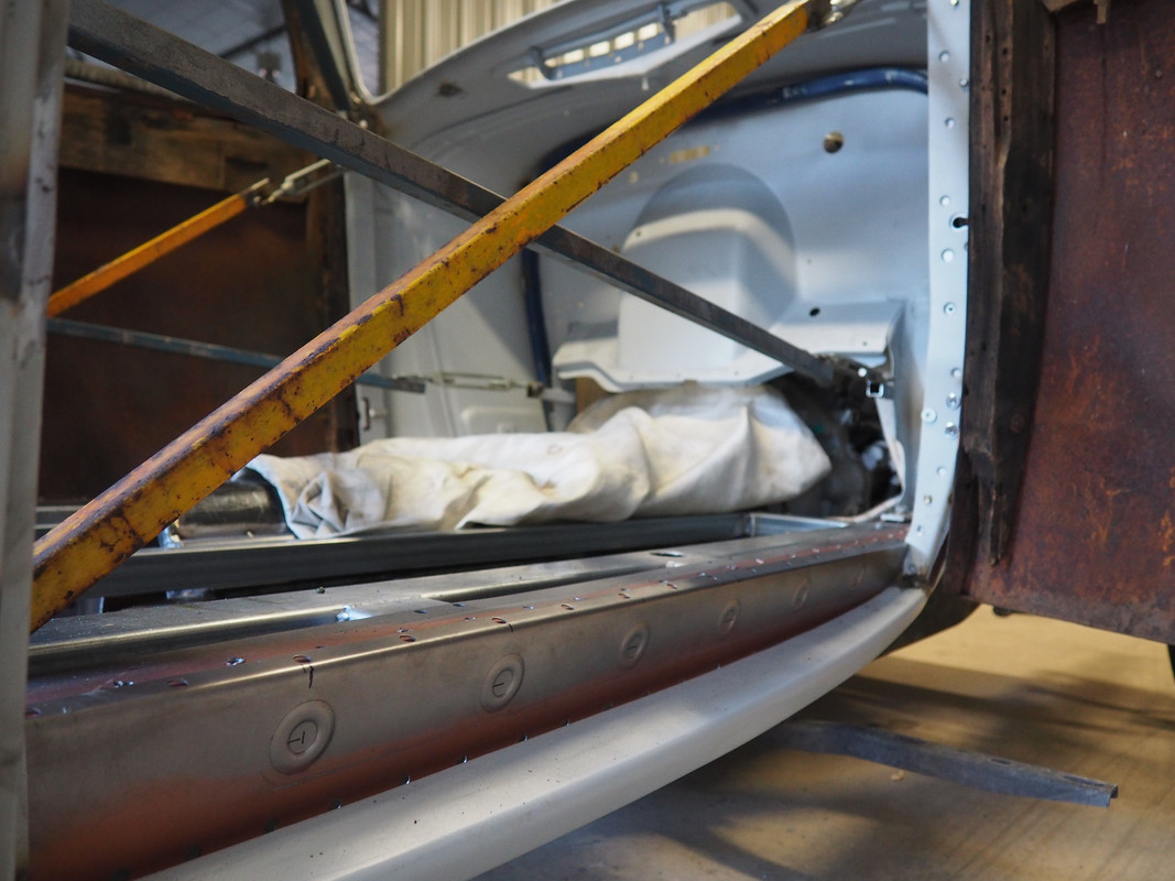

    Thanks for the replies guys, some very good tips. X38 I didn't have any pics of it on the ch***is but took these today so this is where it is at.
    Anthony the rockers were wood and I have attempted to replace them with steel. Bit of a puzzle but hopefully I'll get there and will take the advice and start by setting up the doors, unfortunately the wood in them is pretty bad as well though.

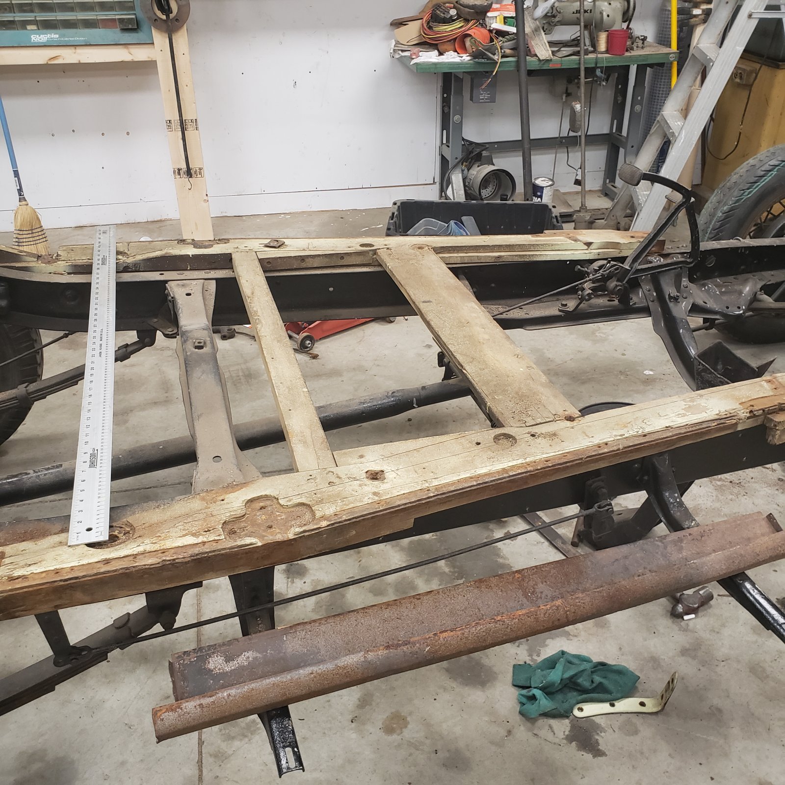

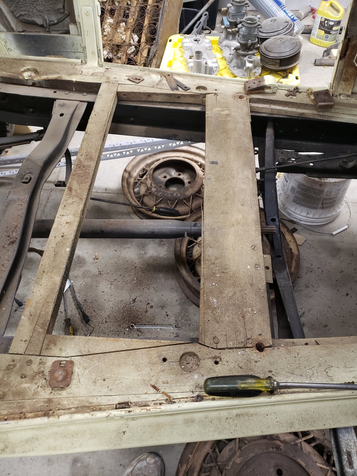

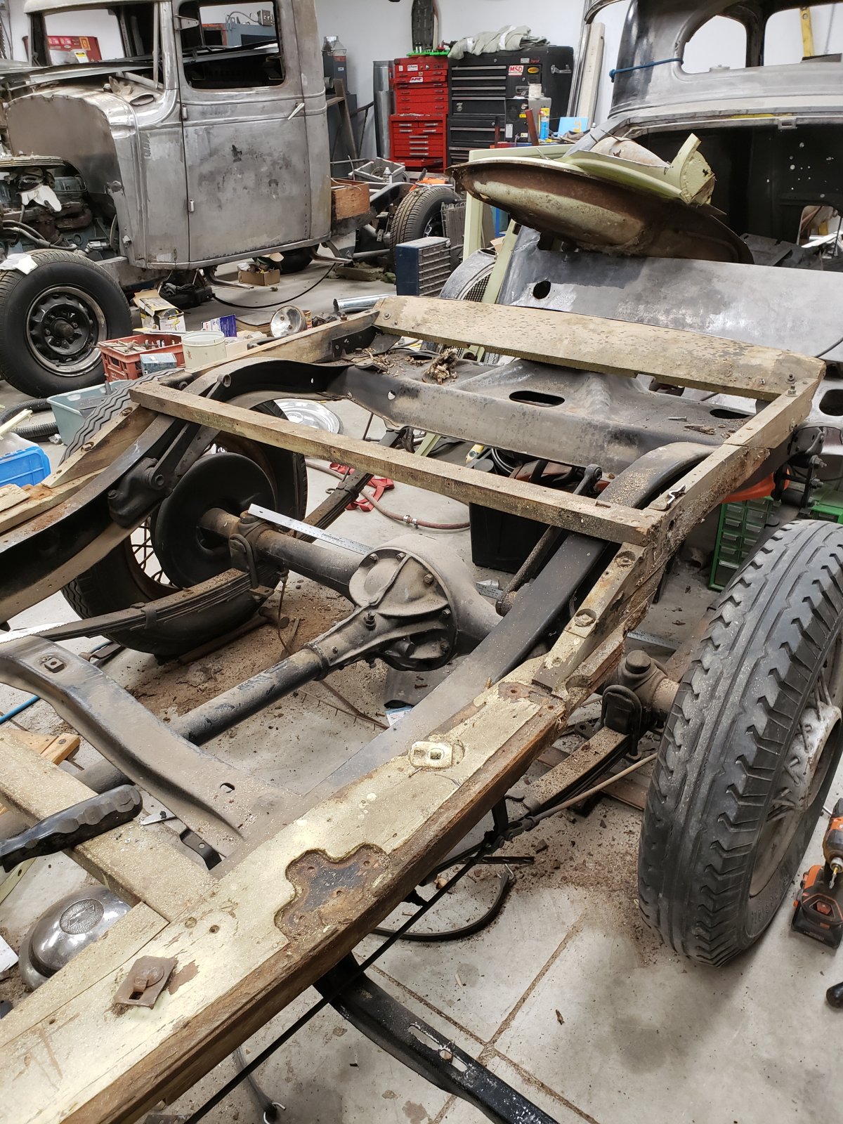

  8. Sure looks like you have pretty good handle on it!!!
    Tubing should be 1 1/2 thick for the body to sit at the right height to install fenders, hood running boards etc . Start with the cowl feet thru the tube .Do you have the rocker sills?
    I am doing a 33 master at this time ,but I ***ume the measurments would be different to your standard
    This is the original wood sub structure from the car that I reproduced in steel . 20210402_112323.jpg 20210601_212504.jpg 20210601_212517.jpg 20210630_210616.jpg 20210715_164450.jpg

    Joe, I do have the sills, they are a bit rotten but I believe that I have the height correct by the time I have used rubber and the rectangular hollow section steel. I didn't have a clue how it went through to the rear wheel arches but I'm pretty happy with my framing so far, I'll just have to build upon it and get the body all squared up before and welding. Should keep me busy for a while. Thanks for the pics of your floor.
  10. Here are some better pictures òf the rear wood ,although a sedan no difference in the structure 20210601_212517.jpg 20210402_112838.jpg 20210402_112542.jpg 20210402_112527.jpg 20210402_112452.jpg 20210402_112448.jpg

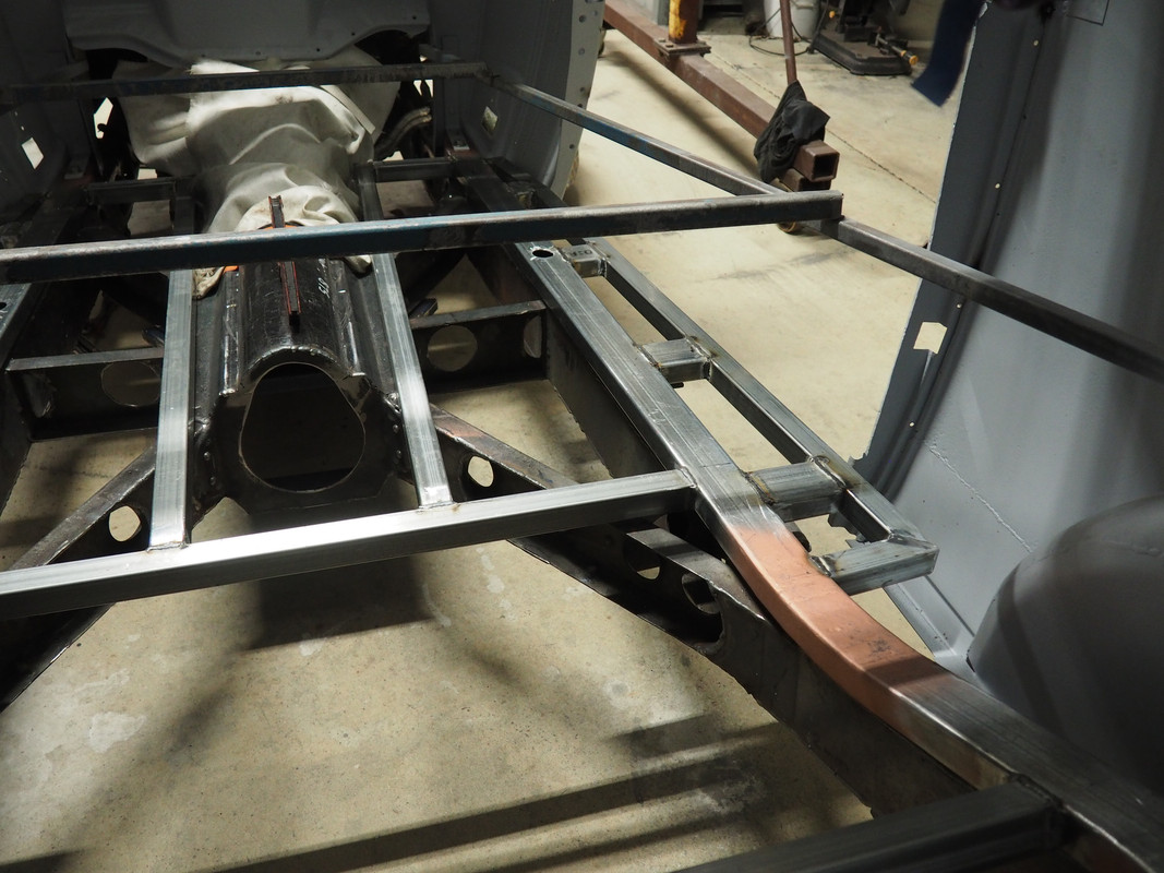

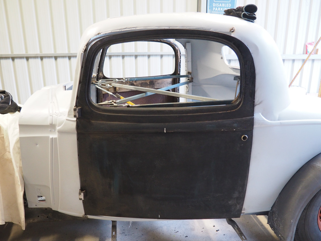

    So I must admit I have been a bit slack, watching too much of the cricket on tv but I have managed to do a little on the coupe.

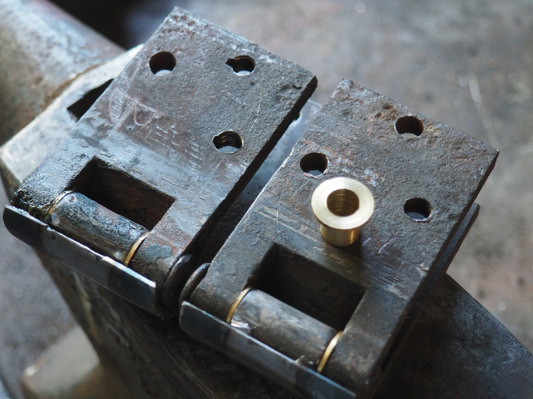

    I turned up some new bushes for my door hinges so that there is no slack or wiggle room in them as I thought this would be a good starting point.
    Made the supporting posts for the 'A' and 'B' pillars and started on a bit of the floor section and sills to help hold the body in place with tek screws while attempting to square it up.
    At this stage the doors don't look like they will ever fit but I now have some turnbuckles in place I can attempt to make some adjustments and see where I go with some tweeks here and there.

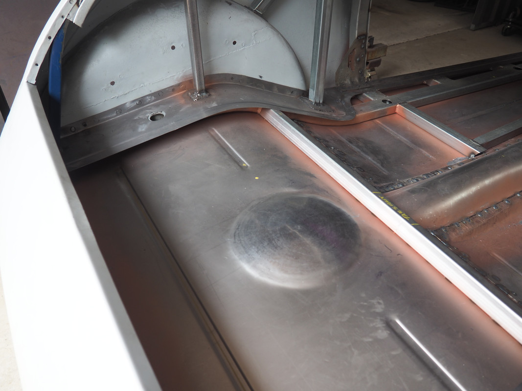

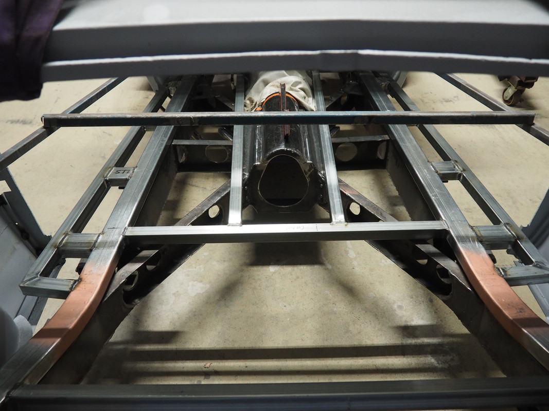

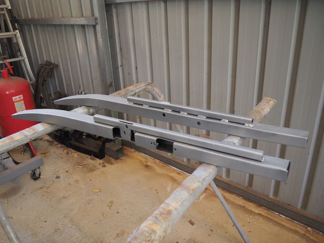

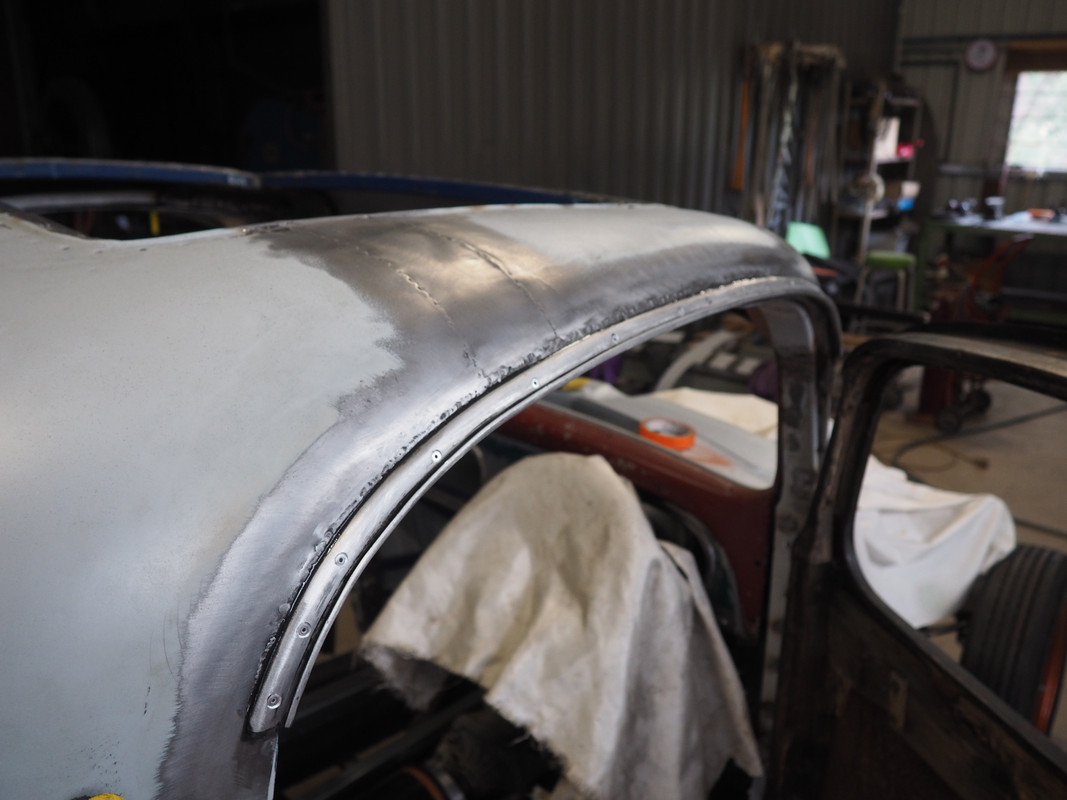

    So I did do a little bit more on my little Chevy. Got some more bracing in and some floors. Next I'll start on the doors now that I have received some bailey channel for the windows.
    Took the lead out and fit the original drip rails.
    Gonna put a glovebox in some day.
    Made some floorpans.
    Transmission tunnel can do with some improvements but I was too lazy at the time to do any shrinking.

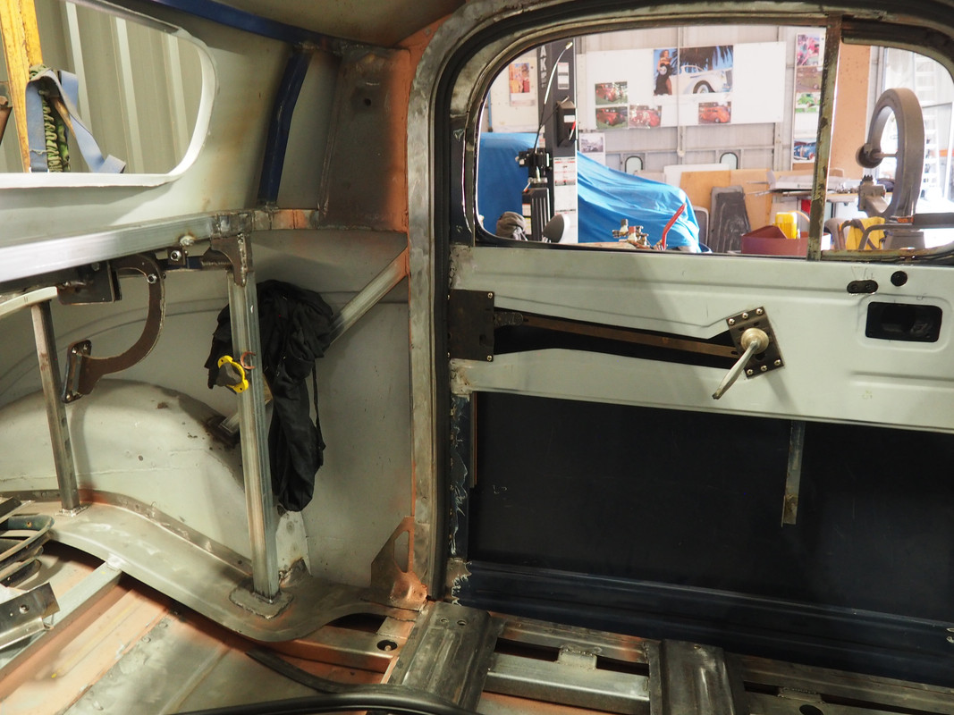

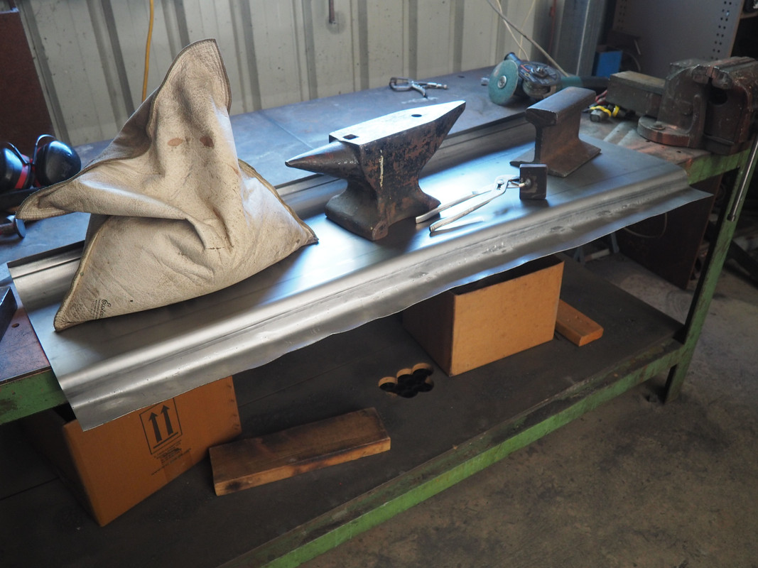

    I managed to get my doors steeled out. I decided to keep the vent windows but I have shortened them by about 80mm. I used angle iron and folded up some bits to strengthen the doors a little. Also thought it would be a good idea to put some paint inside them before welding them up.
    I also had a crack at making some running boards. They still need some work on the transition curve, brackets and reinforcing on the ends but they came out ok.

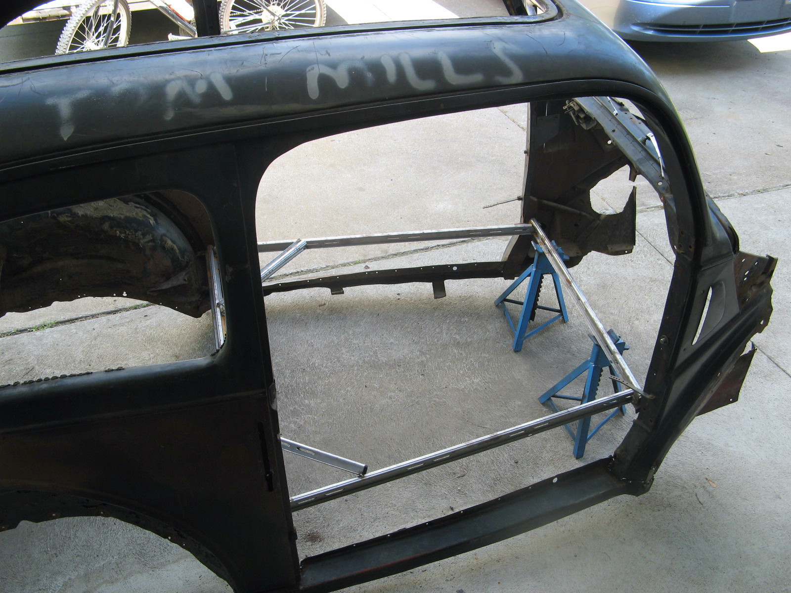

    As many have suggested, build the ch***is square, and use turnbuckles, PortaPowers, ratchet straps, etc. to get the body straight and square to fit on it using temporary struts. Measure the door openings carefully so that there is close-to-correct gaps, as recontouring the gaps and door edges is intensive work. Here's pics of an Anglia I did:

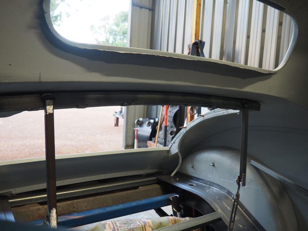

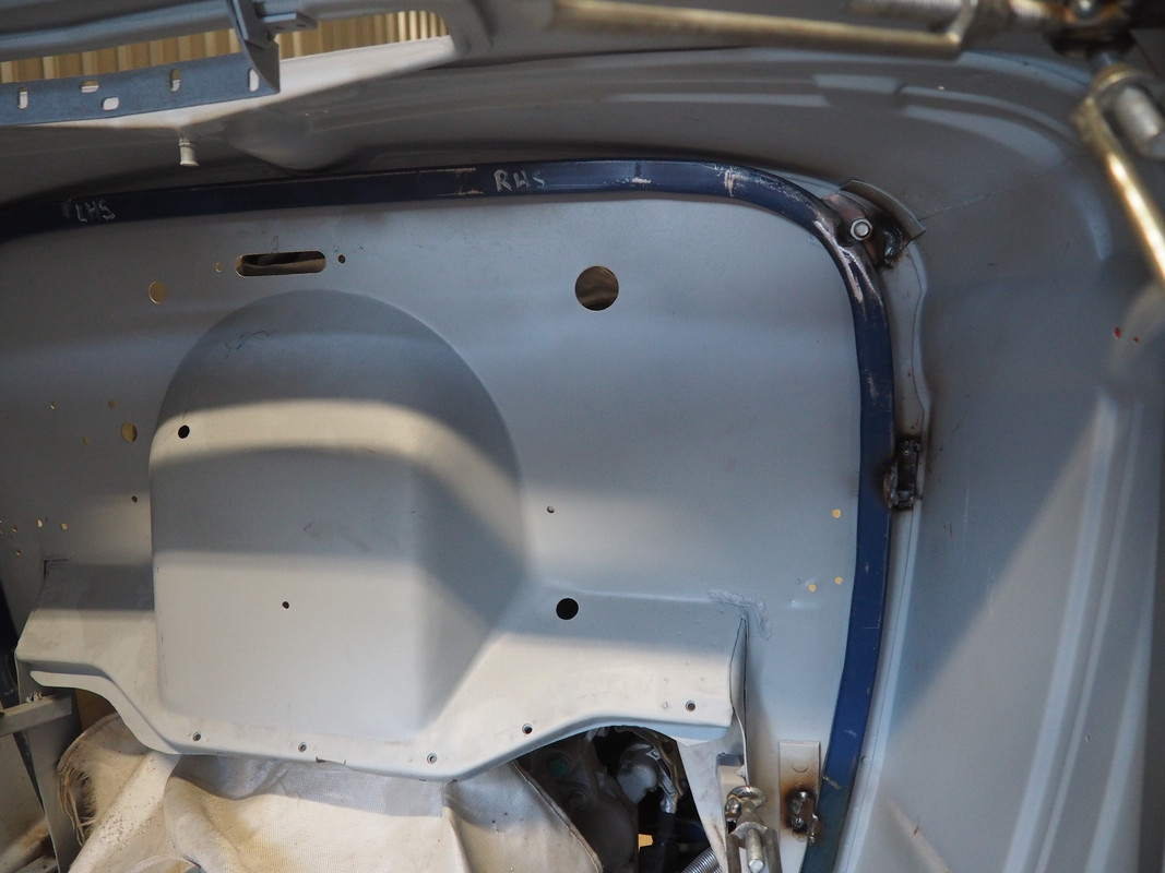

    Well I moved inside the body to do a little bit of finishing off. I made some pieces to fit pinch weld and rubber inside the car to hopefully help seal it a bit better from wind and rain.

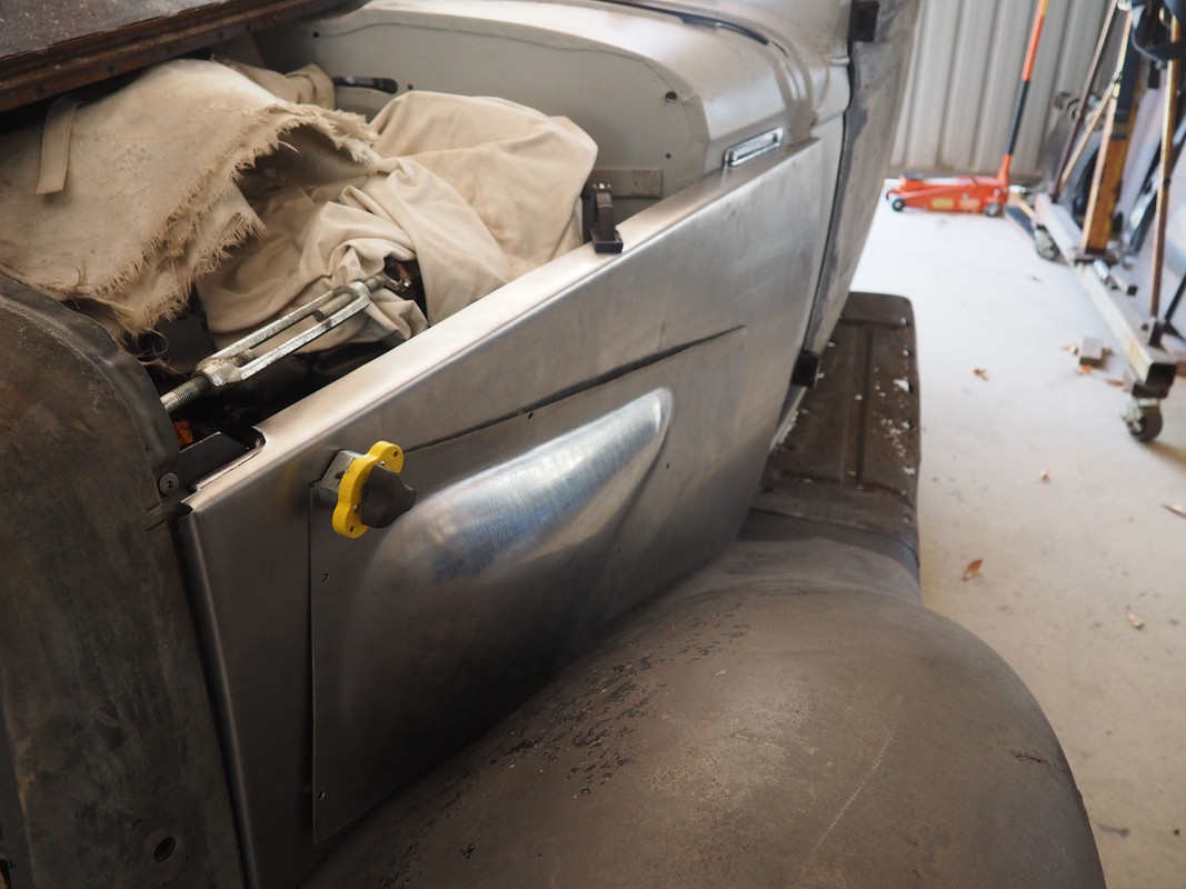

    Then I had a go at making some new hood sides and blisters.
    I thought they looked good with just the blisters but to my eyes even better with some louvers that I made.
    Just need to tidy them up a little and put a bit of strength in behind the rear louvres.

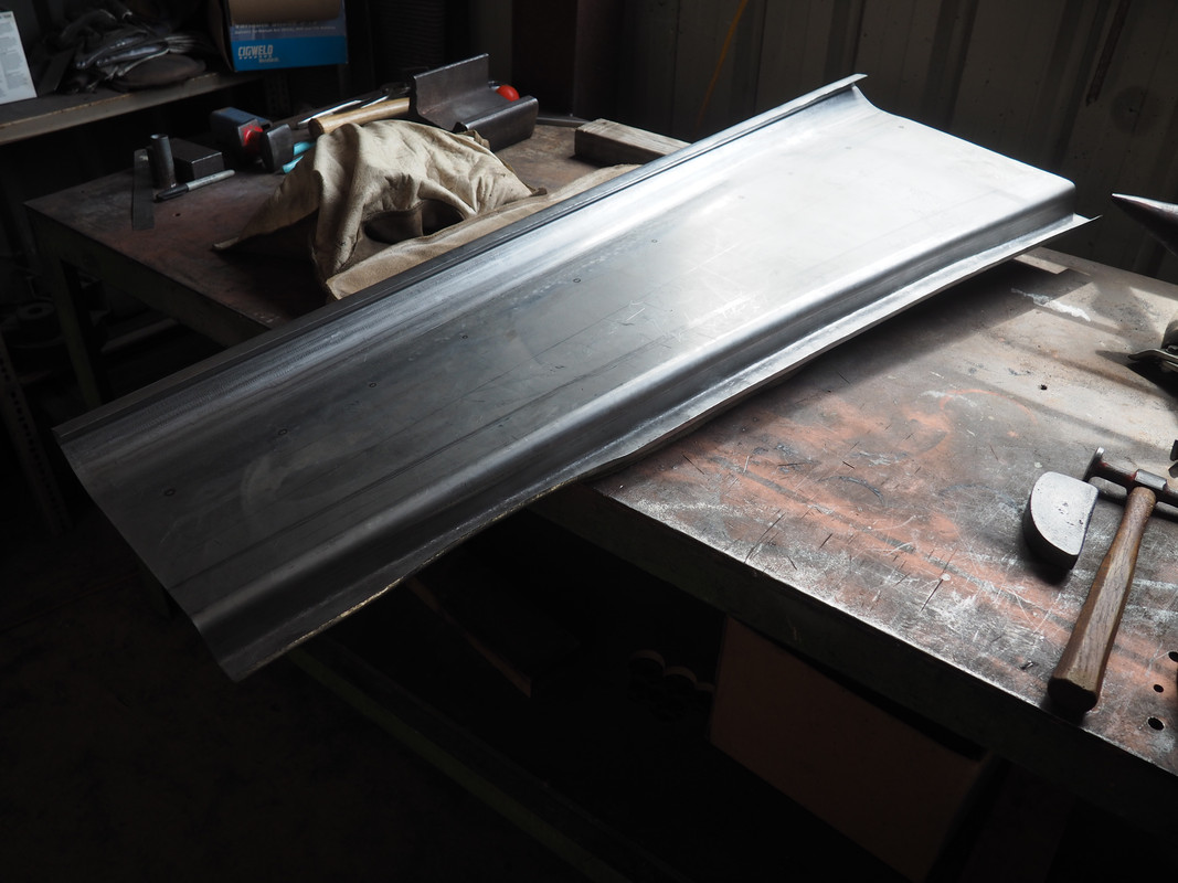

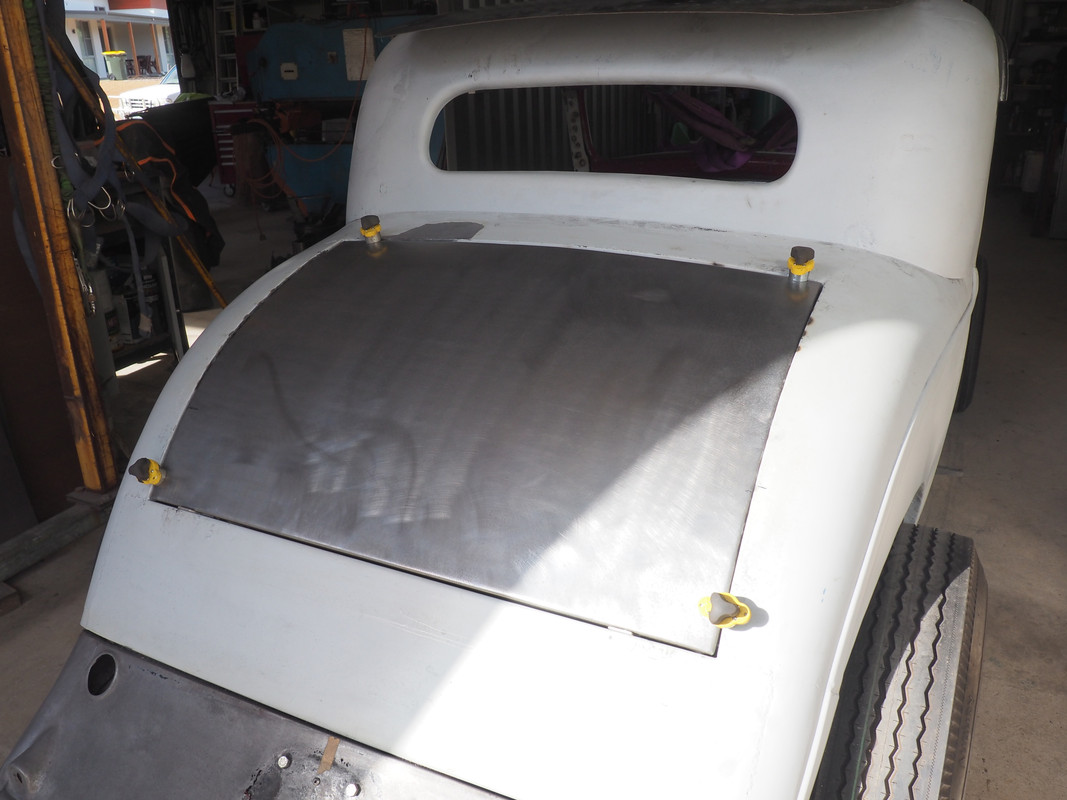

    Anyways I have had a go at making a new bootlid skin and frame for my little Chev. I still have to join the 2 together but I will wait until I have some paint protection on the inside of each before welding them up.
    In case water comes inside the louvers I will use windscreen sealant to seal the removable centre panel (not seen). I have also welded some pieces onto the inner frame to direct any water that may come inside. These will be seam sealed after primer is applied and holes will be drilled for the water to run out at the base.
    Wheeled up a new skin and marked it out for some louvers.
