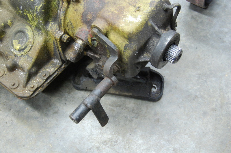

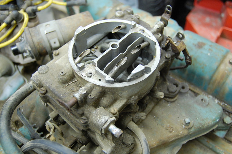

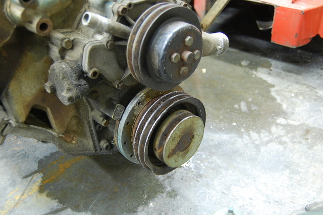

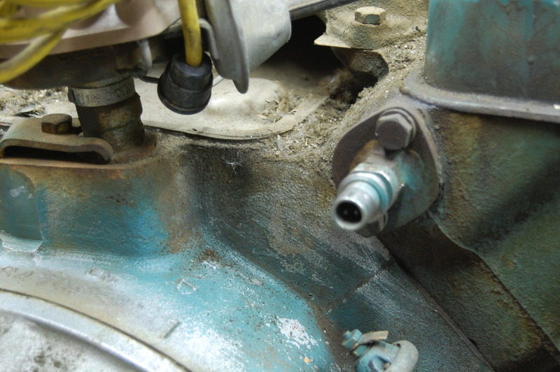

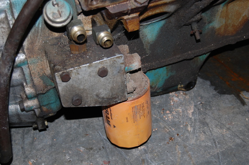

  4. Take a look at the pics and let me know what you think. The things that stand out to me... Dry sump oil system? Sensor on the back of the right cylinder head looks to be aircraft. Are the engine mounts different? Weird crankshaft pulley. The guys said it had a arm on the shifter that was locked into place so it didn't switch gears while operating. The number near the valley tray is JW787.... the number on the back near the bellhousing is B 1364704 1, off to the left of that is a larger raised block. Head has B1196914J

    JW is a '63 425 , the casting numbers support that as well.

    Good stuff! It doesn't look like a dry
    sump, but the fitting above the oil
    filter look like they were to connect
    to an external oil cooler. The additional
    front pulleys were probably to drive
    the huge, non-automotive radiator
    cooling fan used on the start-carts.
    Mart3406
  8. I thought the pan looked really small but I see all of them look that way after looking at some pics of other engines. I never thought of an oil cooler.... that must be what it is. These guys had the oil plug pulled and some bolts out of the water crossover and water pump... not sure what was up with that. They also took a huge pipe wrench to the pulley when they tried to turn it over and chewed that up. I can move the pulley by hand about 1/2 inch but that's it. Guess I'll have to wonder what the condition is until I can get it torn apart.

    I had a chance to start picking away at the engine bits. I'm removing what is believed to be a block that allows an external oil cooler to be incorporated. I removed the extra pulley on the front and found quite a well made snout / flange that attaches this to the original pulley. Holding it on were aircraft grade bolts actually lock wired in place. Also noticed the oil pan has 2 openings at the bottom that had threaded inserts braised in place to accept temp sensors I ***ume.
    I'm able to turn it by hand, let's just hope the block and heads check out ok when I go to rebuild it.

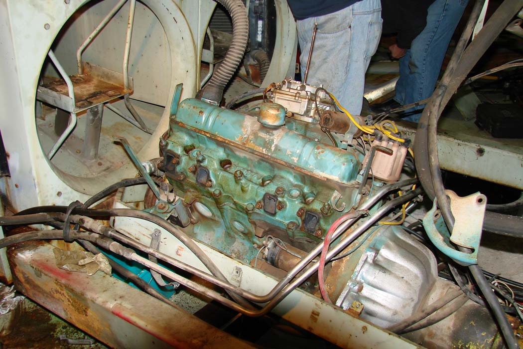

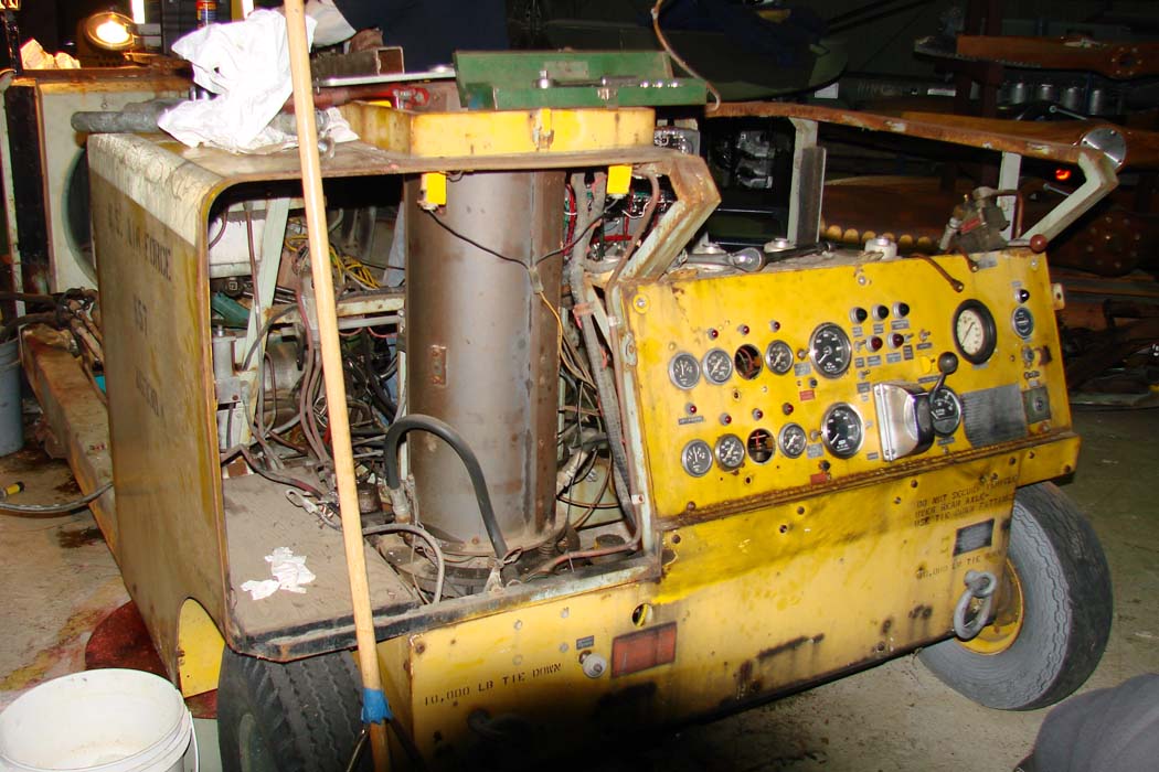

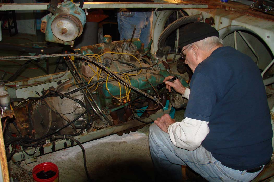

  23. The guy I dealt with in obtaining the nailheads sent me some pictures of the guys at the museum tearing the starter cart appart.
