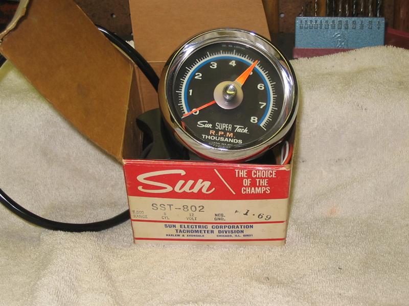

  1. I have had this SST 802 Sun Tach since the 60's, and would like to try it in my Roadster with a 8391 MSD Ready to Run Distributor.
    I've contacted the MSD Tech Department for connection help, with no success.
    Does anyone know the correct way to connect this Tach.
    Here is a scan of the original connection instructions.
    Thanks for your help.
    HemiDeuce.

    Without a box, trigger to the "-" side of the coil. With a box, trigger to the tach output.
  3. This Tach does not use a box, it is all self contained.
    I originally had this Tach connected to a points distributor, and the MSD is a magnetic pick up I believe.
    HemiDeuce.

    You don't HAVE to use a box, but some choose to. Hookup is still as I described.
