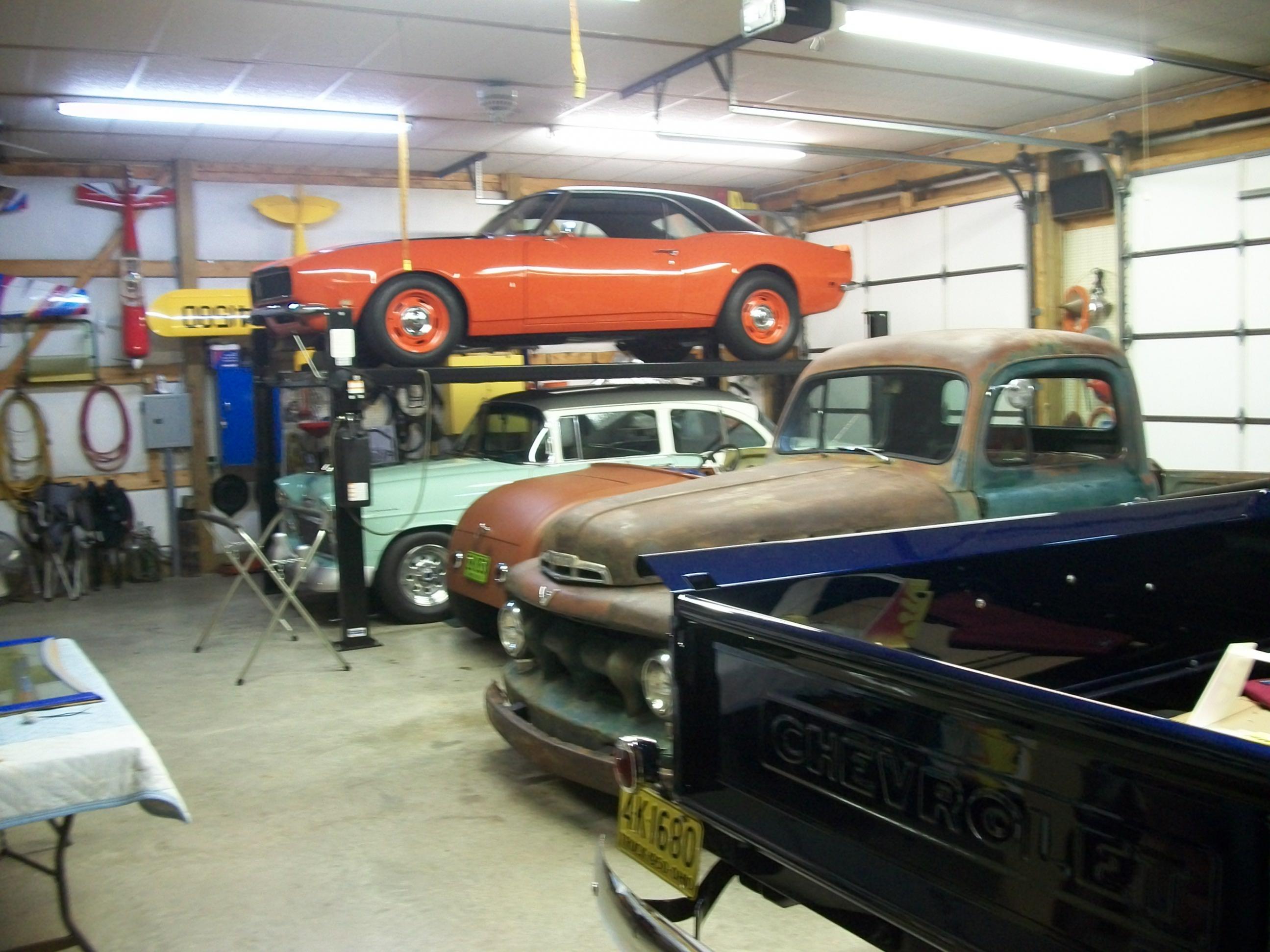

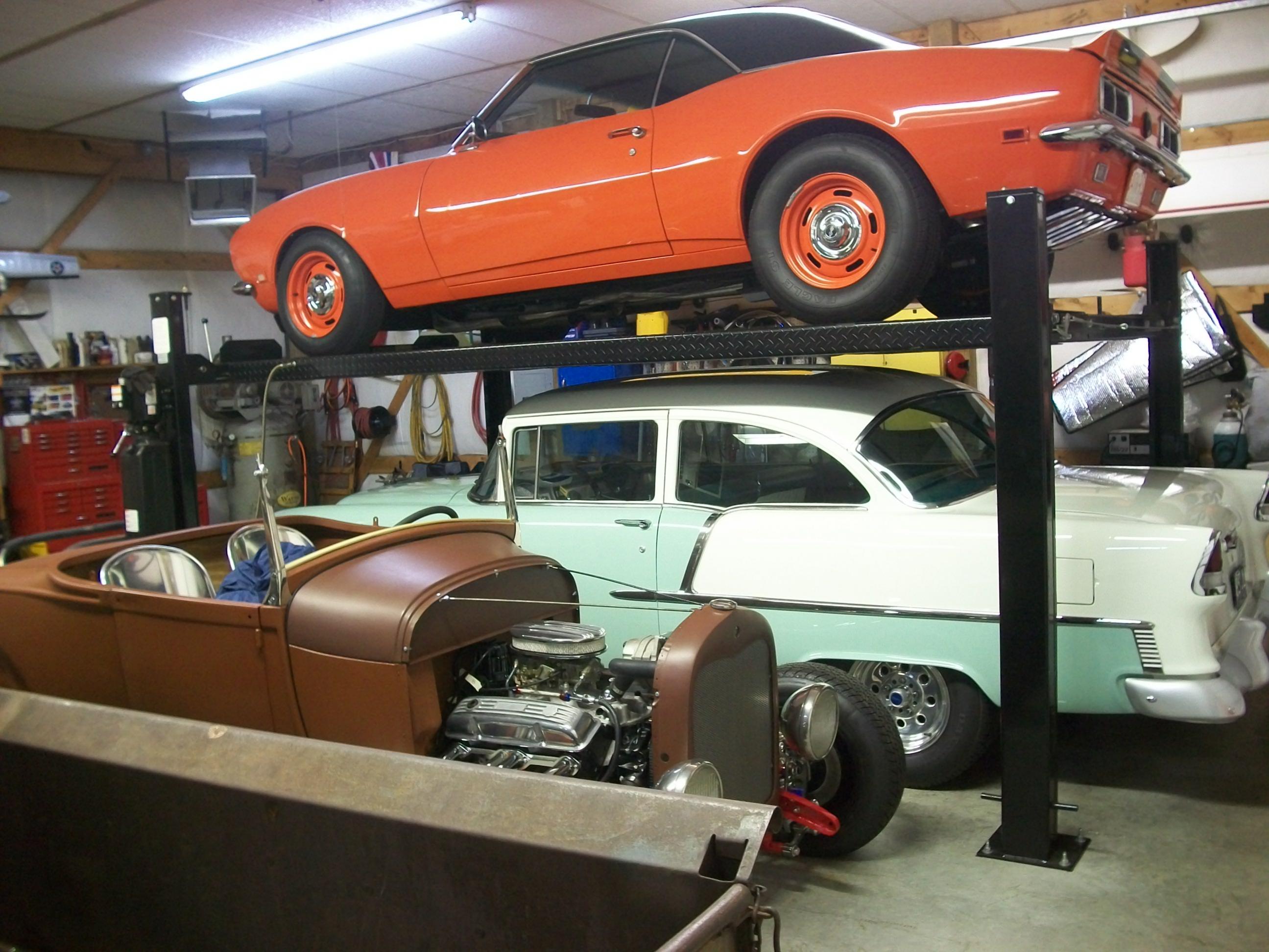

  11. i found a back yard buddy one that had a tall height version so that when totally raised it was 7' 4" under neath, 9" inside from post to post and 16' 9" long model number is 7000#overheight, so if i everget the kids college loans paid of and weddings paid for i may have this when i am 90.....i even built the garage with extra reinforced concrete for this one

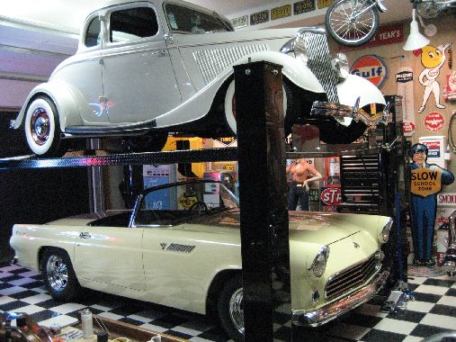

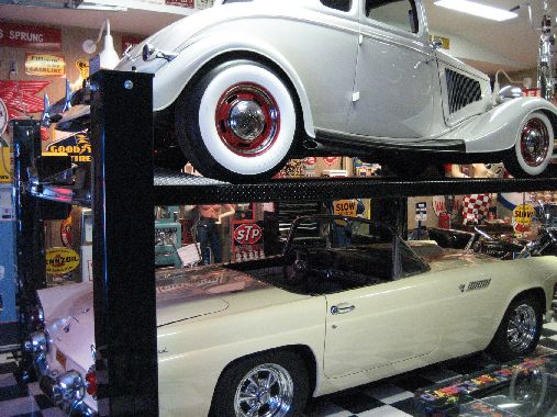

    My garage ceiling height is 11'6". This lift is from Greg Smith Equipment in Indiana. Bolt it down no matter what brand you get!
