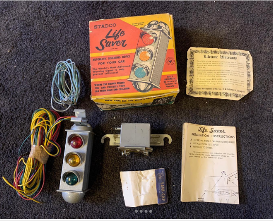

    Hi,
    Recently I bought one of these Stadco accessories, a miniature stoplight that hangs in the rear window, that indicates if you are slowing down or stopping. The light works, but I did not get the installation instructions. I see old threads on here from long ago where some folks were willing to share a copy of theirs, but I have not got a response on those links. I see where you can buy a set off eBay, but I am hoping to get a scanned copy from someone on here if possible. So, would someone help me out?
    Thanks in advance.
    Snap 2025-08-27 at 09.48.29.jpg 30dlxcoupe (Ed)

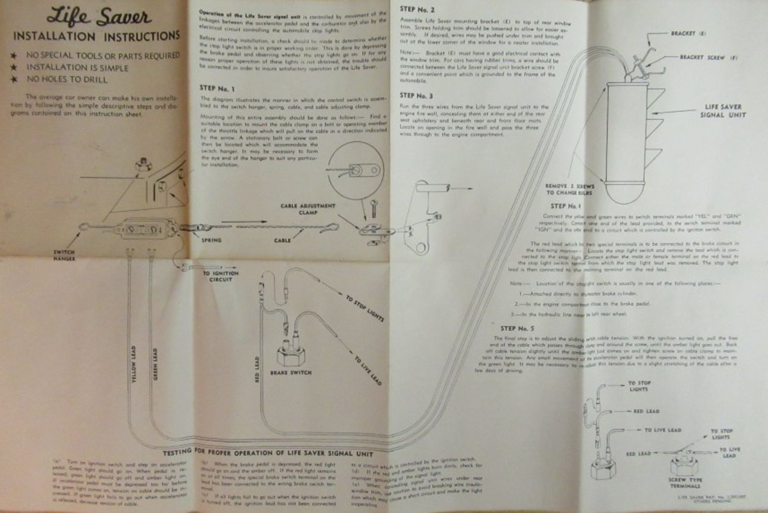

    Click on pics or save to file....then use your magnification.
    59f164e22240c_StadcoLifesaverInstructions(2)-Copy.JPG.ead7dbb07ad2f1dcf7246d91f9ec4bab.jpeg

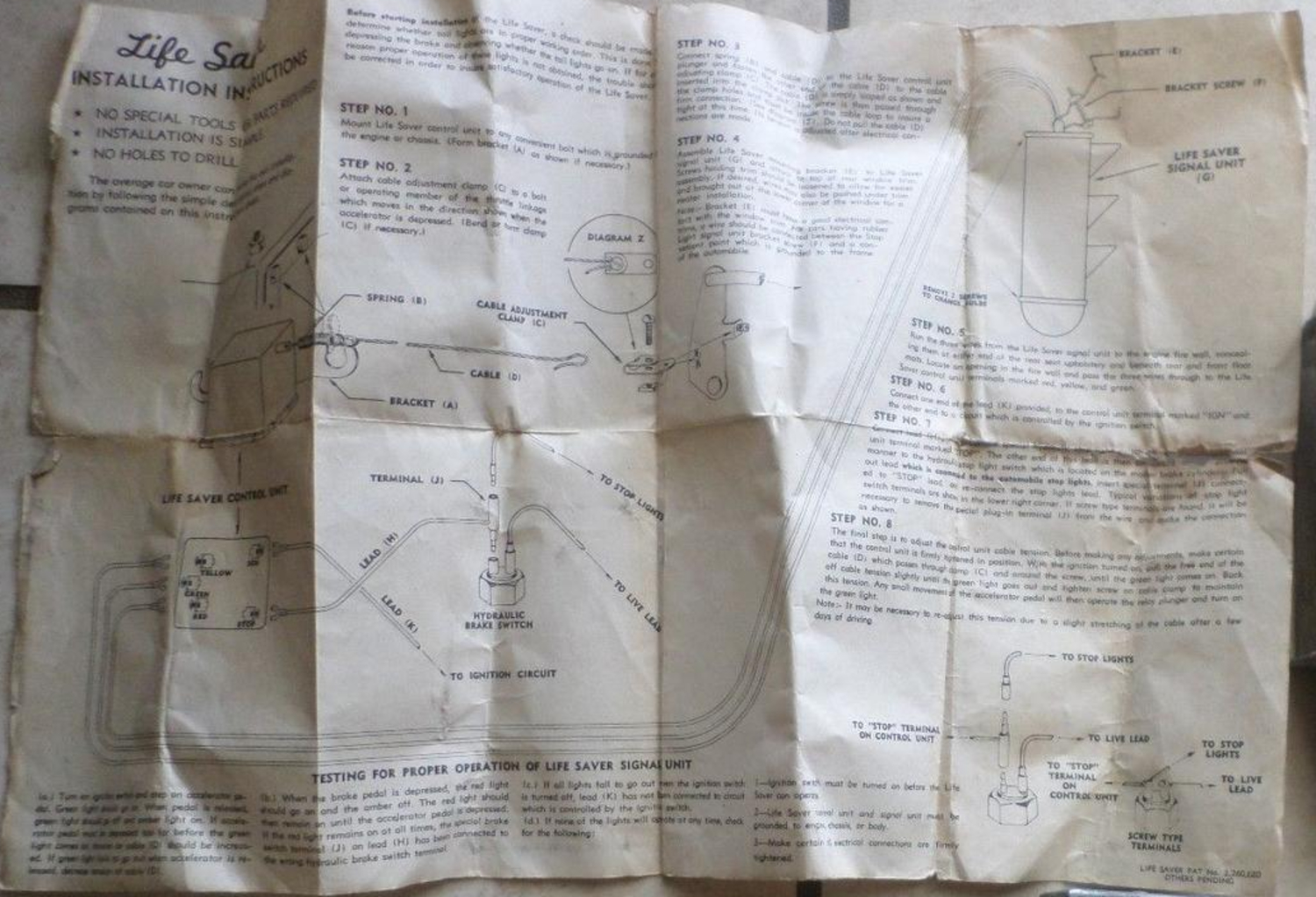

    So there is a control unit or a sliding switch that was sold with the light? Or was that an extra cost item?

    Thanks again, that makes a lot more sense. I appreciate your sharing this information.
