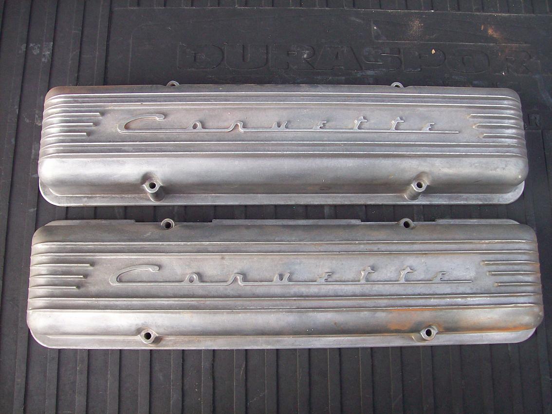

    thanks for all the suggestions guys really helped me out , sorry about the hardcore delay on replying but very rare i am on the computer and family member was very sick for a while but i still have not decided what to do yet i posted the valve covers up for trade or sale but guess no one was down so heres a pick of the covers want the same style finns and cover, do the straight hole covers have the same style cause thats what i want the most these look the best i even polished them and painted them:D

    These ones puzzled me: the 'staggered' holes do not look in line with the 'straight' ones, and I'm sure the pile of spare SBC valve cover gaskets I moved the other day had the two sets of holes together?

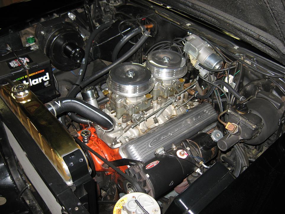

    I built a set of adapter plates for the '32 in my avatar a while back out of 1/4" X 1/2" steel strap.
    I used countersunk screws to hold the oddly spaced side of the plate to the head and used studs (welded from the bottom of the plate) to mount the valve cover to the adapter.
    The normally spaced side just gets the studs from the head thru the adapter and the valve cover. You then use a gasket on each side of the adapter and there you are.
    It took a couple of tries to get them to seal due to slight warpage from welding the strap together into a rectangle, but they have been on my truck for almost 13 years with good results. They arent that noticible if you trim away the excess gasket material.
    Why did I do it? I was given a beautiful set of early Edelbrock staggered bolt valve covers and was trying to build a "period" piece on a tight budget.
    Would I do it again? Probably not, but if I did I might try milling them out of plate instead of welding them together to keep them flat.
    On the up side, I do see a lot of people scratch their heads wondering if early camel hump heads ever came with the staggered valve cover bolt pattern? I do enjoy going that extra mile to make people think!
