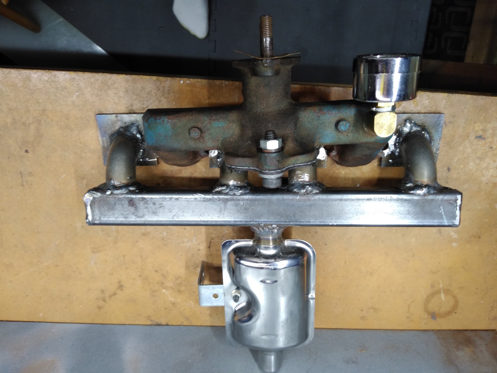

    I have welded a bunch of stainless tube elbows together with my wire and gas for mild steel. You can weld 304 to mild steel tube no problem. Just like they are the same.
    (Stainless elbows and muffler, mild steel tube & flanges)
    Only thing, the welds aren't stainless. Pipes on my OT toys will get a little rusty at the welds. The dude on TV probably was going to paint it or chrome it or, he just didn't know (or care). If you aren't worried about the stainless-ness of your welds, have at it. Mike

    If you're welding carbon steel to stainless and using stainless wire, it won't make any difference, the weld is going to rust anyway because you're contaminating the stainless with carbon. Hit a clean piece of stainless with a carbon steel hammer and where the hammer struck, the stainless will rust. Same thing with grinding wheels, if you use a grinding wheel that's been used on carbon steel on stainless, the stainless will rust.
    Just a suggestion on your welds. Make smaller p***es. Don't try to pile all that metal up on top of itself. You'll get much nicer results. I know the example is square tube but trust me, it all welds the same.

    I'm not saying it's right. I'm saying you can weld it. I don't do it for anything that matters. I have done 304 exhaust on lawn rides, they do stay stuck together. If you don't have SS wire, you can still stick stuff together. I guess I may also just figure Fantom Works was capable of such hackery, I'm not a fan. Maybe he keeps a MIG machine loaded up for SS for just such occasions.
    I didn't want to put that picture up, it was just the easiest to find. I hacked that together in a few minutes. Right after I found the big hole in the original. I needed something to start up an engine sitting since '92. It ran for an hour on that, now it is destined for the "Tree of Shame". The muffler came with the 1" flex tube (Diesel cabin heater). Gotta' admit, it is funky.
    RE convert MIG to TIG
    You put a tungsten in the tip to make a scratch start DC TIG. If you have a MIG welder, $20 and you have some TIG capability. Or, use a air cooled TIG gun to do the same thing, smaller and a few more bucks. Pretty cool. I want to try it. Mike
