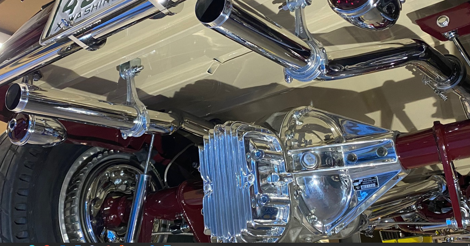

  6. THE FRENCHTOWN FLYER
    Joined: Jun 6, 2007
    Posts: 6,296
    from FRENCHTOWN
    That'sa beautiful looking car.
    Bandit Billy likes this.

  10. Mr48chev
    Joined: Dec 28, 2007
    Posts: 36,521
    Mr48chev
    That is one car you really have to see in person to know how great of a job he did on it. I took a bunch of photos of it at Hot rod Arama last summer but he had it hiding in the shade because it was so blooming hot there.
