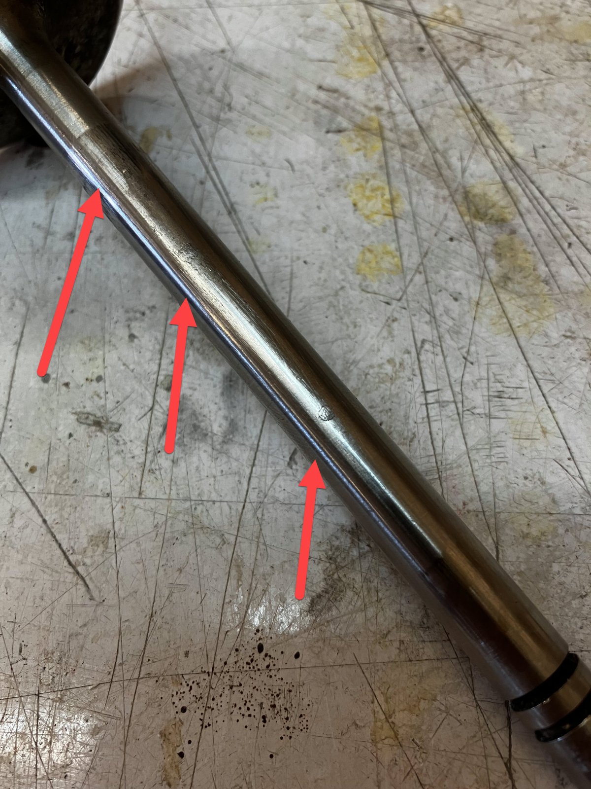

    Here is a weird one for you. I rebuilt some 354 hemi truck heads with Hot Heads iron guides and stainless valves. ***embled the engine and was setting valves (adjustable push rods) and one valve was stuck. Took it apart and found this valve had several tiny beads 'welded' to its shaft. Stuck too tight to remove, ordered a new valve and put it back together. Engine runs fine.
    I never welded around the valve and never did anything electrical around the engine before this showed up.
    vtx1800, finn and seb fontana like this.

    I hate when stuff happens that you don't have a reason for. I know both Int and Exh valves are SS to 1/3 up the stem and then become steel, or high magnetic ss. I have a habit of polishing the stems lengthways with 400, sometimes it feels like the stem grind is rough, can't hurt.

    I’d guess that’s material transfer, you can see where the material has been picked up from and then deposited.

    Looks like a stem welded Eaton valve the missed a finishing operation. TRW valve had a hardened tip welded to the ste., with the stem and head forged from a single piece.
    Eaton valves were stem welded with the head and lower part of the stem a single piece and the rest of the stem friction welded to the lower part. They didn’t have the cap welded to the tip like TRR.
    Never could qualify Eaton valves in the days of high sulfur Diesel. The stems would corrode at the weld and the valve head would drop. Other manufacturers seemed to make Eaton valves, but the cost savings of going to Eaton wasn’t worth it. Perhaps other oems had the weld higher up on the stem, out of the combustion products. Sulfuric acid is formed with high sulfur (before ulsd) fuels.
