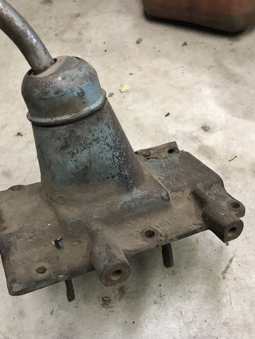

  21. The shifter top on the '32-'36 trans has mounting bosses for the parking brake ratchet, but the early style shifter top can be used on the later (78 prefix) case if you use the guts that go with the shifter. Ford sold the 78- case as a replacement part for back to '32. The 78- case was used on '37-'39 cars and '37-'50 pickups except 60 HP engine.

    The 1932 top cover is the only one that has integrally cast bosses for the emergency brake handle and ratchet assembly as seen below.
    Photo credit to @Deuce Bigalow
