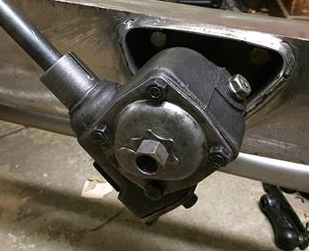

    Anyone know where I can find the star washer on an F-1 steering box that locks in the adjustment. Mine is missing. Should I be thinking about red loc***e instead???

    All the guys who say to buy one at the hardware store aren't aware that this is a very specialized washer. Not something you will find at a store. You'll either need to make one or hope John has one. The tab inside the center hole that holds the adjusting stud is very important, so Loc***e won't work.

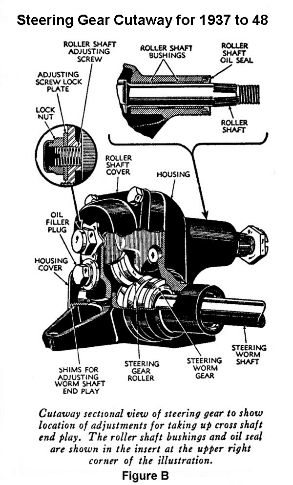

    Not the best image, but here it is. Ford called it the Adjusting Screw Lock Plate. I never had an F1 box, but I wonder if there is some dish to the lock plate (like a Belleville washer) and the concave side goes toward the cover to help retain the adjuster screw location.

    It's flat. There is a bump in the cover plate that the notches in the star fit around. That gives you six possible locations to adjust your depth stud to on each round.

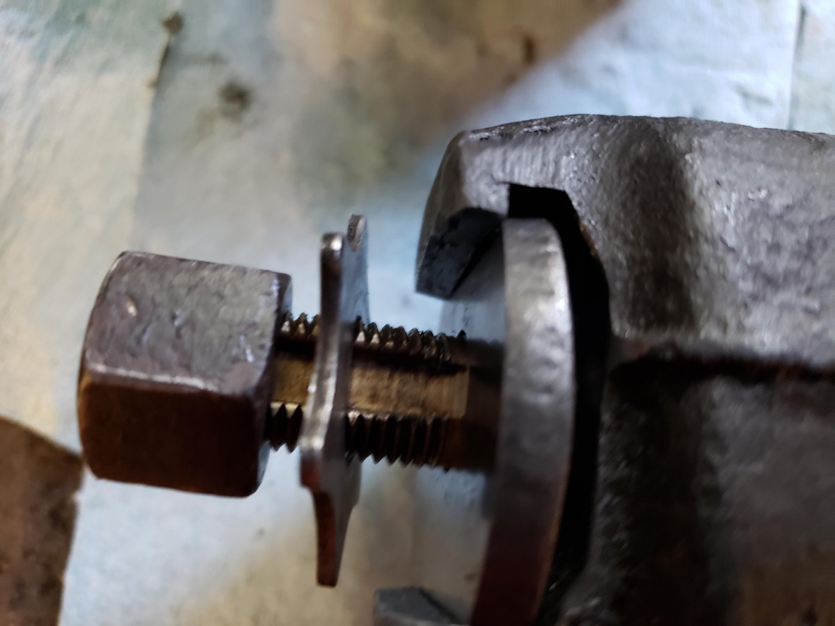

  22. Center hole has a tab that fits a slot in the adjustment screw.The outer rim has half moon cut outs.The box cover has a curved raised bump.loosen the nut.raise the star,and make your adjustment.Lower the star on the bump so one of the half moons fits it.Tighten nut.Nothing can move now.

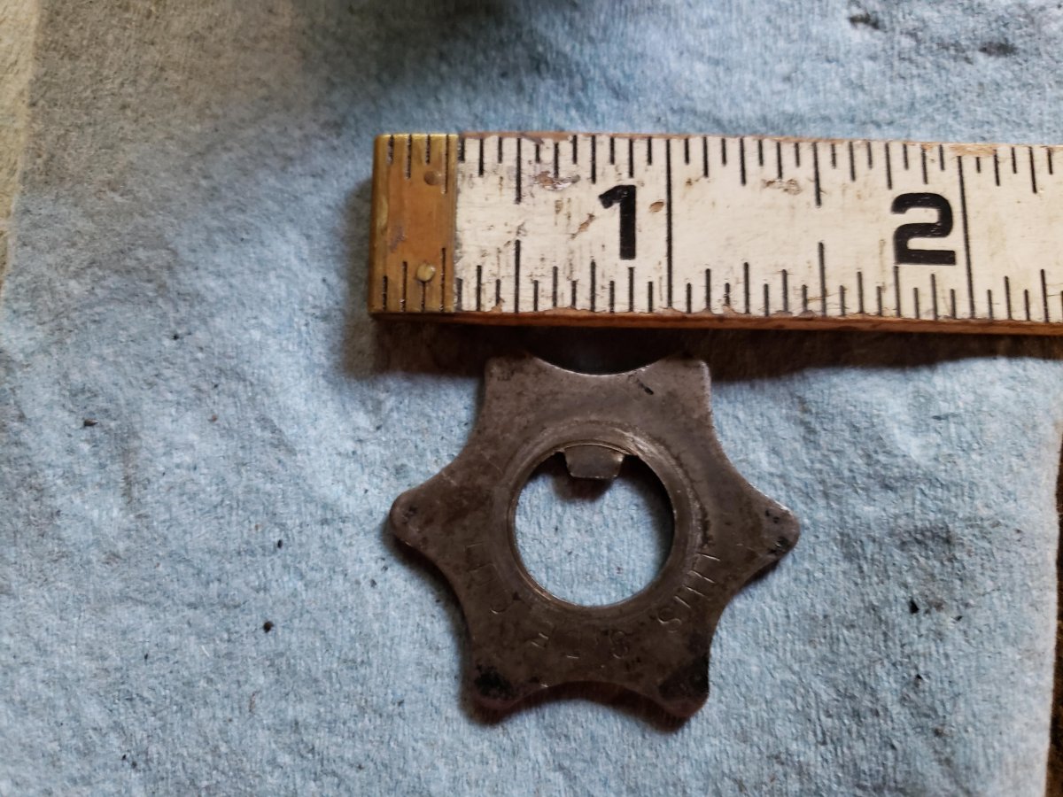

    Boneyard....I will take a pic when I am in the shop tonight and post it here for you.

    Here you go 20190923_171055(2).jpg 20190923_171055(2).jpg 20190923_170800.jpg

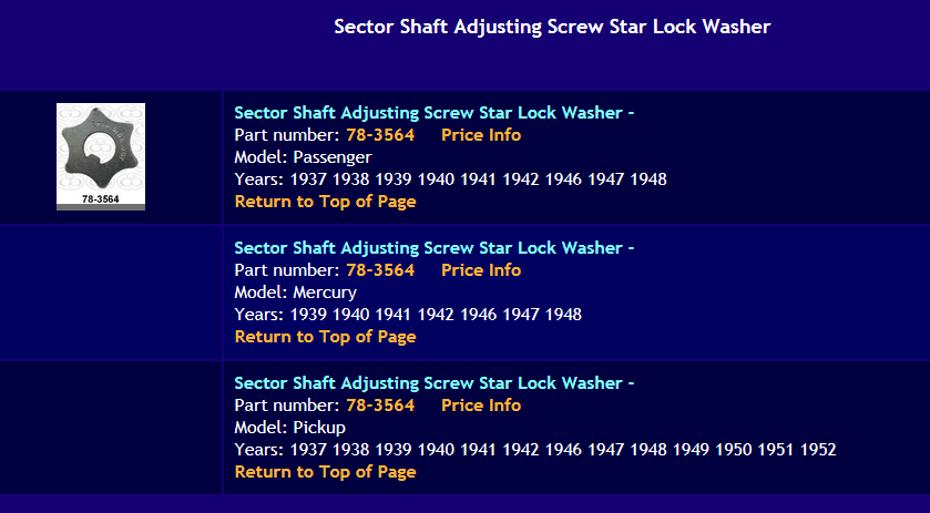

    Bad news, guys. I looked up the part on C&G's site and got this:
    "The part number 78-3564 is no longer available or it is not a valid part number.
    Call us at 760-871-0445 for ***istance, or you might try using
    a description in the search function at the top of the page."
    I didn't try phoning, however.
    Funny enough, I was going to recommend ordering one or two if you think you may ever need one, in case they sell out the run and never make another.

    Looks like I got real lucky....
