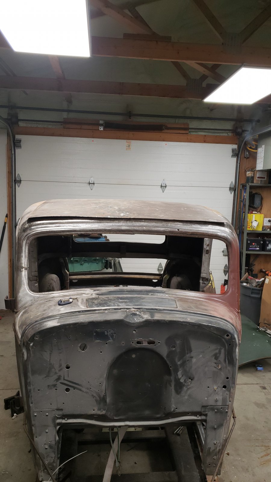

  1. This will be a slow build(hell it's been 11 years now ) This is not my first chev I have done and removed all the wood .Have always had a 33 - 36 chev in my garage 30+years now .
    The chassis under the coupe presently was somebodies attempt at a hot rod in the 70s , stick welder ,cutting torch and angle iron .
    Bought the 4 door for the restored chassis and cowl and other pieces .
    Sourced my steel yesterday to start fabbing a sub structure for the 3 window body using the wood sub structure still attached to the new frame for a pattern . 20181008_112428.jpg 20210630_210638.jpg 20210630_210610.jpg 20210630_210616.jpg 20210630_210656.jpg 20210630_210724.jpg 20210630_210820.jpg

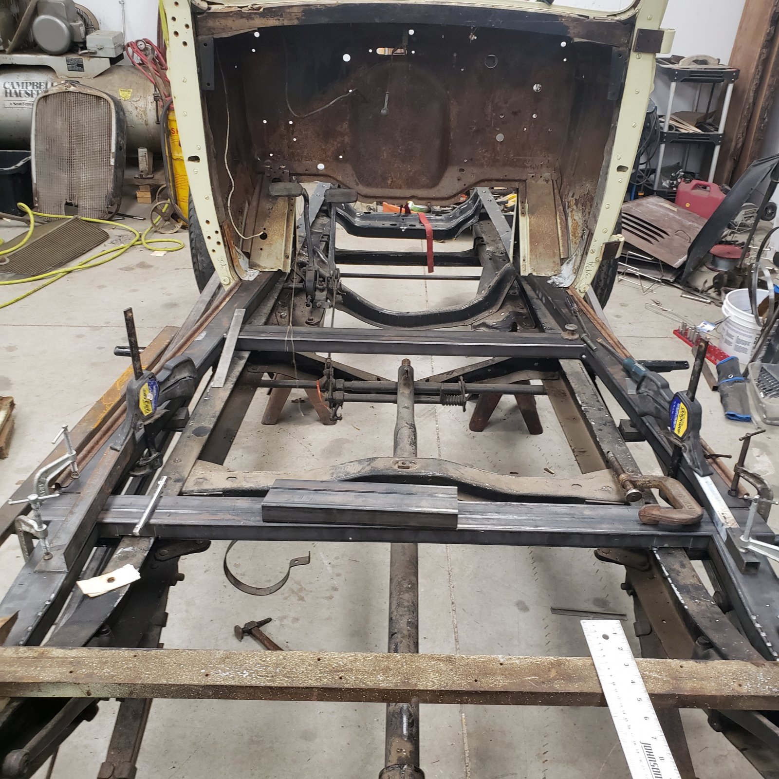

  8. Well got going on my sub frame , used the wood subframe for the pattern and mounted the cowl . 20210808_144856.jpg 20210808_144911.jpg 20210808_145036.jpg 20210808_144959.jpg 20210808_145013.jpg

  9. Placed the rockers on the subframe and tried the doors on the hinges and the fit looks good ,just a little tweaking here and there needed . 20210808_145050.jpg 20210808_162400.jpg 20210808_162354.jpg 20210808_162337.jpg
  10. Still need to fab up the rear part of the subframe to fasten the wheel wells and rear part of body , at some point I have to change the wheel wells in the body to the ones mounted on the car subframe now 20210808_145023.jpg 20210808_145234.jpg 20210808_145050.jpg

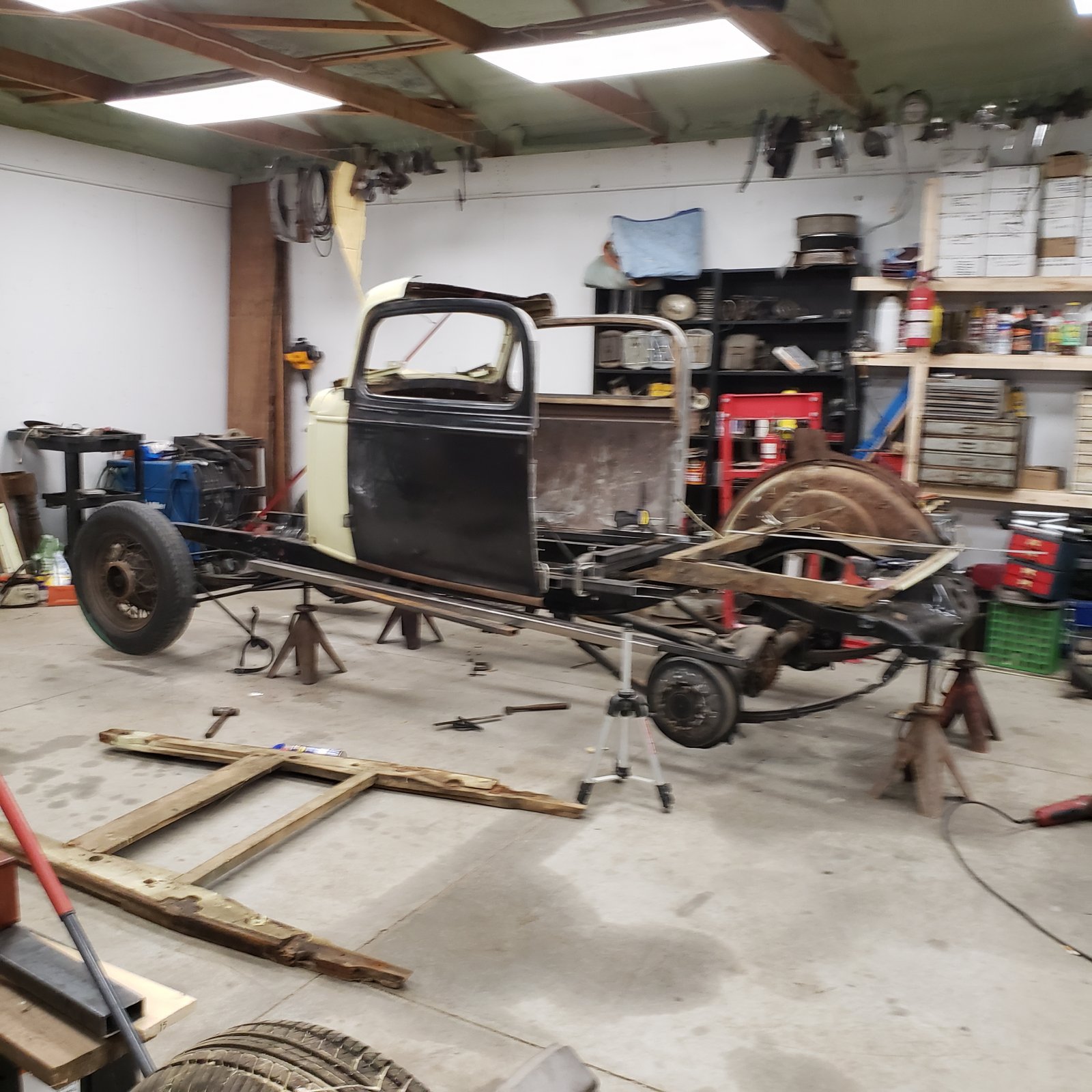

  11. She's starting to look lonely over here now 20210808_145121.jpg 20210808_145137.jpg 20210808_145145.jpg

  12. The previous owner cut the wheel wells out of the car and replaced them with what is there now , bit of a hack job ,also the 33 fenders bolt through the wheel wells and the distance is wrong
    tb33anda3rd and kidcampbell71 like this.

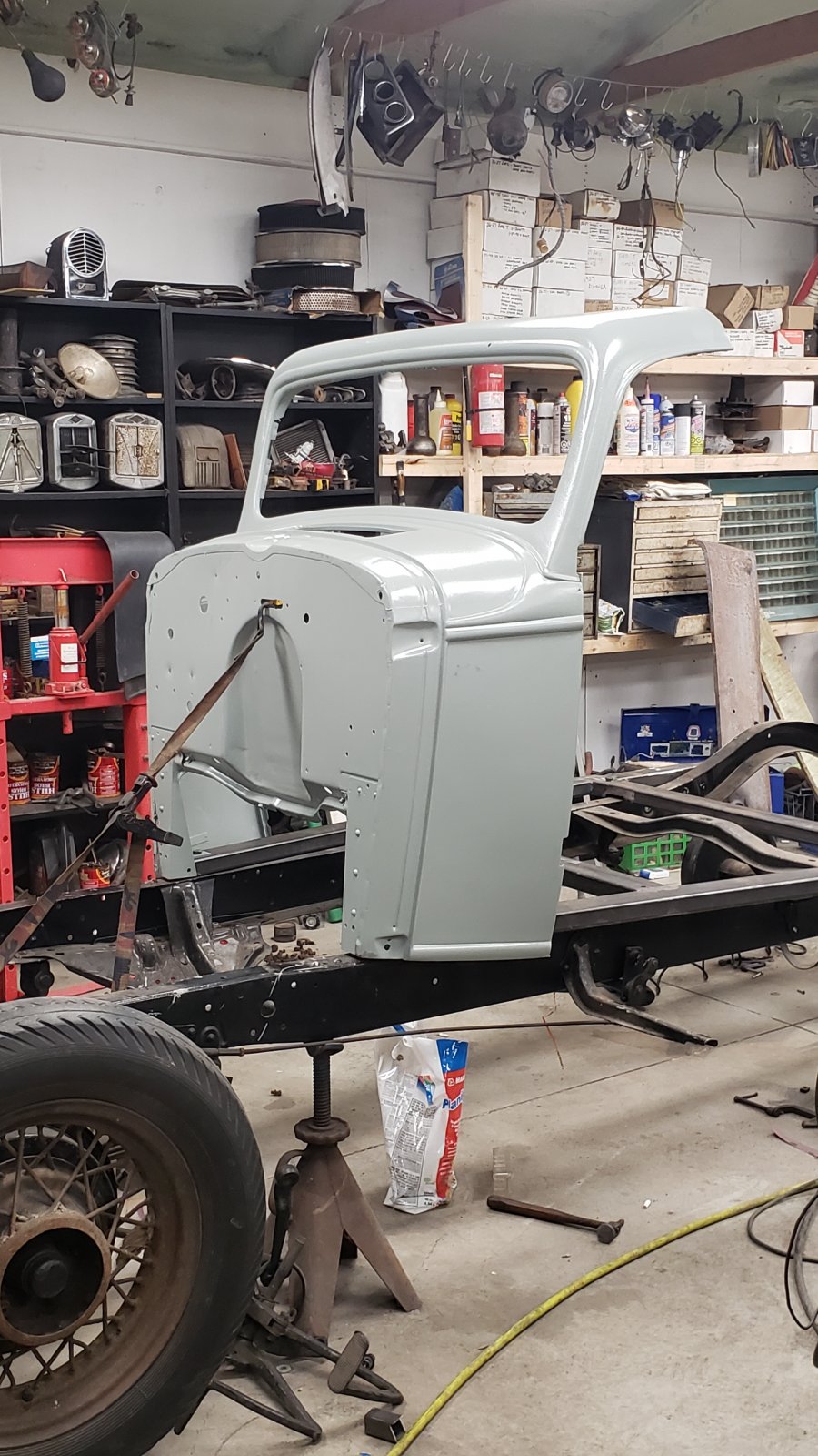

  13. Well let the games begin , sent out the parts for sandblast and prime and just received them back 20220210_131623.jpg 20220210_131610.jpg
  14. Got a few repairs on the cowl to do before I can mount it to the new sub frame , front bottom on pass. Side has come loose 20220210_131643.jpg
