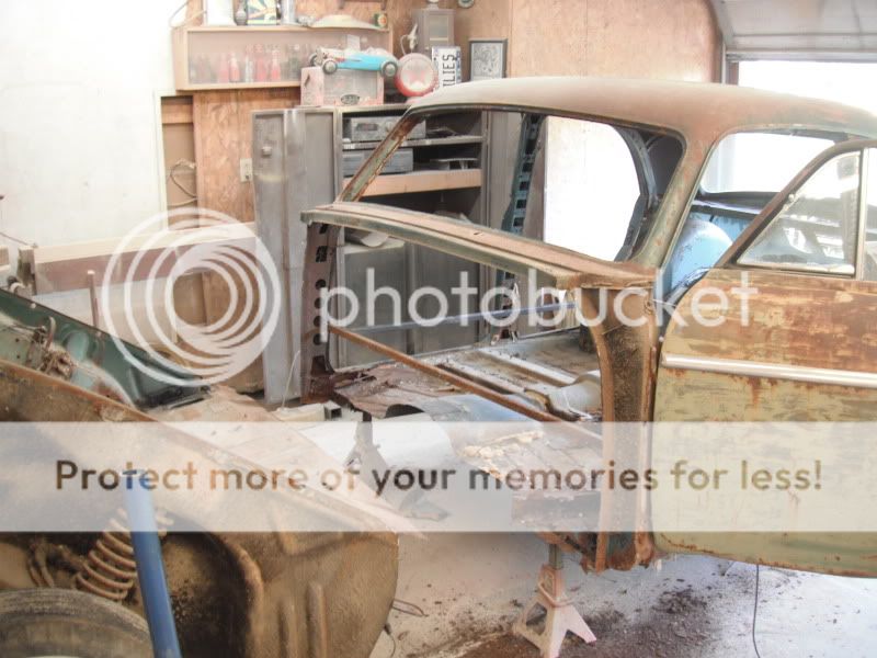

    this is the 2 door doner car i bought way up in iron wood mi ..
    then i found this more door in wi ..alot better body on it ..so im turning it in to a 2 door..
    i stoped here ..

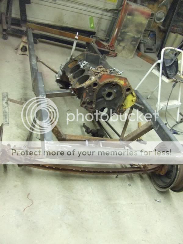

    and started on the frame .i had this 40 axle set up i wanted to use on it. i set the front wheels 6 inches forwards. and the motor 6 inches back .ill run leaf springs in the rear with a 8 inch ford ..i have a killer 396 out of a old nova g***er with a custom 3, 4bll tunnel ram intake ill be putting in this car ..
    ill post more when i get more done ..

    Cool... Whats the straight axle from?

    Not to discourage you but an 8 inch Ford wont take much abuse ,dont ask me how i know.I would start with atleast a 9 inch in front of that motor your planning to use...

    ill have to keep my eyes peeled for a 9 inch .i was trying to build it with what i had here at the house .and fab as much as possible ..i dont think the car will be on the road much but it will be doing alot of burn outs :D
    the front axle was out of a 40 ford i was told. it has a posie spring. and speed way batwings .and hairpins on it .trying to talk my friend out of a set of ansen cookie cutters for the front ..for the rear. im torn on cutten the 1/4s out and going with a big set of 30 .13.15 m/hs that i have. or a set of 29.9.15 m/hs. and not cutting the 1/4s. ill have to wait and see..

    I know what you mean about trying to build it with what you got handy.I am the same way (or atleast i will be till i win the Lotto).I just didnt know if you realized there is a major difference strength wise between an 8 and 9 inch Ford rearend .If your just gunna do burnouts then let her rip .I like what your doing with the Willys so far ,good job ,and keep us posted on you progress ...

    8 inches are not a bad choice at all, like anything it has a limit but you can do much worse for a rear end choice, and parts are available for upgrades.
    Otherwise if that 8 inch is the right width you could retain the 28 spline axles, tubes and ends, cut the housing and add a 28 spline 9 inch center. This isn't the strongest combination out there but it worked well for Ford and its great set up for a street car on budget. It is also cheaper to rebuild the 9 inch carrier than an 8, and you could move up to stronger axles later on if need be.

    p*** side is on
    i cut the 1/4 panels off for 2 reasons one. i want to have it media blasted. and i want to get it all clean in there. and 2 i want to get rid of this lead seam filler .
    crusty
