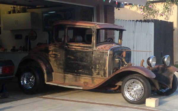

    Been measuring to get an idea where the build will go and hit a minor bump. It's a '31 coupe (body and frame), full-fendered that'll run bigs and littles with front discs. The front will get a 4" drop I-beam axle, but I've seen 46 & 48" width axles available. Fenderless it wouldn't be as big of an issue, but I don't want the tires too far outboard in the fenders. I haven't seen much difference in backspacing on 15x6 wheels and I know that will be a factor (as well as the discs to an extent), but which width axle seems to fit best on full fendered A's?
  2. This is a 46" 4 inch dropped Super Bell from Posies with a super slide spring with the second leaf from the top removed. When I ordered the front end he asked if it was hi-boy or full fendered. When I said fenders he said 46". He was right on. 15X5 inch wheels w/standard backspace and GM disc brakes. 29 Roadster.

    The reason 46 inchers ever came about was for the purpose of tucking the tires under the fenders when you drop the car down low. That is what you want.
    Don
  4. Mr48chev
    Joined: Dec 28, 2007
    Posts: 36,065
    Mr48chev
    So, a 47 inch axle with 16 inch 35 wires on drums is going to move the wheels out too far?
    Or will drums keep things inside the magic box?
  5. HOTRODPRIMER
    Joined: Jan 3, 2003
    Posts: 65,032
    HOTRODPRIMER
    The 46" is what I used,,keeps the tires tucked in with room to turn wthout excessive scrubbing. HRP
  6. Mr T body
    Joined: Nov 2, 2005
    Posts: 2,227
    Mr T body
    Alliance Vendor
    from BHC AZ
    I saved a pic of your car previously. Exactly the stance I'm after. Perfect.

    One more piece of the puzzle came in today.... Cragar 45 spoke 15X6 chrome wires for the front. I'm kind of channeling a Lil John feel for this car with big and little chrome wires with a fair amount of rubber rake.

    New front axle will be on the way soon. Vintage Parts forged 4" drop I beam with the usual metric calipers. The wires have a 2-3/4" back spacing, so we'll see how well they clear when it's ***embled. The plan is to put a set of vintage Hurst/Airheart calipers later on.

    I received the axle kit and have been trying to ***emble it for a week and a half. Came to a screeching halt when I tried to bolt the calipers to the caliper brackets. The holes were drilled and tapped with the wrong spacing, so I contacted the vendor, sent a pic showing the issue. Their "tech" dept confirmed it was drilled wrong and would send out another set. I asked that the replacements be inspected as I don't need 2 sets of defective brackets. Well, guess what..... I received the replacements and they are the same. With these being production pieces, it's likely ALL their stock is wrong, so instead of this dragging out while they figure out what went wrong, I'll be returning it for a refund.
    I'm looking at the Lucky 7 axle kit, but have only read limited responses. Anyone install one? Issues, remarks?

    Finally got the front axle on and rolled her out. Now I can get a better idea of the stance and take measurements for the 9". Gonna need taller rear tires, and gotta get the tail lower.

    I've determined that beer makes me spend more money on the car. Last night I had a couple beers and decided to dig into what needs to be done to hang a 9" under the rear. After measuring numerous times I found that I will have to narrow the rear no matter which width I find as I need one 53" wide. That also means running a buggy spring goes out the window, so plan B looks like coilovers and radius rods or ladder bars. I really have no problem with any of this and I'm glad I had this revelation BEFORE I started buying parts.
    Friggin' beer.....
  18. 31Apickup
    Joined: Nov 8, 2005
    Posts: 3,656
    31Apickup
    A Ford Maverick 8" is a perfect fit for a full fendered Model A. It is 55" from outside of drum.

    Unfortunately, even a 55" wide rear won't do what I want. With the offset the rears have, I'm looking at narrowing a rear to 52". I'll know exactly what width when the old rear is removed, but that won't happen (so I can still roll it) until I find an early rounded 9".

    It is way more cost effective to change the rear wheels ... than narrow a rear down a rear axle to 52 inches. :) The most narrow 9 inch is a 57/58/59 Ford rear end ... or a 77-81 Ford Granda. They measure @ 58 inches. A Maverick ( a 8 inch series rear :rolleyes: ) is 56 inches. They are NO 52 inch wide decent rear ends.
    I have a Bronco 9 inch in the rear and a 48 inch wide axle in the front.
    There is a 48 inch axle under the 3W also. But I do have a narrowed down to 56 inches 9 inch in the rear.

    I guess it has always been a problem to me what does one mean by saying a 52 inch wide diff.
    Some folks talk about flange to flange and others talk about drum to drum measurements (there maybe others that I am unaware of) the proviso seems to get left off in the discussion as the person proposing the measurement knows in their mind what they mean but yet others generally need to take a guess at it...

    I could go with rear spokes with more back spacing, but it isn't the look I want. Reverse rear spokes will make the look, so though it may not be cost effective, a narrowed rear it is.
    Long term, this isn't about budget, it's a car I've had in my mind for decades. If it takes longer and costs more to make it just right, that's OK. It's about getting my hands dirty and learning new skills. You know, therapy.
    The 52" width is WMS to WMS. I won't know the actual width until the banjo is pulled and I measure with the wheels in position.

  24. 52 inches wheel mounting surface to WMS? seams very narrow.... what are you using for rear wheels?
  25. Mr T body
    Joined: Nov 2, 2005
    Posts: 2,227
    Mr T body
    Alliance Vendor
    from BHC AZ
    15x8.5 reverse Truspokes with a 3.5" backspacing.

    The wheels and tires are the first thing I buy. They make the look and determine the rake. I want them perfectly positioned in the fenders, so other than using spacers to compensate for the wrong width rear (which wouldn't work here anyhow) or using wheels I don't like, narrowing it is. I don't understand why I would compromise the look, for ease of hanging a rear. Narrowing is really no big deal and not much additional expense.
