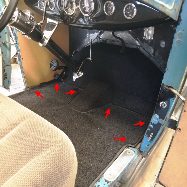

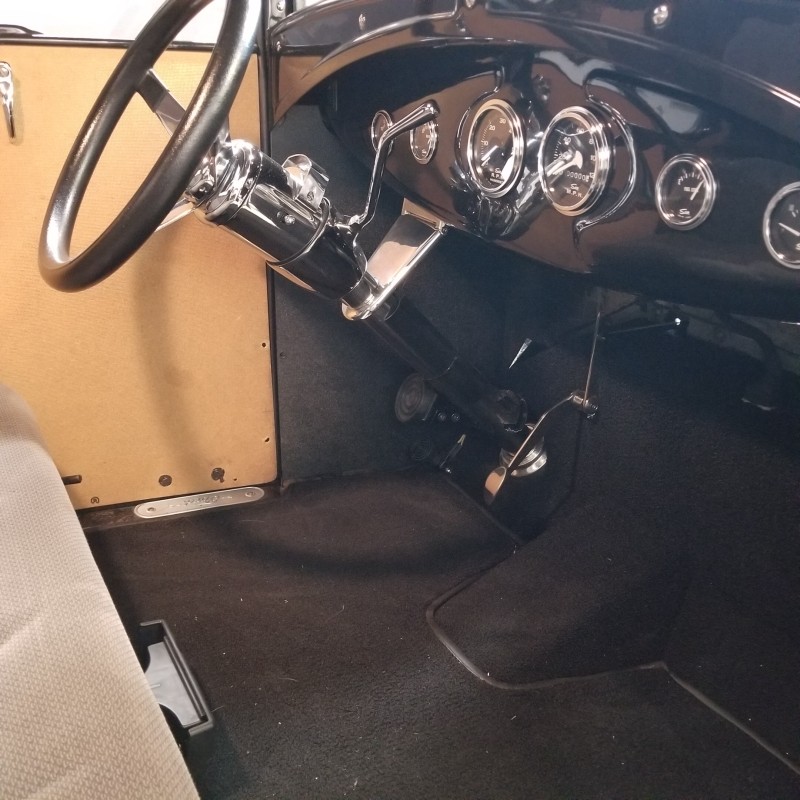

    Gotta work out a few wrinkles after I get the snaps installed, but it looks like a ....... car. In a couple days I'll take some pics of the Veltex snaps...... very cool pieces. Between the sound deadener, padding and carpet, the drone is knocked down considerably. Something simple and kinda nothing I'm jazzed about is the matching high beam pedal pad I found. It's the little stuff.......:)

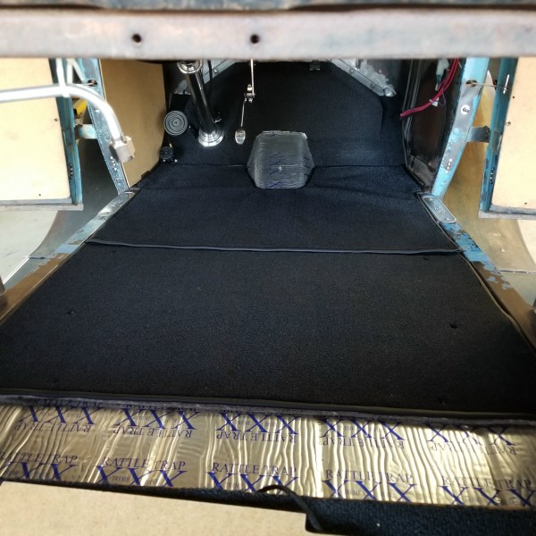

    Tah dah! Still need to trim the pad under the main carpet section so it sits right around the hump, but that's a quick deal. Went back and forth on how to do the carpet and pad over the hump, but it worked out. Put down the snaps this weekend and it's on to painting the interior panels. Gotta use a bit of imagination to visualize it with the dash rail (a**** other things) black metallic, but I'm getting enthused again.

    Carpet's done and took it out for a putt. Drone is WAY down so now it's basically exhaust tone in the cab.

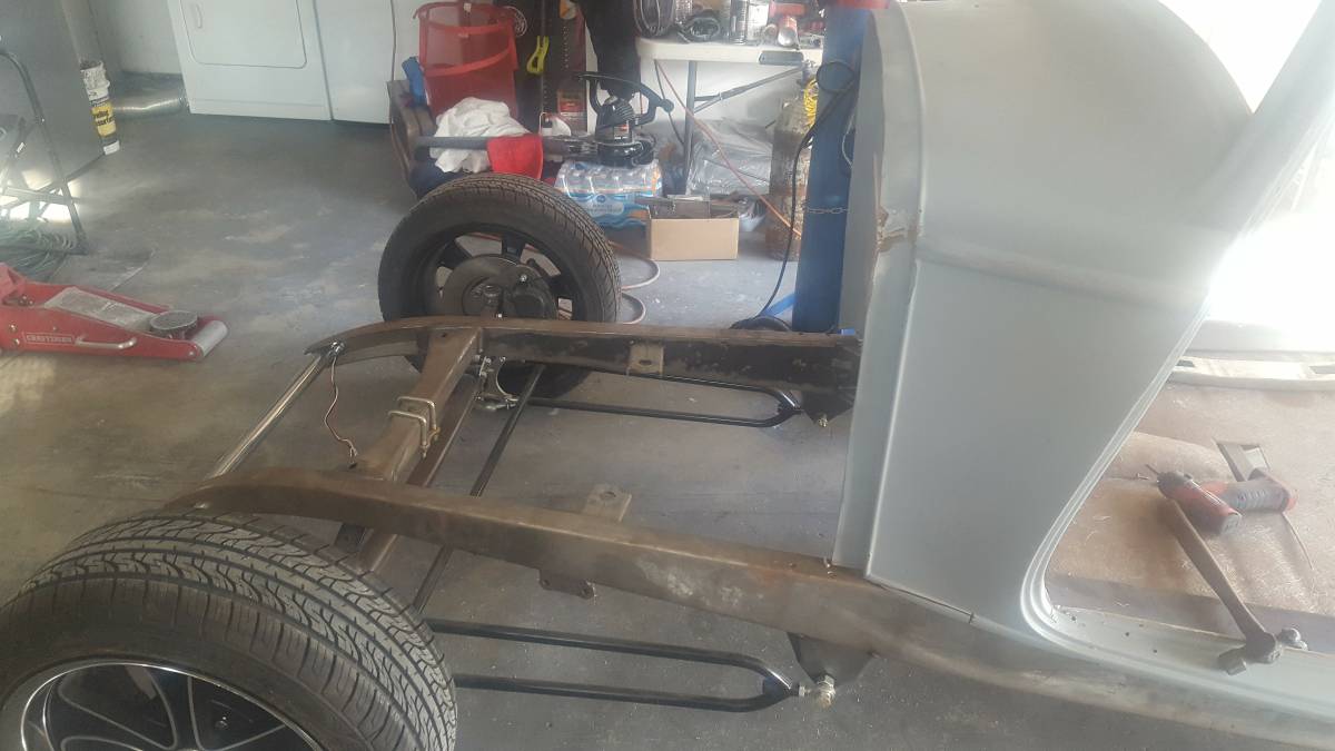

    Didn't plan on it, but struck a deal and the next project will be here Saturday. '32 3 window Gibbon body, TCI frame with triangulated 9", tacked in for LS. Basically a roller with an ***ortment of body and ch***is parts. Pics once it home and tucked in.....

    Don't know what I'm going to do with it, but it's here now. Has a lot of good parts and could be a fun car.

    A few posts ago I mentioned the Veltex snaps I found, and here they are. Stupid little detail, but when I decided to put everything under the floor I knew I would need a way to access the brake master and battery. I decided to make the carpet section removable and just kind of ***umed I'd wind up using the usual chrome headed snaps. Wasn't thrilled, but resigned myself to it.
    Then I was poking around and found these snaps that were used on 60's British sports cars. Nearly invisible when installed in black carpet, gave me just the look I wanted. The pic below shows where the snaps are installed. After this I spaced the male portion of the snap up about 1/8" to make snapping easier and eliminate the slight "pucker" it has in the pic.
    Not earth shattering, but kinda neat when you don't have to compromise (no matter how small the detail).

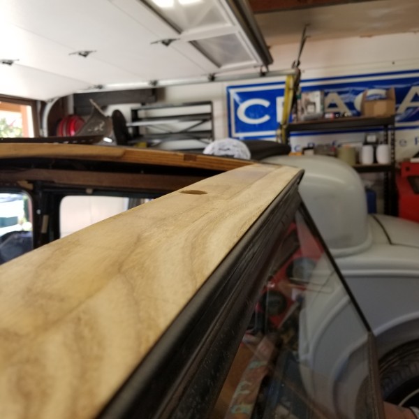

    New carb's on and getting sorted out, and yes it hauls *** now :eek: Been getting lazy about tying up the remaining loose ends, so played carpenter yesterday. The header wood needed about 1/4" shaved off the leading edge so the visor would fit right and the welting seal the bottom side of the visor. Bought a large and small block plane and got after it. Took about an hour, but came out good. Fitted the welt, nailed the panel and welt in place and nailed down the visor.
    Next is have an upholsterer sew the seams for the headliner, install it and finally put the top on

    Interior trim pieces are being blasted so I can prime and paint.. Making bows for the headliner contour so the headliner seams will have the right bow to them. Was going to sew the seams straight, but the more I thought about it the more obvious it became the seams would pucker. What another little delay?

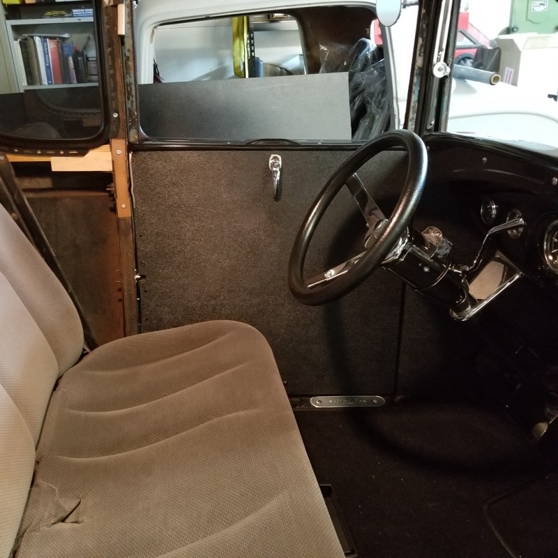

    The wife wants to take her car to a few car shows but the scratch isn't there yet for a new interior. Picked up a 4x9 sheet of black ABS to make new interior panels in the meantime. I'l just use the fiberboard panels as templates and it should be presentable until we can afford to do it the way we want.

    That's the reason I went with the black ABS...... has a nice finished appearance and is a good panel for upholstery. This will (some day) be getting a 2" black pleated interior, but this will look good in the meantime.

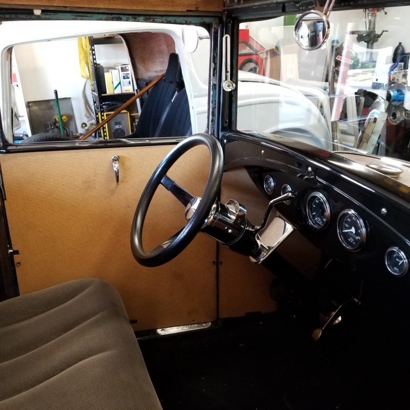

    When you have a giant sheet of plastic staring you in the face you just HAVE to start playing with it. The low hanging fruit is the kick panels, but it gave me a good idea how to work it before I start cutting BIG pieces for the door panels. Gives it a nice clean utilitarian look.

    2nd door done, so tomorrow I can start on the upper panels and get the headliner finished in the front. panel6.jpg

    Ran into a little hiccup mounting the door panels so had to come up with a plan B. I wanted to use the original style panel clips to hold the panels on and work fine for the rear and bottom of the door, but where the windlace is in the front it's too thick for the clips to stay put. Plan B? I've used these on newer cars for years and they should blend in well enough not to detract from the look (the heads are only 5/8" in dia). These will hold the panels in place!
    This week I'll be forming the curved corner pieces so I can finally get the headliner tacked down.
