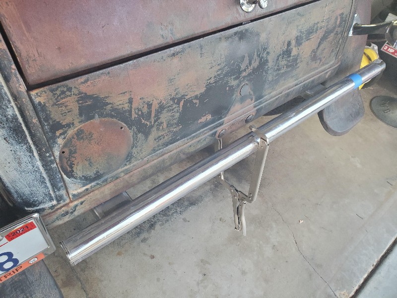

    Dragged this back from the grave rather than confusing the '32 build thread. The car isn't done like any of them really are. Years ago I bought the stainless tube to make a rear bumper/push bar-ish looking thing that was stuck in my mind. Problem was, I had no way to weld up what I wanted to make so it just stayed nice and safe in the cardboard shipping tube it came in.
    Well, flash forward to this week where I FINALLY found an Argon bottle for the tig I bought, so it's back on. Bent up some 1/8" stainless sheet for the mounting brackets today and am pretty pleased with how it'll look. Minor tweaking to maybe pull it in a bit tighter and narrow it, but like how the brackets are somewhat hidden and the bar "floats".
    Going to do a lot of practicing on s**** SS before I attack the welding. Can't afford to F this SS tube up right now. bump1.jpg bump2.jpg bump3.jpg
