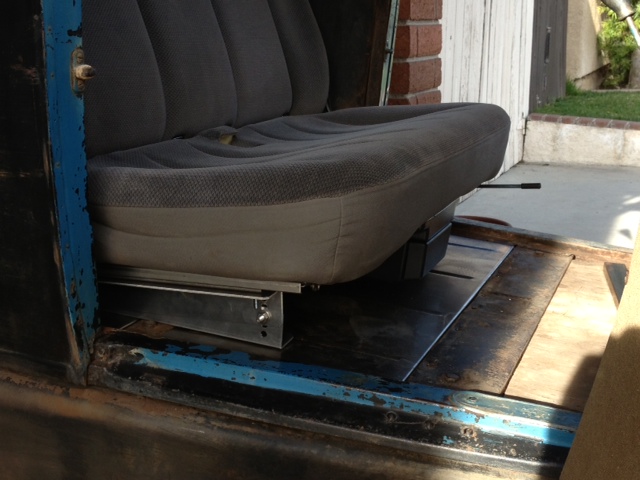

    Made it to Schorr and picked up the rectangular tube and 1/4" plate. Here's the seat mocked up..... just need to get 220 in the garage for the mig and this can get finished. The body will come off next to start boxing the frame.

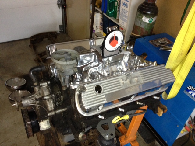

    Next puzzle piece came home today.:D '90 302 roller that's looking for a short tailshaft C4 to mate with......
    Had a set of SBF MT's laying around and thought I'd throw 'em on. I have a carb'ed intake coming for it as well. Geezus, it's starting again.....

    Got the carbed intake in and layed it on to check the pad angle. Comes right in at 4* :D

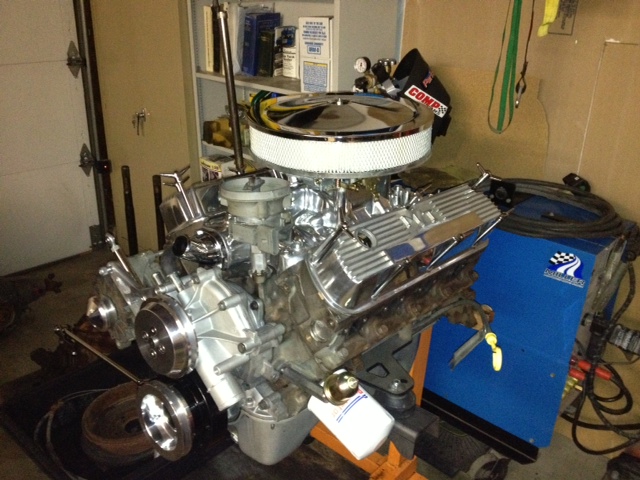

    Pulled the water pump to check the timing cover and looks like I got lucky (it has the standard rotation cover). Ordered the Motorsports short pump and CVF pulley set in preparation for removing the body and mocking up the drivetrain.
    Scrubbed the engine squeaky clean to prep it for paint, just need to decide on the color. I'm thinking gloss black as this isn't going to be a show car, and eventually the body will be shot gloss black.
    I'm going to go in a different direction as far as trannies, and go with a short tailshaft C4. I like that the short shaft front u-joint will be pretty much directly above the front ladder bar pivot. The downside is that the short shaft has a a bolt-on front yoke that will required a splined driveshaft rather than the traditional slip yoke. With the rear trans mount and ladder bar brackets on the same X-member, this should make a clean install with good geometry.

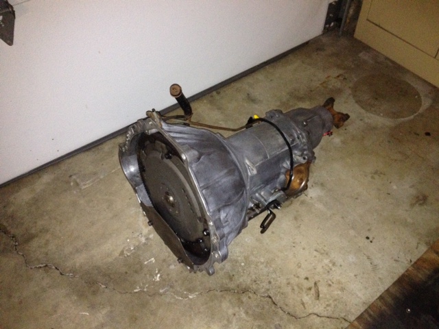

    Now the fun continues.;) Found the short tailshaft C4 I've been looking for (pics after I clean it up this weekend), Motorsport short water pump should be here this afternoon, the CVH short pump pulleys came yesterday, and the 9" is out back. The time is close to unbolting the body and mocking up the drivetrain. :D

    Bolted up the pulleys and am impressed with the quality and alignment. Not "traditional", but a great solution to putting a SBF in an A.

  20. Mr T body
    Joined: Nov 2, 2005
    Posts: 2,227
    Mr T body
    Alliance Vendor
    from BHC AZ
    Needs a good scrubbing, but no big deal. Engine's almost finished too. Body's gotta come of pretty soon.....

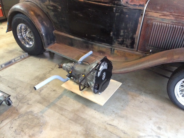

    Things are moving along now. The trans is cleaned up (it won't be painted until after the frame work is done), and I've ordered the correct flexplate and misc fasteners to marry the engine and trans for mock up. The 9" will need to go out for narrowing, so it was time to tear it down and get smelly.
    Got it all apart and started counting teeth to find out the ratio. 9 and 35 gives me a 3.89 (open :mad:) but should work well for a little while with a small block. Probably won't appreciate freeway, but I can make changes after I get it ***embled (gears, converter, etc).

    The original rear will be coming out this week to determine the 9" width, then it's off to get narrowed. I feel like a pimp..... the engine and trans will be mating soon. :D

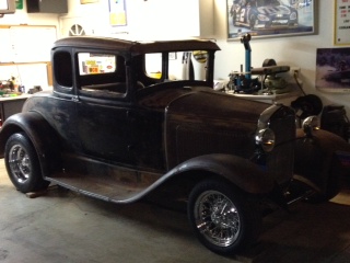

    Rear's out and I started mocking up the rear tire placement. This is close to where I want it, but first I have new rear tires to buy. There are 26's on it now, but 29's will be going on it. The section width may change a little, but you can get an idea of how the sidewalls will line up with the edge of the fender. As it is now, I would need the rear narrowed to 53-1/2" overall. A leaf may need to come out of the front, but we'll see when the 302's in it.
    I'm jazzed, it's so close to the perfect stance (for me):D

    Mocked up the new tires and am pleased as hell with how it's coming along.
    This tire looks a LOT bigger in real life, but will give a great rubber rake. This also allows me to lift the body an additional inch for a total of 4" of rear tire upward travel. Not bad for a 9" under an A frame. With the tires in position, the rear will need to be 52-1/4" wms to wms.
    I expect the front to drop another 1.5" or so with the 302, so the front tire will tuck into the fender nicely.

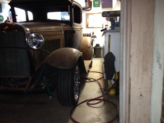

    Better shot of the rake. Bobbing? Oh yeah. Just something ***y about a raked A.......
