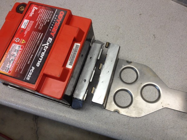

    OK, so much for that ****. This probably isn't "traditional", but what else is new. I'll be running an Odyssey PC925 AGM battery, but there aren't any battery boxes that are model A friendly, so after quite a bit of searching I found something I can make my own. Started off with a Nexgen Offroad battery box.
    First thing is flatten the dimples so I can mount it vertical and flush on the frame rail. Next, was fitting a "pull off" hinge (rather than unbolting the halves) to make battery service easier. Since it's under floor, I'll make an access panel to get to the battery, but I didn't want to have to crawl under just to change a battery. This car will be raked and the front slammed, so a little thought now saves me BIG headaches later.
    If this isn't HAMB appropriate for some reason, let me know

    Spent a little quality time with the welder and got the bracket done and the the boxing plate finished. tray5.jpg

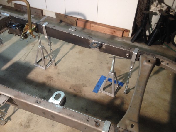

    FINALLY got to welding! Got the front plates trimmed and tacked in place with the rear 2 to be done this weekend. Shop's a friggin' mess after all the grinding...... did I mention I hate grinding? frm1.jpg

    Got the ladder x-member and boxing plates tacked in, braces are next. frame.jpg

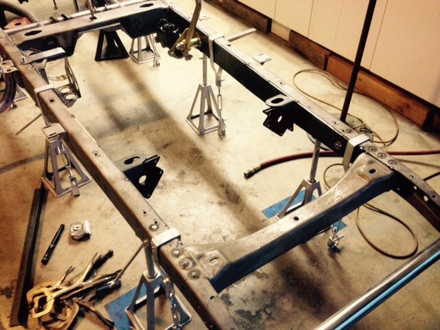

    Finished boxing the frame..... what a learning experience. Couldn't be happier with the results as it came out level and straight as an arrow. My ghetto frame rack did the trick. I'm re-fitting everything getting it ready to drop the engine and trans in. Make the trans x-member, set the pinion angle and tack the coilover brackets in place! This thing could look like a car again.

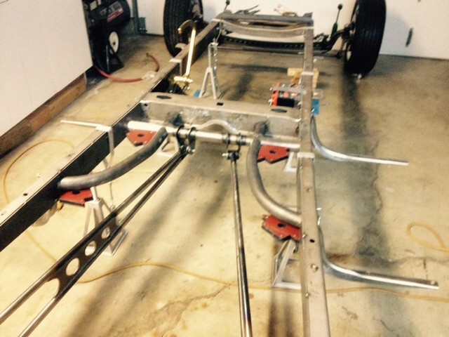

    Haven't posted much as it's been progressing REAL quick. The major obstacle to this point was (oddly enough) getting the trans cross-member done. Now I have the final driveline angle so I can set the pinion angle, and proceed to tack the shock and ladder brackets in place. Already making plans on where and how to paint the frame.

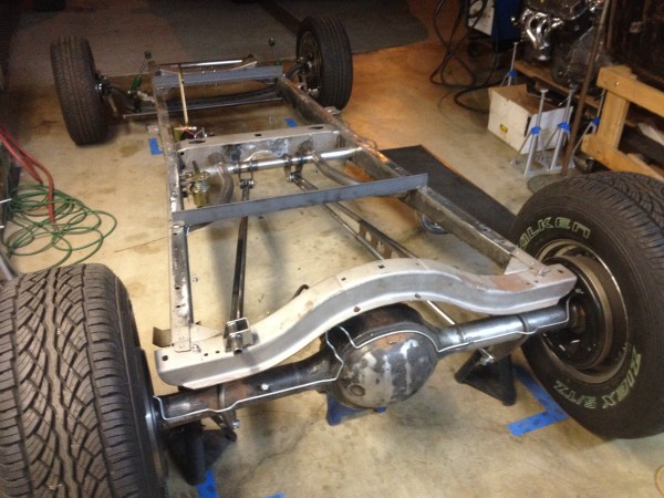

    Busted *** the past week and got it on all 4's for the first time.
