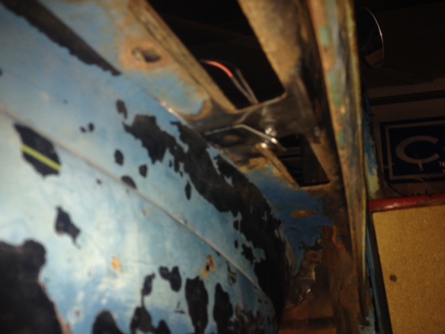

    if you looked really close in a photo above, you saw how the access panel will latch closed. It's called a Quik Latch and is really kinda cool and almost flush.
    Of course that means I had to come up with a way to mount the post INSIDE the tank. Had some sheetmetal left over from the cutouts, so time to cut and bend and tweak. The bottom tab is bent to the contour of the bottom. Wish I was a bit faster.....
    kidcampbell71 likes this.
