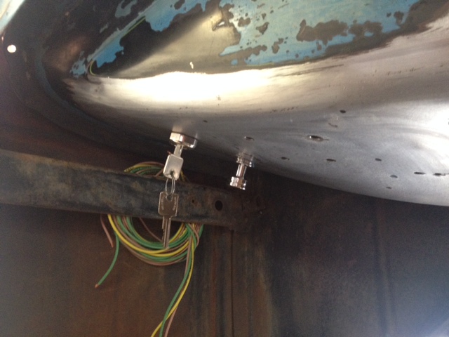

    Things are speeding up a bit. I don't want switches on the dash, and after laying them out it was obvious I didn't have the space to mount them all in the center patch panel.
    Decided to mount the ignition and headlight switch on the bottom of the tank by the left kick panel.

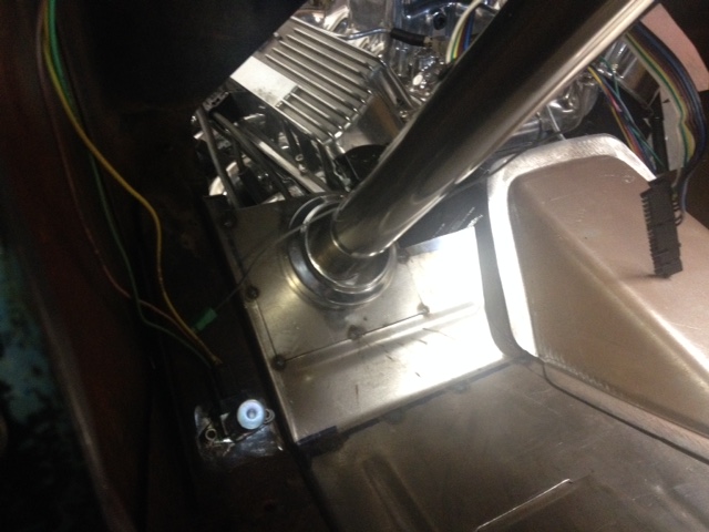

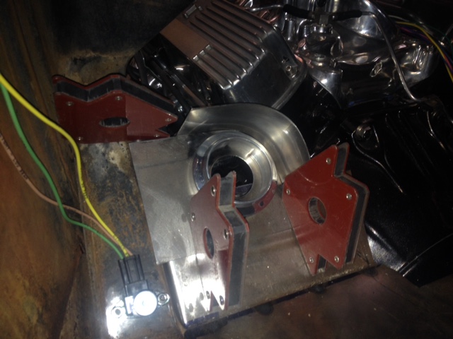

    Alliance Vendor
    from BHC AZ
    Today was epic in an obscure way. I have been wrestling since I bought this car on how the firewall recess, steering column and brake pedal would fit. It was always the plan to have a column shift for a couple reasons. First, (and not particularly HAMB friendly) is to have a flat floor so the cupholders were usable. Second, was so it was truly turnkey for the wife.
    This morning I was staring at it (as I spend too much time doing) and had an epiphany..... where the column was to go through the floor was where the recess and floor came together (at an angle). How it would go through this angle has driven me crazy until I realized it didn't HAVE to be at an angle if the column had it's OWN recess. This will mean a little more welding and t******* when I fit up the firewall recess, but is really rather a simple solution. Everything fell in place after considering a little t******* of the column bezel is required and I accept this will be a left brake car.
    I'm 6'2 and have spent a lot of time on ergonomics to make this a really comfortable car to drive. With the only real concession being the brake on the left, I can drive the wheels off this. It has a LOT of legroom, and with it being un-chopped there's a lot of headroom as well. This really is the last speed bump. Time to knock this out.....
    kidcampbell71 and loudbang like this.
