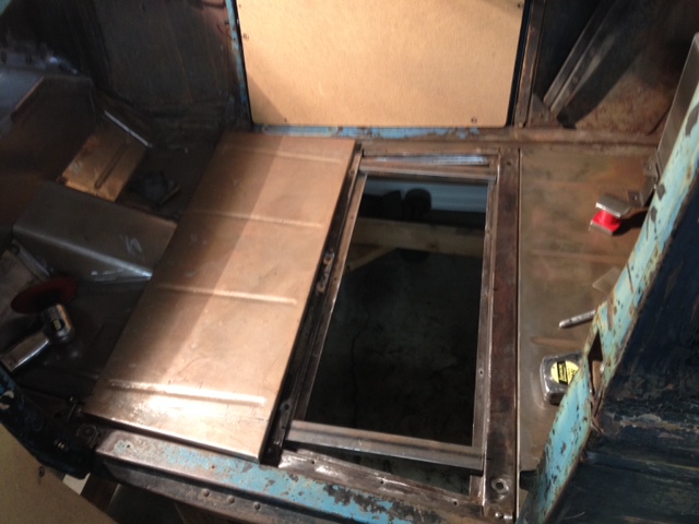

    Last pic with the body on the frame until it goes back together for good. Figured I better cut out the battery access to make sure it can be serviced later.

    Rain..... we need it, but not the day the body's supposed to come off. Had some make work to do, so it wasn't a wasted day.
    Got the battery access panel done, and a sneak peak at the tank straps I'm making so the tank can be serviced in tight quarters. I thought about getting all **** and bead rolling the battery cover then figured this would actually be stronger and nobody's going to see it anyhow. The carpet will be snapped in for easy access.
