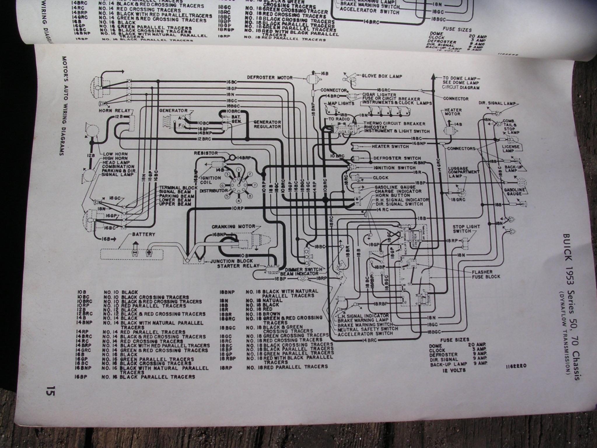

  11. F&J
    Joined: Apr 5, 2007
    Posts: 13,281
    F&J
    do you need a wire diagram for that model? I have a book.
    As I recall, GMs of that era have a relay or some connection lug on the driver fenderwell. And I think some Buicks may have a unusual starter system, some go to a accel linkage switch, but not sure which years.
    Tracing is the best way, and with a diagram.

    F&J: YES... I would really like to have a complete wiring diagram... and you're right, I have found that my 53' Super has MANY specs/parts that are only unique to that year.
  13. F&J
    Joined: Apr 5, 2007
    Posts: 13,281
    F&J
    here is a 50 series, which i think is a super.
    for dynaflow, but i have a diagram for standard shift also
