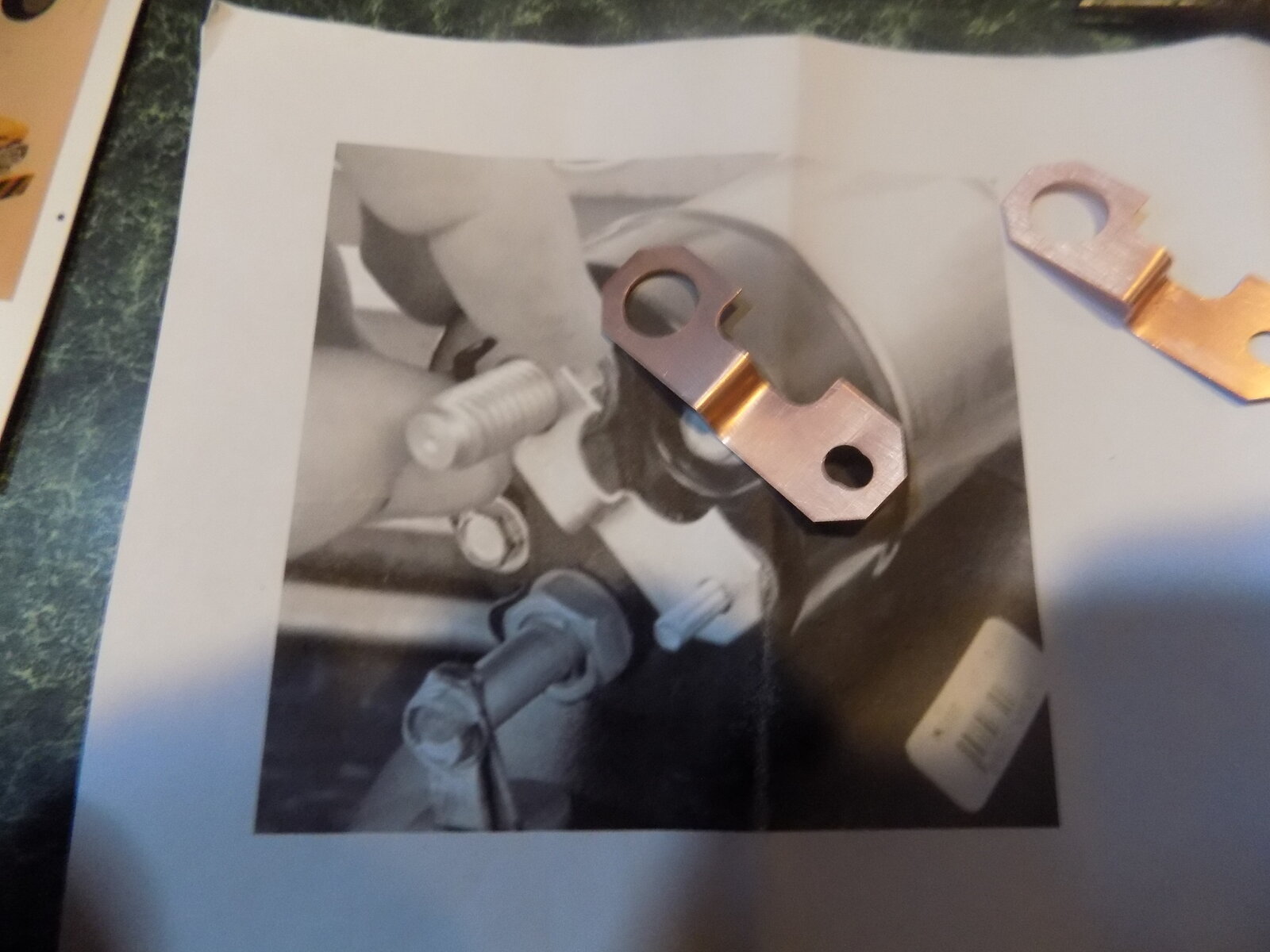

  18. bobss396
    Joined: Aug 27, 2008
    Posts: 18,907
    bobss396
    If you can't find a diagram of a Ford solenoid hook up, I'll shoot a picture of mine and post it. You need to jump the starter hot to I believe the S post on the GM solenoid.
  19. bobss396
    Posts: 18,907
    bobss396
    This is the GM solenoid jumper I made from .025" copper sheet.

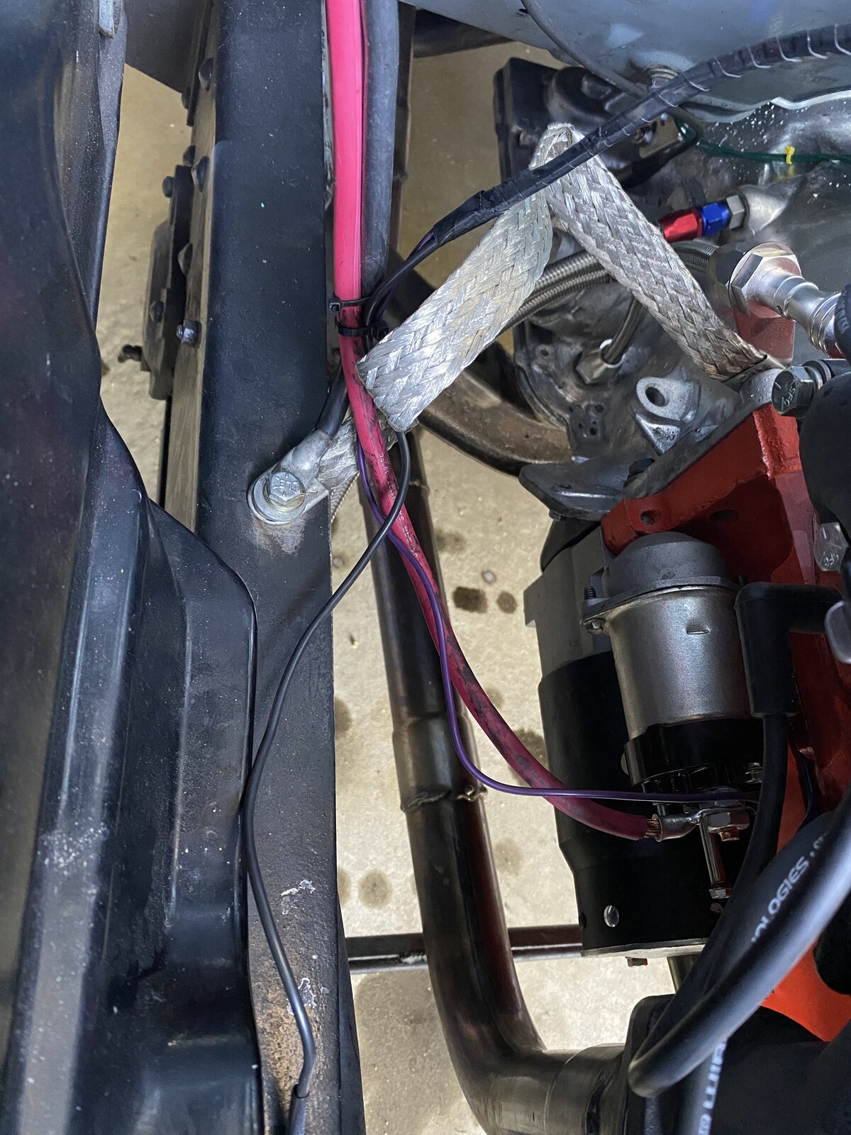

  20. Scott71
    Joined: Jun 22, 2020
    Posts: 57
    Scott71
    Here is what I have. I had to remove the pedal starter and added a push ****on starter on the column where the old shifter linkage went through. I did solder the purple wire off the starter solenoid to the the blue wire off the starter ****on. That would be the only area in that wiring I could see as an interruption but it seems a very solid contact.
    The grounding cable from the frame to the back of the engine is new as well as the red power cable. Battery is new.

  22. Truck64
    Joined: Oct 18, 2015
    Posts: 5,325
    Truck64
    from Ioway
    I've seen those "emergency" bolt on clamps for battery terminals cause problems. Is the starter cable terminal soldered?
    I like to run the main battery negative ground cable directly to the block or a bolt on the starter itself. Directly to an alternator bracket bolt is popular. Then a ground strap to the frame. Then another ground strap to the firewall. The "big three". (If you have an aluminum radiator, they usually recommend a solid grounding strap for that too).
    The starter is the highest current draw by far. I know the OEM used to route cables different, but they always used the lightest skinniest gauge (and shortest) cable they thought they could get away with. Bean counters. You'd think copper was a precious metal the way they cheaped out.
    Measure the voltage drop from battery negative post to starter case as described earlier. Maybe the cables aren't a factor here in your Unpleasantness, but it is something to be checked.
