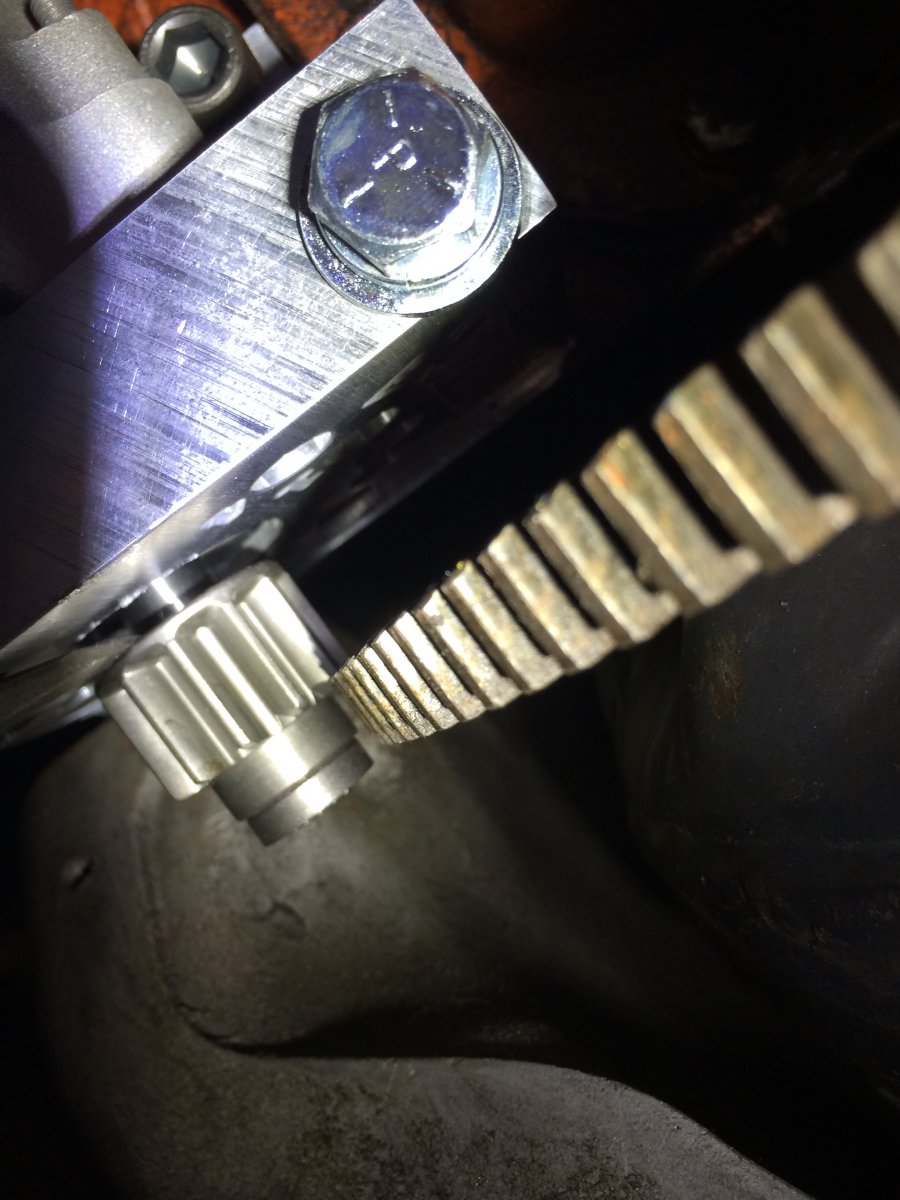

    image.jpeg That is correct not engaging front to back far enough, here is a pic of the summit starter it was the worst.

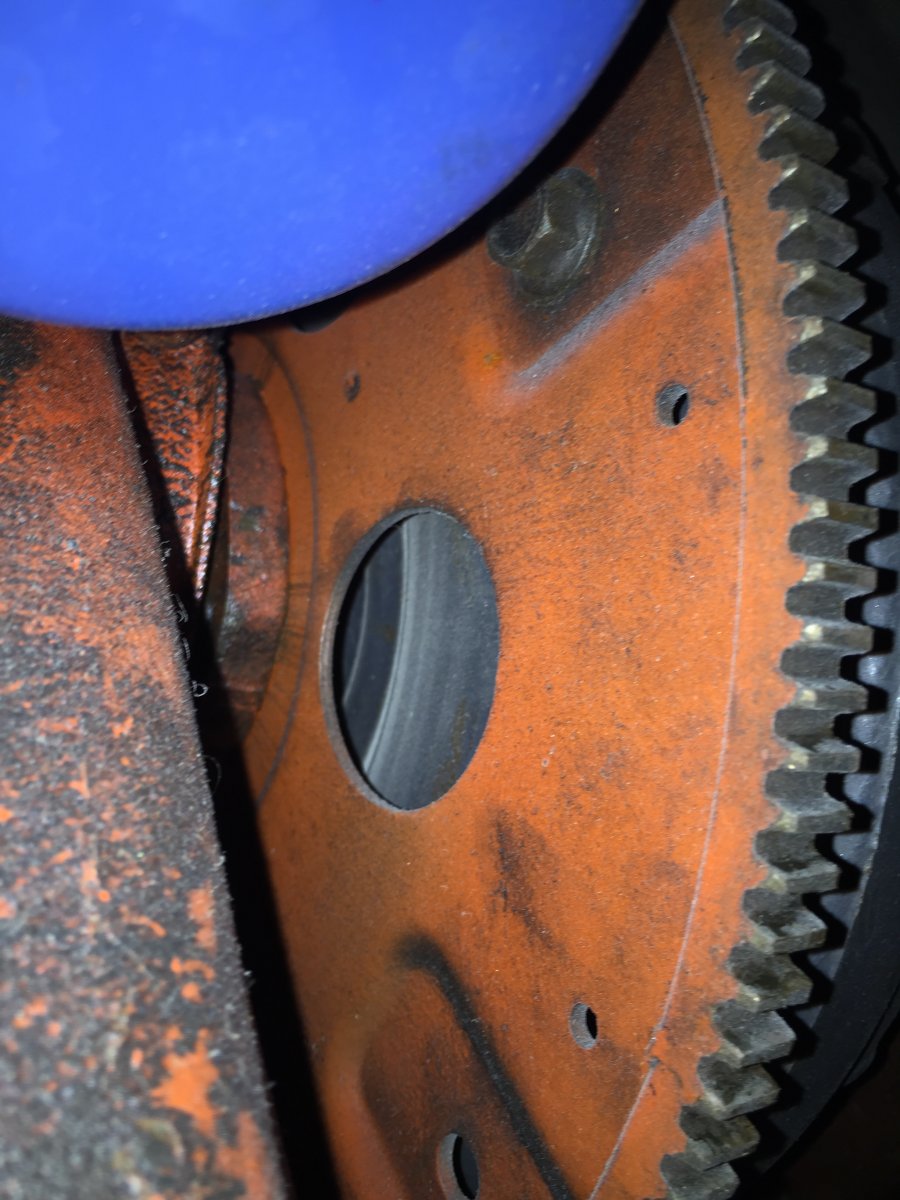

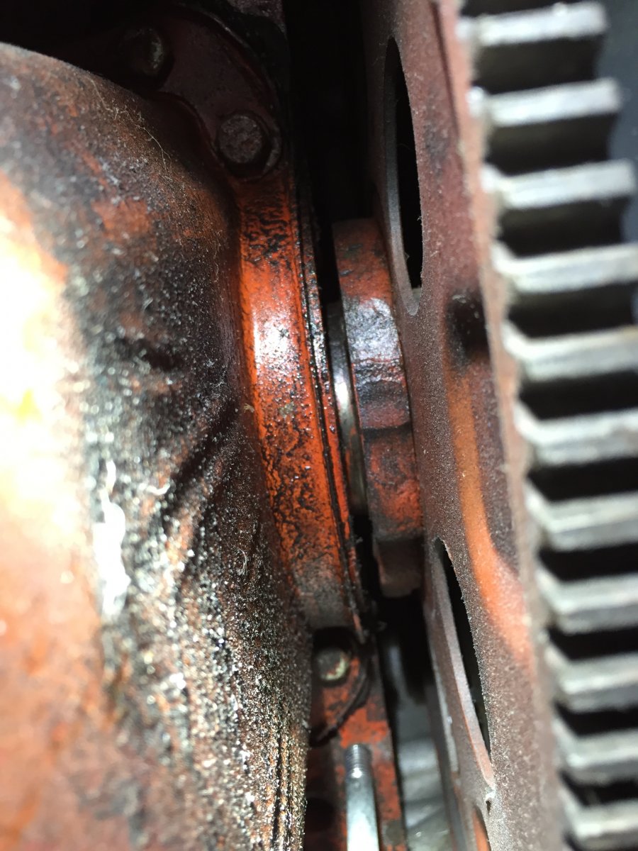

    image.jpeg Here's a pic of the crank where the flexplate bolts up..

    Mini starters do not extend as far as oe starters, per powermaster tech rep. He said Oe should go about 100% of the way in and mini starters should go about 50-75% of the way into the flexplate. Which makes sense since the Oe starter only engaged 50% on mine, which he said was a red flag, and the mini only goes in about 25%.....I'm stumped, and was hoping someone has seen this before

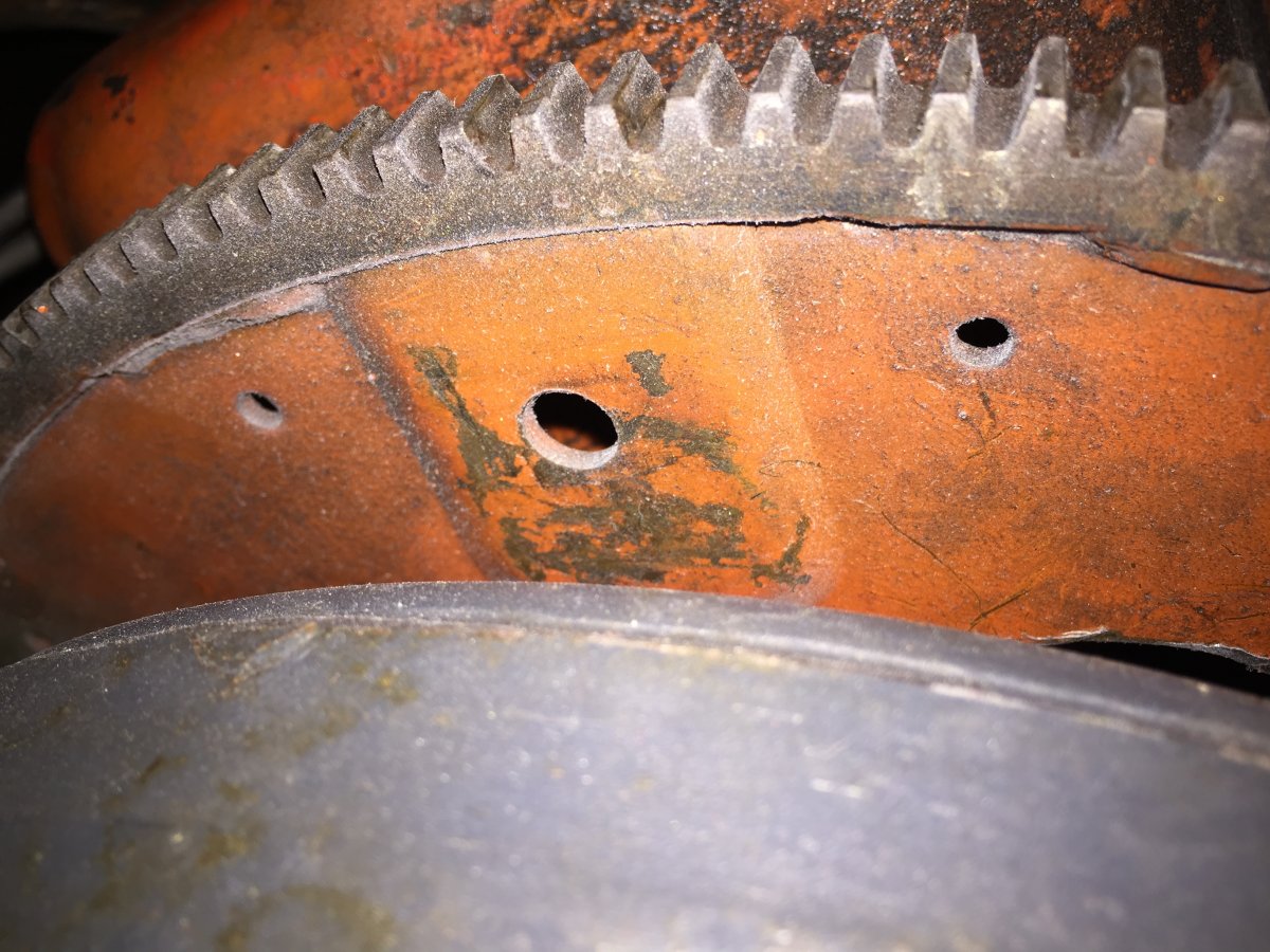

    image.jpeg image.jpeg here is the ring gear if you can see it

    Someone said in a earlier post "is it possible the ring gear was installed wrong", Maybe... I guess if it was me I'd pull the trans and cut the ring gear off and reweld it to give you max engagement, do you think there is meat enough to do that? JC

    I have a small block with similar problem. I put a GM flexplate on it and the ring gear seams to be too far from the back of the block.
    I've made it work with a mini starter with the depth shims removed. The GM starter I have will not engage the ring gear.
    I suspect the ring gear was not properly installed on the flex plate.

    Are you sure the flexplate is flat. By looking at post #7 it almost looks like the flexplate is bent away from the engine which would put the ring gear too far from the starter drive.

    I've looked at it a lot and it seems true, I've rotated it and. The mesh is about the same ll the way around. And it doesn't look bent at all
