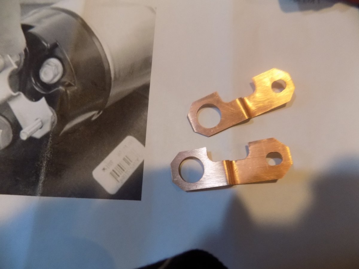

    Looking for a part number for this starter connector, my home grown jumper wire broke. Thanks!

    Thanks. I saw the quick car one at Summit. Similar to the one I had that broke at the S terminal. The ring broke off the lug. I used 10 gauge wire and good lugs and shrink tube. Will hit Ace tomorrow for .031 copper sheet, fab a few up and dip them in a solder pot at work.

    Picked up some .025" copper sheet at a hobby store, measured up a spare starter and have a CAD drawing going, need to make up a simple bending fixture to put the joggle in the piece.

    Ok... the Standard Ignition P/N is SZ-654, the Motorcraft P/N is C8VY-11072-A.
    Any listing I come up says it is obsolete, one place I saw it for sale but with no picture, which looked to be a click-bait link. eBay... nothing. I may as well go make the darn thing.

    OK... I'll call it done. Found some .025" copper at a hobby shop (K&S brand) and went out to the shop and made 2 of them. I'll see if I can get them solder-dipped at work later on.
