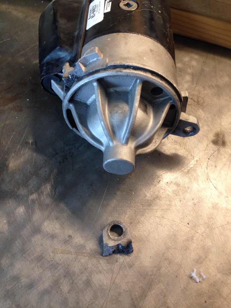

    Anyways to bring you up to speed. We have a 64 chero with a 5.0L and a c4. Been fighting a grinding with the starter at start up. Goes away after running. Last night after driving down to a buddies for a shop party, I stopped for gas. Trying to start again it wouldn't engage the ring gear! So at the hour of 1:00am we decided to push it to a stall at the gas station and get it in the morning. While shoving it across the lot I bumped it and she caught and fired! Got home safe! Now this morning I went out to ***ess the damage to the new flex plate and found its ok! Now I found that the starter was tight however one of the bolt ears had broken off! This is the second time its happened! Last time was in Iowa at Eddyville after TECH!!
    Any ideas on why this keeps happening??

    do you have the thin metal plate between the engine and transmission bellhousing?

    There are two different sizes of holes in the thin metal locating plate between the bell and the engine. make sure you aren't trying to tighten a large diameter starter into one of the smaller holed plates.

    That is the correct starter for the automatic transmission, standard transmission starters had a short nose. If the hole in the thin plate is worn oversized the starter can shift, it's used for alignment.

    The plate we used is new when we did the build last year. I'm wonder now if the bell housing isn't letting the starter fully sit down on the plate. There for when bolting it down it appears to be ok but after a time the ears are on a slight bind and snap off. Just throwing it out there....

    The original starter was lester(rebuilt) number 3124 the starter you have on now was a later version looks like a # 3180. The 3124 or a 3153 were larger and had beefier mounting ears.

    I struggled with a starter for a long time a few years ago and then I checked the big hole that the starter nose goes into. I found out that in Ford's infinite wisdom they made a starter with a mounting flange that is only about 1/8 inch bigger than the one I needed. I found another starter and measured the lip that goes into the hole on the plate. It was just a tad smaller and I put it in there and it fit perfectly. So there are at least two sizes of large holes in those plates between the engine and the bellhousing. I finally put in a mini starter to save space, but check the big hole and make sure its the same size as the starter nose lip.

    Two things to look at - The factory starter bolts usually have a good size shoulder on them, the wrong bolts will shift the starter when engaged .- Some Ford starters have one bolt goes in from the front and one from the rear, take a close look how your bell ,,housing is threaded

    Well we might be onto something here. I just grabbed a couple bolts out of my bin and used them. 3/8-16 1 1/2 or 2 can't remember. That could of added to the problem. I'll get some starter bolts when I get my new starter! Thanks for the heads up!
