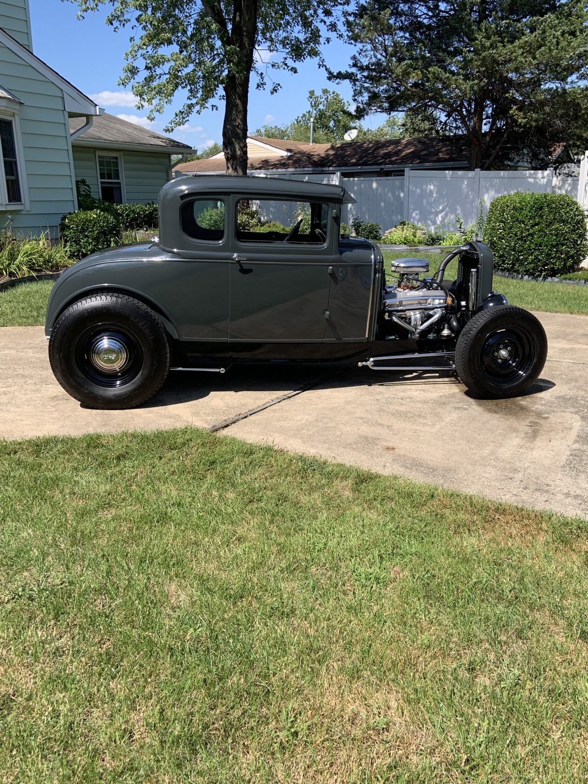

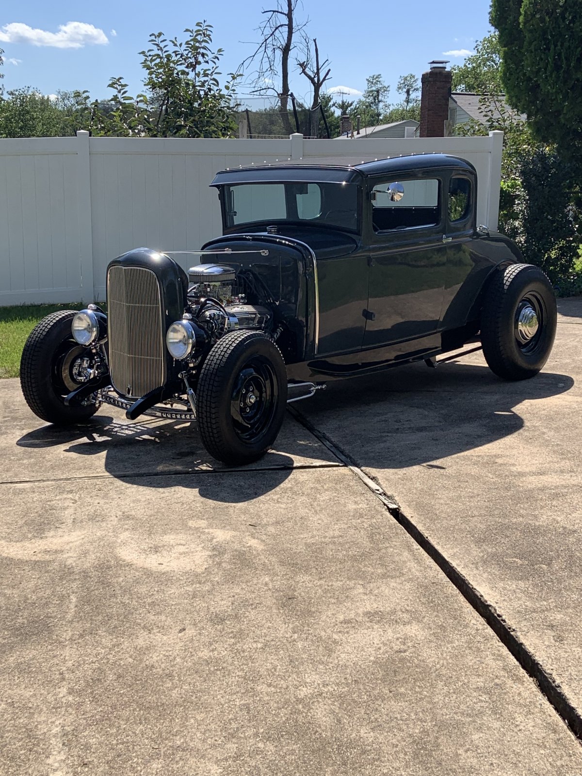

    How about a radial tire that looks like the old bias ones. Excelsior Stahl from Coker 16425FB6-3B71-447C-97CE-7B2575B918F1.jpeg C986C9CC-271E-480F-8AAD-8D3EECD93C16.jpeg

    That is perfect. That is the look I am going for.

  18. Dino 64

    That rear tire fits the body perfectly…
