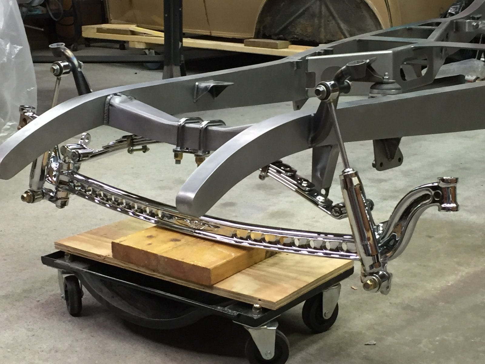

    Question? I got all my parts together for the front and rear suspension. Hairpins for the front and transverse (buggy) spring on the rear. Does it matter if I install the front suspension first or should I mount the rear first? Any suggestions on mounting both will help. I have looked on several sites to make sure I am doing it right but not much out there that is specific. Thanks
    Dino 64 likes this.
  11. Dino 64
    Joined: Jul 13, 2012
    Posts: 2,537
    Dino 64
    from Virginia

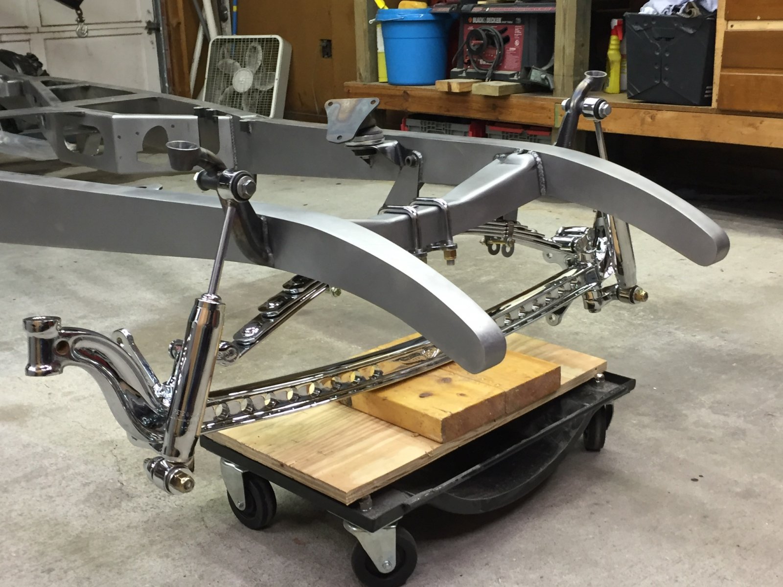

    Hey ! I don’t think it matters which end you start at. I think I just put the ch***is on jack stands and went for it. Do you have any wheels and tires at this point? Once I got the hairpins attached to the front axle, I made a wood ‘jig’ to lift the front axle up an ***embled the rest. The jig was just a couple of 2x4’s mounted on a piece of wood creating a slot the width of the axle. Wheels and tires makes it easier
    Good luck ask questions :rolleyes::)
    Crew Chief and lothiandon1940 like this.

    ***embly, the jig..then I attached the 2x5’s to made the slot for the axle 95F4B4A2-DF21-42C6-AC99-065103263F7A.jpeg F5154610-4BC2-4429-AC66-F91B77D912DF.jpeg

    As long as you have the frame well supported you can do either. Be careful with the springs once you load them up. Don't want a spring flying and smacking you in the head! Lots of good vids on youtube. Checkout @IronTrap on youtube, he has lots of good videos that you can learn from and Matt's a great guy. Good luck with the build
    Crew Chief and Dino 64 like this.

    I set up the ch***is with just the main leaf. That will be similar to the finished, fully loaded car sitting on the springs. All suspension arms/bones etc. need to be set as if the car's full weight is on the suspension.
    Also, when you set it up and locate suspension points, make sure the frame is at the desired finished rake.

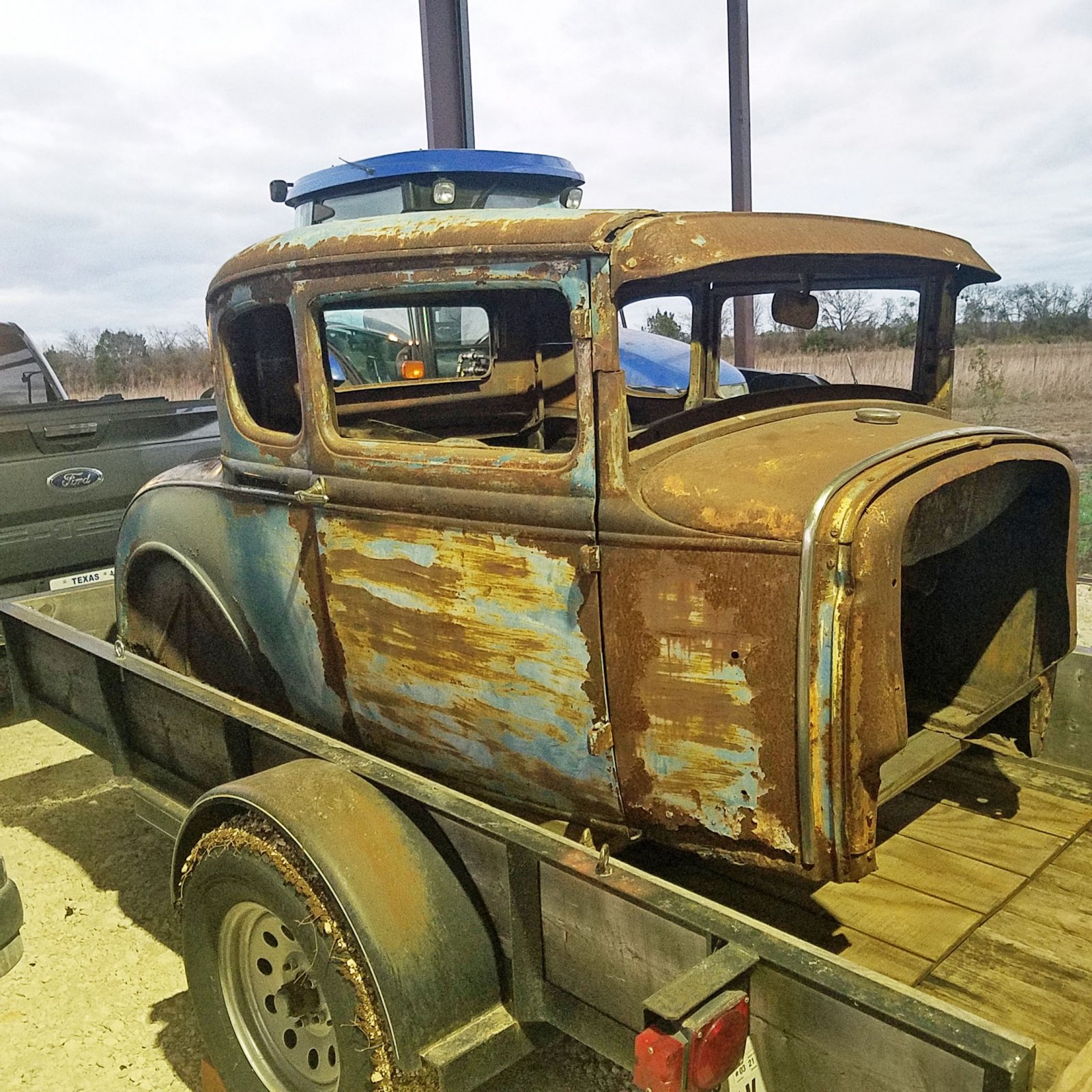

    After a few months of not working on the 30, I am finally motivated to get back on it. At least until we go on the road again. Anyway, I have mocked up the engine, transmission, front end and rear end. The subrails are trash therefore I am getting those replaced by a guy that is in the business and owes me. I am going to fit the doors before I finish welding the body where the chop is.

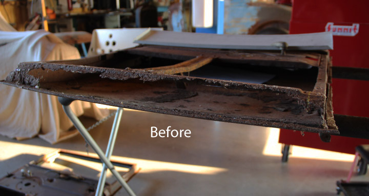

    Speaking of doors. I had to fabricate the bottom frame on the drivers side. I had to make it out of a 30-31 pickup bottom frame from Howells. There are no coupe replacements. Cut and splice. I think it came out ok. The patch panel was another pain in itself. I tried as I could to keep the warping down to a minimum but I still had some. I will continue to m***aging it and then slap some filler on it. I am not making a show car, just one that is presentable and I can drive regularly. Don't make fun of my welding.

    Lookin is good so far ! I would stay away from Howell’s sheet metal. None of the replacement panels fit really well regardless of where you got them. Brookville is too expensive, I used Brattons in Maryland but Snyder’s is ok. I like the tires you have.

    Hey Dino. I would normally not buy from Howells because the website is slow and my firewall will reject it because they don't check their malware. They were the only ones with the bottom frame patch even though I had to take a section out of the middle to make it work. I will not be buying anymore patch panels since the previous owner threw in all the ones he had ordered. Yes, they all need some fitting.

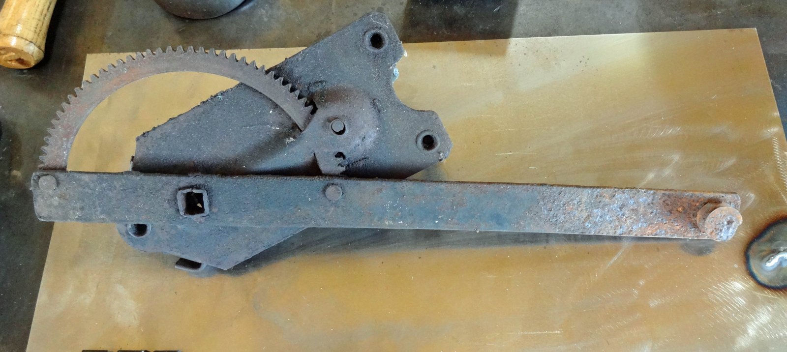

    What do you all do about roll up windows? Some guys do not install them. Both my regulators work but the fixed round guide that the window channel rides on are rusted out.

    Do you have a pic of that ? Not sure exactly what you’re referring to

    Here is what I am talking about. This one, the none rolling guide has rusted through in some places. The p***enger side door regulator works real well.

    I don’t know why you wouldn’t want windows?
