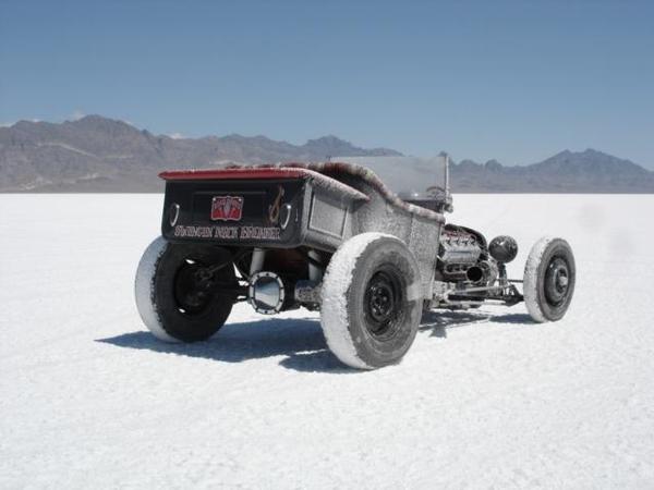

    heres mine, if you run into problems or questions feel free to drop me a pm.

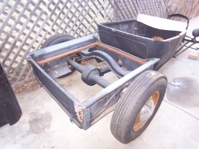

    I have a '27 that a work in progress. it started out as a '23 but turned into a '27. I am going to be using Old Dog Street Rods body and their 20" pickup bed. heres a post that has my progress as of two months ago. i need to post a new one with my spring to wishbone mounds and my front axle and stuff. Good luck.
    http://www.jalopyjournal.com/forum/showthread.php?t=194558&highlight=****srock
    heres some pics of my project!

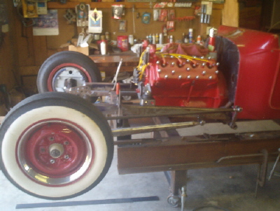

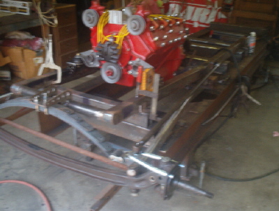

    Pretty good thread on T's going here. Heres a few shots of my work in progress, this is the ride I posted asking about the transverse spring measurements....
