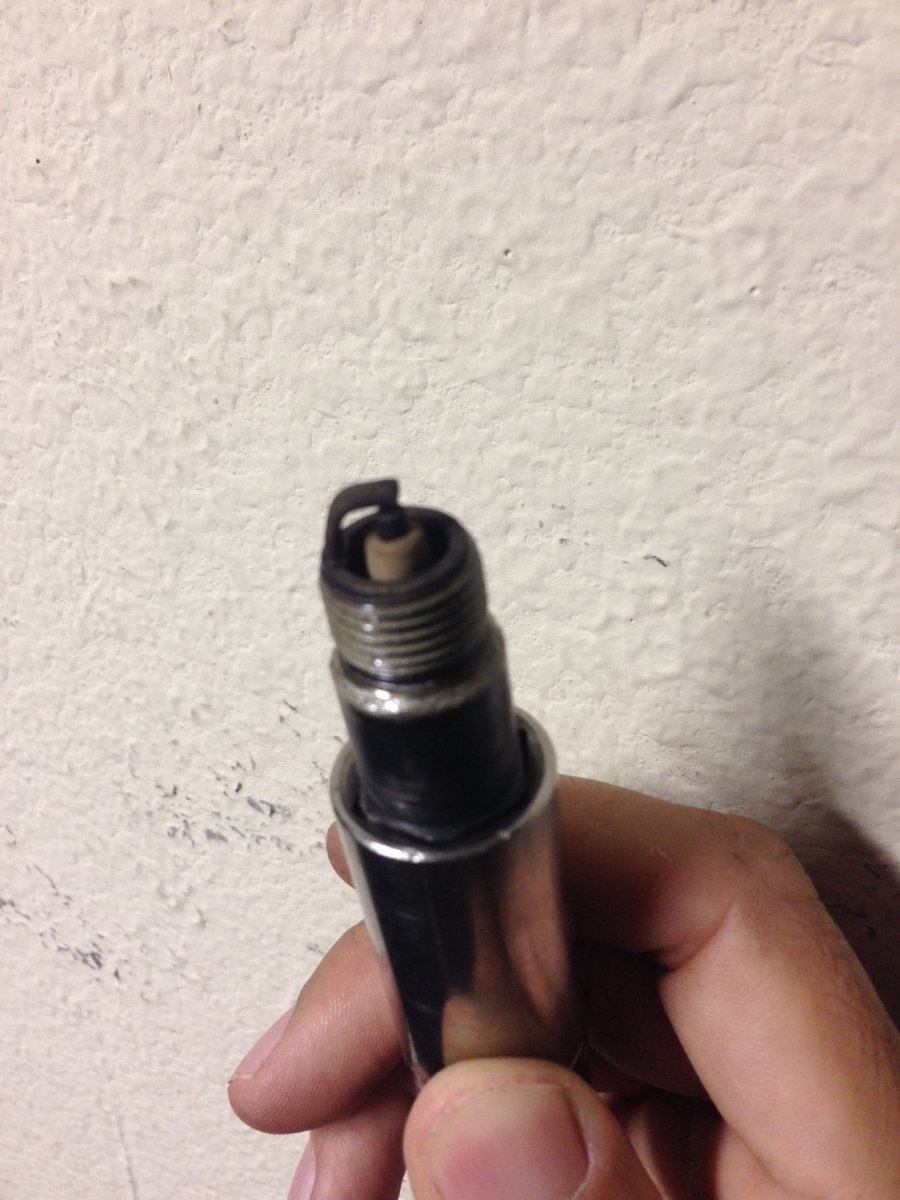

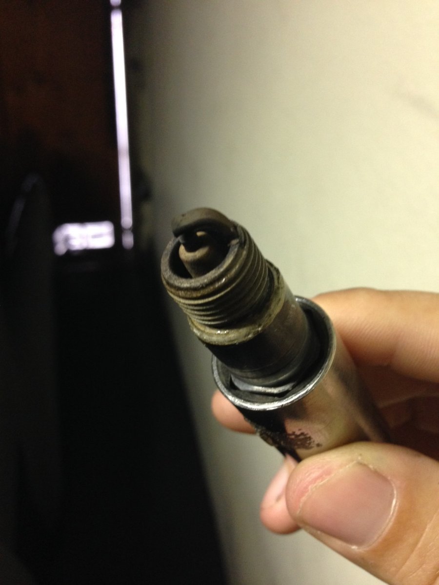

    I pulled #3 spark plug out. I didn't pull any others. Here's multiple photos of the same plug. I estimate more like 350 to 400 miles since March when I put new plugs in. I don't have a sandblast cleaner. Should I buy new ones? I'm changing the oil and filter even though I only have 350 to 400 miles since March when it was changed.

    Thanks, I'm going to try and find out what type of electric fuel pump it has as I want a backup anyways. It is located close to the tank. I imagine if it had way too much fuel pressure without a regulator, I would see other issues. Also I probably would have a hard time starting even after warm due to flooding? As I said before it starts fine when warm.
    Not sure why the plugs look like they do after not many miles on them. Maybe the carb is flooding when cold or if it sits for weeks?
