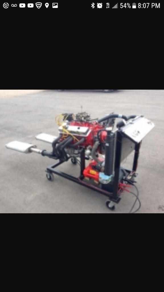

    If you were closer i'd lend ja one (picture of 2 in the back storage pile)... easy to build out of left over's ---->
    els and Donuts & Peelouts like this.

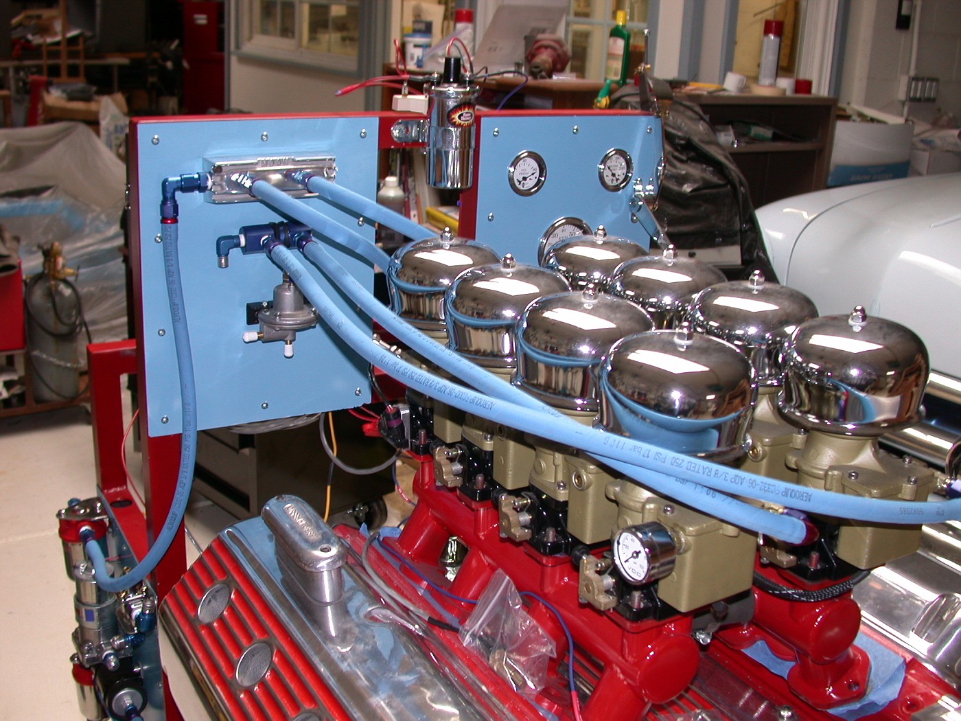

    few (2)off the net....
    els likes this.
