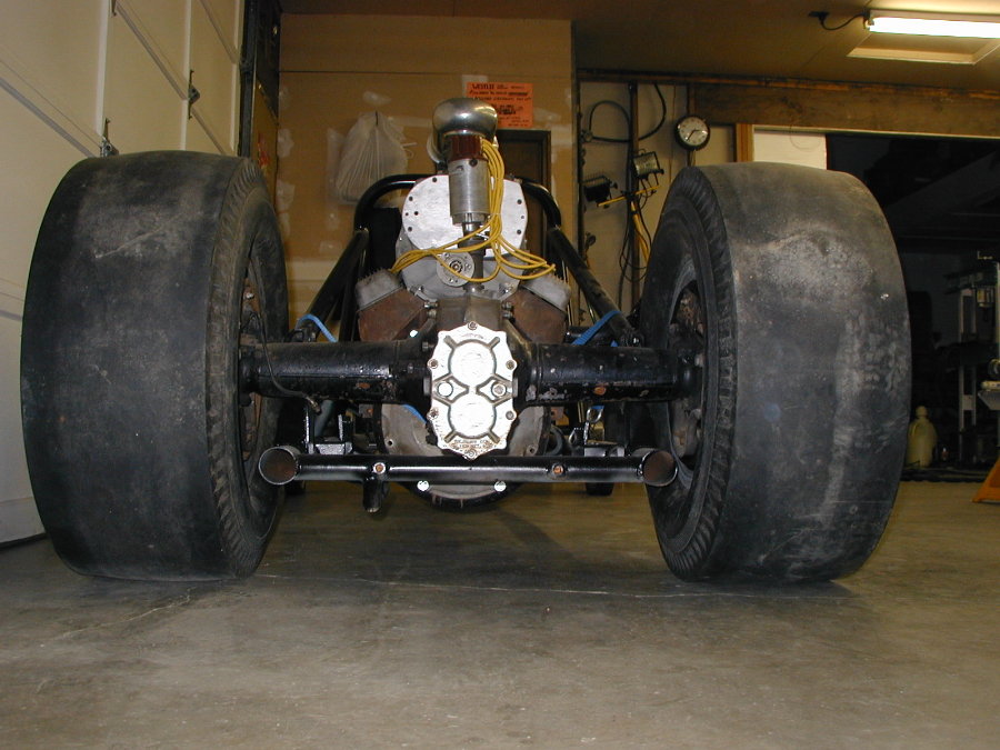

    I see that you are 17 years old and this system must be very new to you. You might want to go to the Hilborn web site and see if there is a drawing showing how the thing works. They used to sell a pretty good booklet on getting started with Hilborn Fuel Injection. Might find one on Ebay. And by the way. A magneto is a distributor that generates it's own electricity. So that is still a good place to look for the pump. Other wise it would need to be belt driven off the crank. Some drive straight off the cam, but I can see that yours is not that way. I will try to show a picture of a crank driven pump. You can just see it at the bottom of the picture

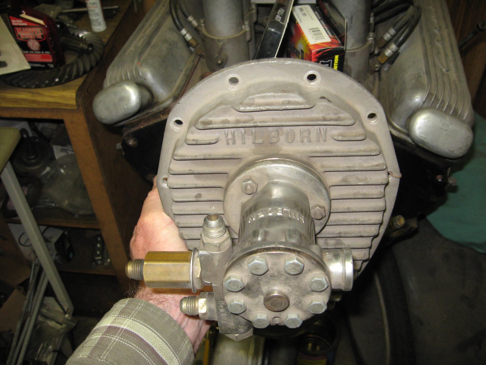

  14. Marty Strode
    Joined: Apr 28, 2011
    Posts: 9,850
    Marty Strode
    Are you sure that it ever ran with the injectors on it ? Like others have said, I don't see how the fuel pump was driven. As Rich questioned, does it have a distributor or a magneto, and what is the access like to the rear of the engine ? Here is a shot of a right angle pump drive that sits between the magneto and engine, and what the pump should look like. Good luck with that project, it looks like fun !!!!!!!!!!! P7310007.JPG IMG_5614.JPG

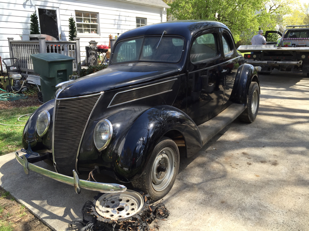

  18. Prescott
    Joined: Dec 28, 2014
    Posts: 17
    Prescott
    It has run before, my dad saw and heard it when he was a teenager, haha! But this was back in the 60's... It has a magneto, and the access to the rear of the engine is very limited. If you can't tell, the back two stacks and the magneto are somewhat hidden behind the old firewall so priming the oil pump would also be an issue...

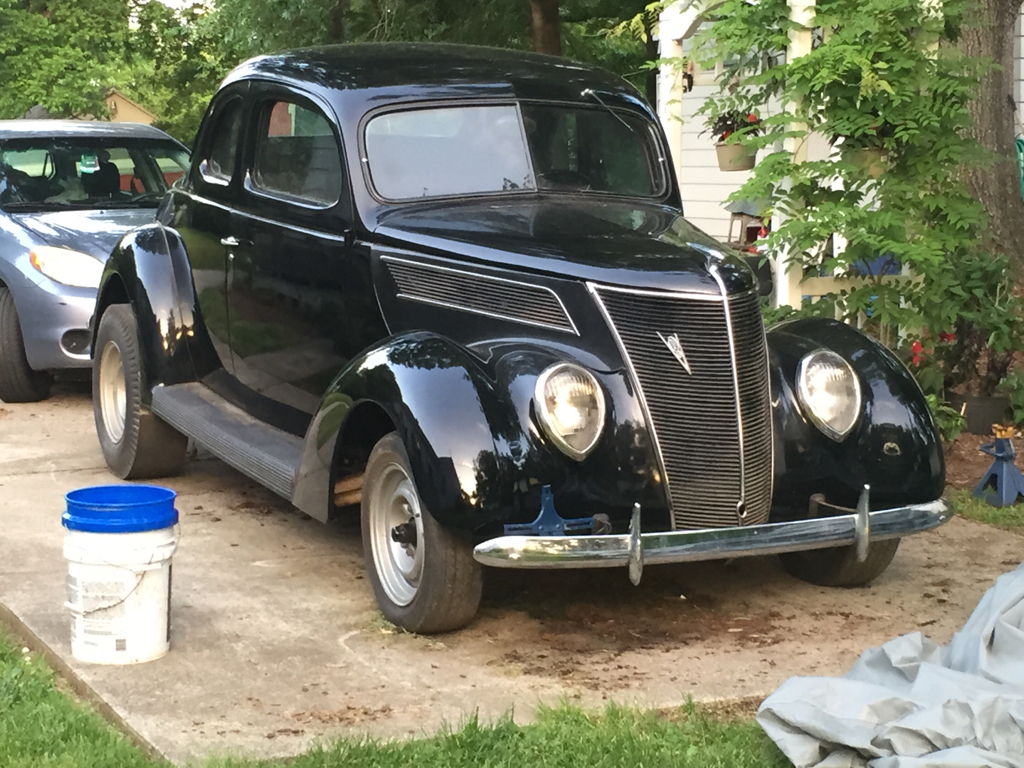

    Here's a few more pictures of the car! ImageUploadedByH.A.M.B.1432090597.835042.jpg ImageUploadedByH.A.M.B.1432090626.363510.jpg
  20. Marty Strode
    Posts: 9,850
    Marty Strode
    Prescott,
    That is about as cool as they come, perfect stance, headers and slicks. My Brother had a '37 back in 1958, he was about your age at the time. Keep us posted, there are plenty of us on here, willing to share our knowledge. 2014-12-31 110755.jpg
    Prescott likes this.
  21. 1934coupe
    Joined: Feb 22, 2007
    Posts: 5,338
    1934coupe
    Talk about your "sleepers" I would never believe there's an injected hemi in that. Real nice!
    Pat
    kidcampbell71 likes this.
