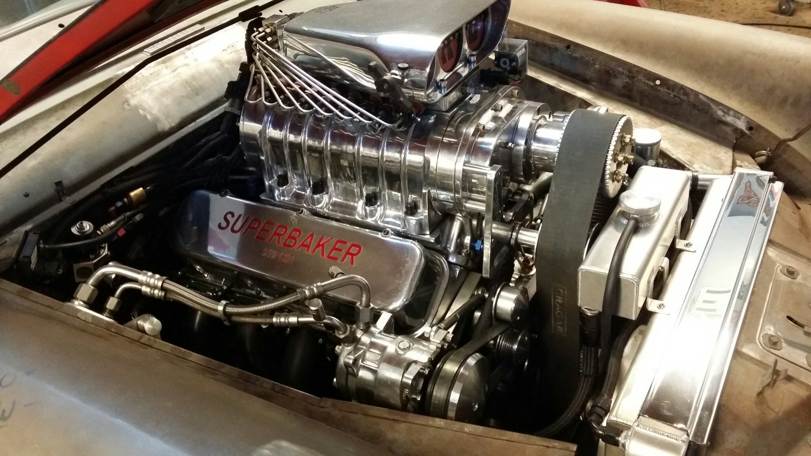

    I had a car I ran on the streets with mechanical injection...looks very COOL, but it is kind of a pain in the *** to drive around all of the time...I put a "Check Valve" right at the fuel tank so the fuel wouldn't drain back and cut down cranking to start. Now I enjoy electronic injectors run by a FAST computer with the same "OLD SCHOOL" look...more driveable and reliable.[/ATTACH]
  28. Looks great! We are looking into getting the Hilborn converted to EFI, depending on the cost.
