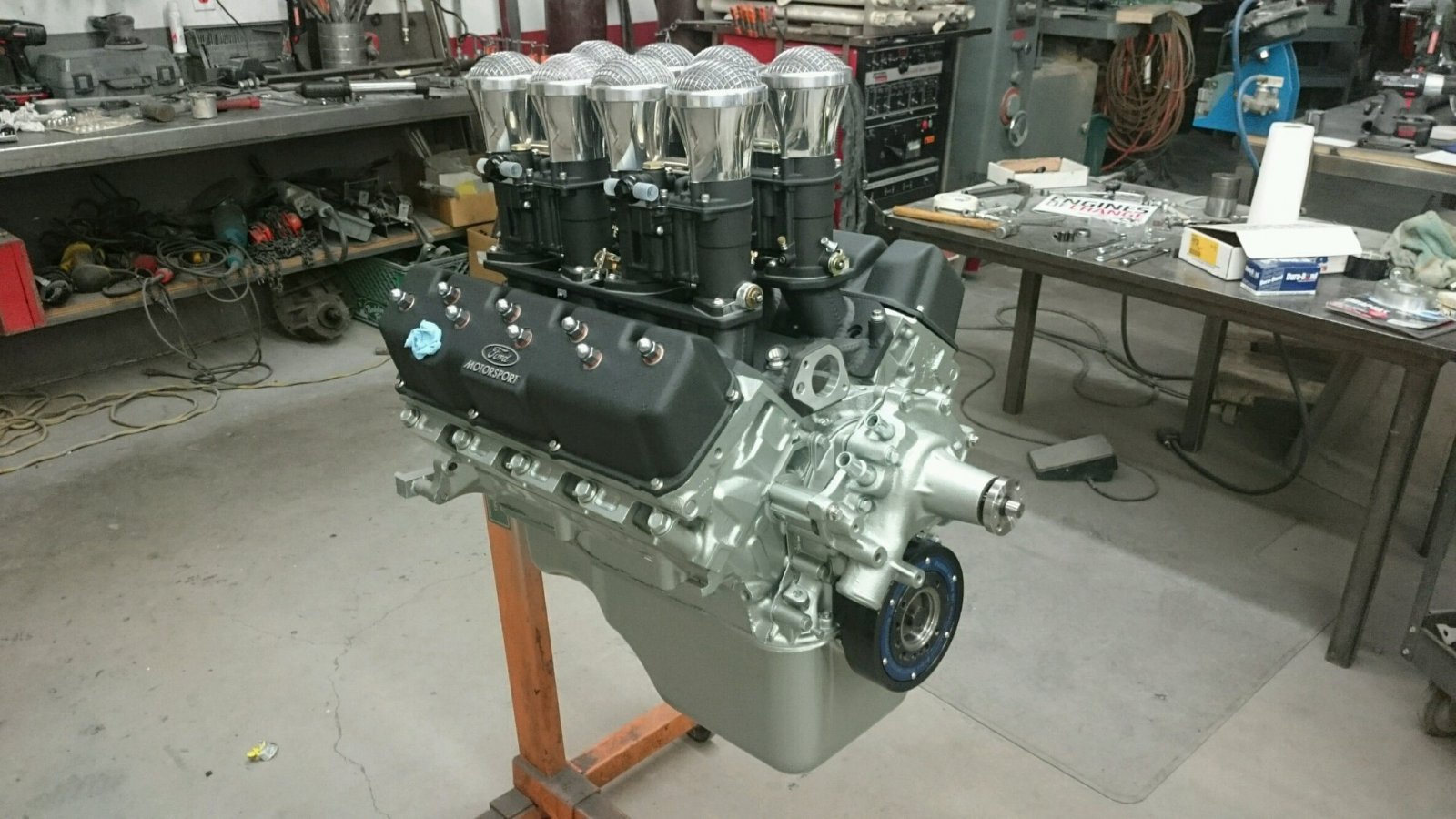

  7. I had a car years ago I ran with mechanical injection and although it looked COOL, it was kind of a pain in the *** to drive on a daily basis...I put a check valve in-line at the tank to correct the
    long cranking time to start problem and I didn't have to carry a bottle around with me. Now I run 16 electronic fuel injectors driven by a FAST computer - still has that Old School Cool look, but so much more driveable and reliable[/ATTACH] MOTOR 2.jpeg 281.JPG

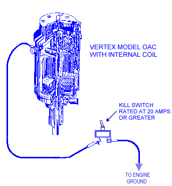

    as for the ground you have two different things going on because of the magneto. ground for power from the battery and ground for causing an electrical short for stopping spark from the magneto.
    generally you will have a ground wire running from the battery to the starter, and a positive wire running from battery pos. to the starter solenoid. being a race car.... who knows how the wiring was run. it may have only been wired to run the starter... the car may have been push started and not even needed a battery at all. technically the battery has no effect on the magneto operation as it creates it's own power and grounds to the engine block.
    forget the battery for the moment. find the wire on the magneto. there should only be one. trace it back. tell us where it goes

    A magneto needs a "kill" switch to kill juice to it otherwise
    you can't turn off the engine once it is started.

    The mag generates it's own electricity with a built in dynamo. As long as the engine is turning, the mag will be generating spark. The only way to shut it off is to run that current to ground. So you have a wire running from the mag to a switch and then to ground. If the switch is open, the engine will run. If the switch is closed the current will run to ground and you will have no spark. Opposite of normal ignitions. Running power from the battery to the mag will burn up the coil and that's the end of your mag. No wire should connect the mag to anywhere on the battery.

    rich has you right.... its as simple as you get.. chances are the magneto doesn't have an advance curve either... it's fixed.
    here's the sum total of a wiring diagram for a vertex magneto:

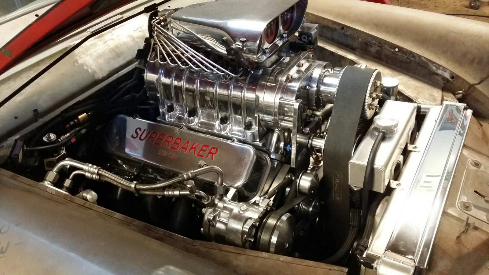

  22. It's a BBC in a 1954 SUTDEBAKER body with a full tube ch***ie, built the car around the motor...hit my Avatar and it has my SUPERBAKER PROJECT build pictures.

    Exactly and to the point. The stud on the side of a Vertex magneto is where the wire goes from a kill switch and from the other side of switch to a good ground preferably on the engine block.
