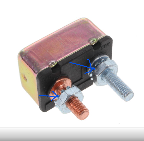

  7. Kerrynzl
    Joined: Jun 20, 2010
    Posts: 3,659
    Kerrynzl
    You must use "star washers" under electrical terminals. sanding isn't good enough by itself.
    If you have 2 ground cables to the same bolt, make sure the Battery ground terminal goes next to the block .
    Why don't you get a set of jumper cables and connect another parallel ground and another + to the starter.
    This process is to eliminate or confirm faulty cables.
    Also you are measuring voltage at the battery, have you measured it at the starter post?
    Do this before throwing even more parts at it [or returning parts]
    winduptoy likes this.

  11. Kerrynzl
    Posts: 3,659
    Kerrynzl
    This was told to me by an old "trade school" teacher in the 70's
    We got into a discussion about trunk mounted batteries ,and the need to run a ground cable from the battery up to the starter motor [which was the general consensus]
    He said the Ch***is or Body conducts electricity better than any cable that has voltage drop. So the cables are better to be as short as possible and use star washers at connections.
    Most manufacturers use a star washer [or captive star washer] for terminals. Go down to your local U-pull and unbolt a few and have a look for yourself.
    Even now when you buy electrical components with posts ,they normally have star washers
    The best washer to use is a "Serrated Belleville" washer.

  13. Kerrynzl
    Posts: 3,659
    Kerrynzl
    I've always used star washers , and you haven't which means one of us has been lucky .
    I just went out and checked some of my vehicles.
    My 2005 Falcon wagon has a star washer on the braided ground wire at the engine [but not at the body end]
    My 2005 Mustang [FR500C] has serrated Belleville washers on the ground post and a star washer on the starter motor.
    I cant check my Toyota Hybrid because I need to pull all the rear seat.
    And I cant check my Italian car without pulling all the plastics and air intake [normal quality control rules don't apply to Italian cars:)]
    My 57 Chevy has star washers everywhere [because I installed them myself]
  14. pprather
