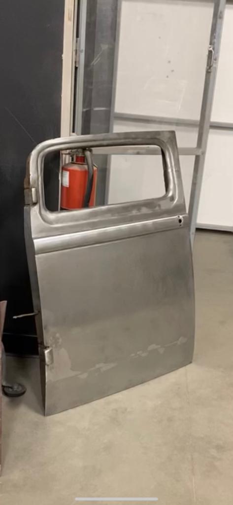

    Thanks everyone for the nice comments and encouragement. Made a rear crossmember for the spring and set the overall ride height. Kicked up the rear part of the frame to the body and shortened the rear frame horns since I won’t have a stock 32 fuel tank. Then made a slightly curved spreader bar that perfectly curves with the rear body line. Then after moved onto repairing one of the doors. It had a patch done in it long ago and they did a very bad job, so I spent about three days straightening it back out and re welding the patch. Using templates I was able to re create the 32 door curve. I have been learning lead work the last few weeks and decided to go that route on the door in a few places. Also figured lead was appropriate since this was a old 50s hot rod. Really happy with where this door is now, it will be about perfectly straight with a very light skim coat of filler I’m thinking. Also picked up a cool set of louvered hood tops. I got lucky because the Louvers just so happen to match my hood sides.

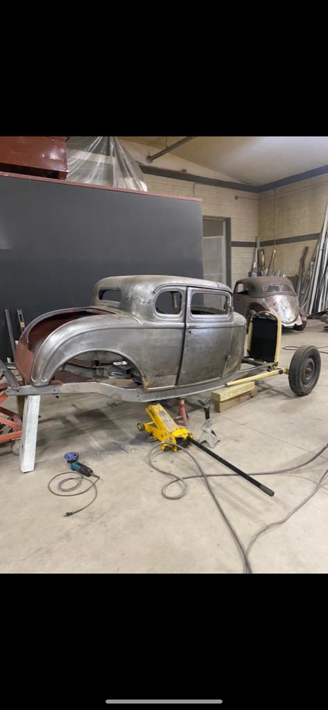

    Update on the coupe, I hated the chop it had from the 50s so I needed to chop It a hair more. It now has a half inch inch wedge chop overall from what it was before. Then a pic of the beginning‘s of the lead work.

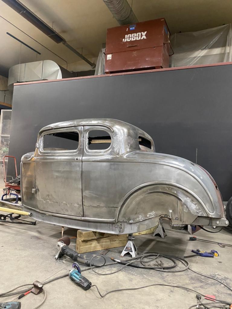

    Welded in the driver side wheel arch, something I’ve actually been dreading for a while now and it went surprisingly fast and I’m super happy with how it turned out. Really cool to see the body with all the lines now. Spot welded it to the sub rails and tied the quarter patch to it. I’d imagine it has a lot more strength back there now. After some more metal finishing I should be able to call this side of the car pretty much done. Then also a picture of how this side started the day I pulled it from the ba*****t I found it in. That picture also shows the new chop I did. Also want to add a picture of how bad this drivers side was only a little bit ago. Nothing fit and the body was beyond far off, so welding in the wheel arch really helped me feel like the body was getting closer to the light at the end of the tunnel.
