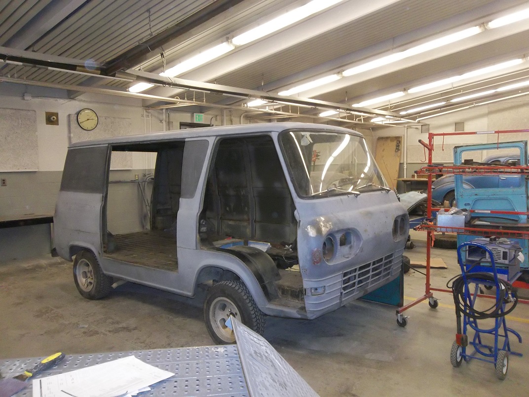

  1. Not that I needed to start another project with all I have going on, but my situation allows me to indulge my A.D.D. :D I traded for this little van last summer. Gave a running driving ranger 4x4 for it. I got the better deal!!
    Although my shop is full, as some of you know I teach body repair. My guys start their second quarter Monday. Even though the're learning, I'm gonna let them have at the van! :eek: This is going to be my daily driver. Going for a mid sixties shop truck look. Very mild. Like I said, a daily driver. Although I appreciate modern cars very much, I really want something old, and kinda cool to drive pretty much year round.
    It was disassembled when I got it. I don't like basket cases, as they are usually missing important parts. This one turned out to be very complete and all the parts bagged. Tons of new motor parts. Owner was getting ready to rebuild it and had some health issues. He sold it to a guy that was overwhelmed by the project, so I did the trade.
    Got the parts all sorted out, organized and stored today.
    Tomorrow she gets towed to school. We'll do the body work over the rest of the school year, then I'll do the drive train next summer. Progress will be slow, but I post the work my guys do from time to time.

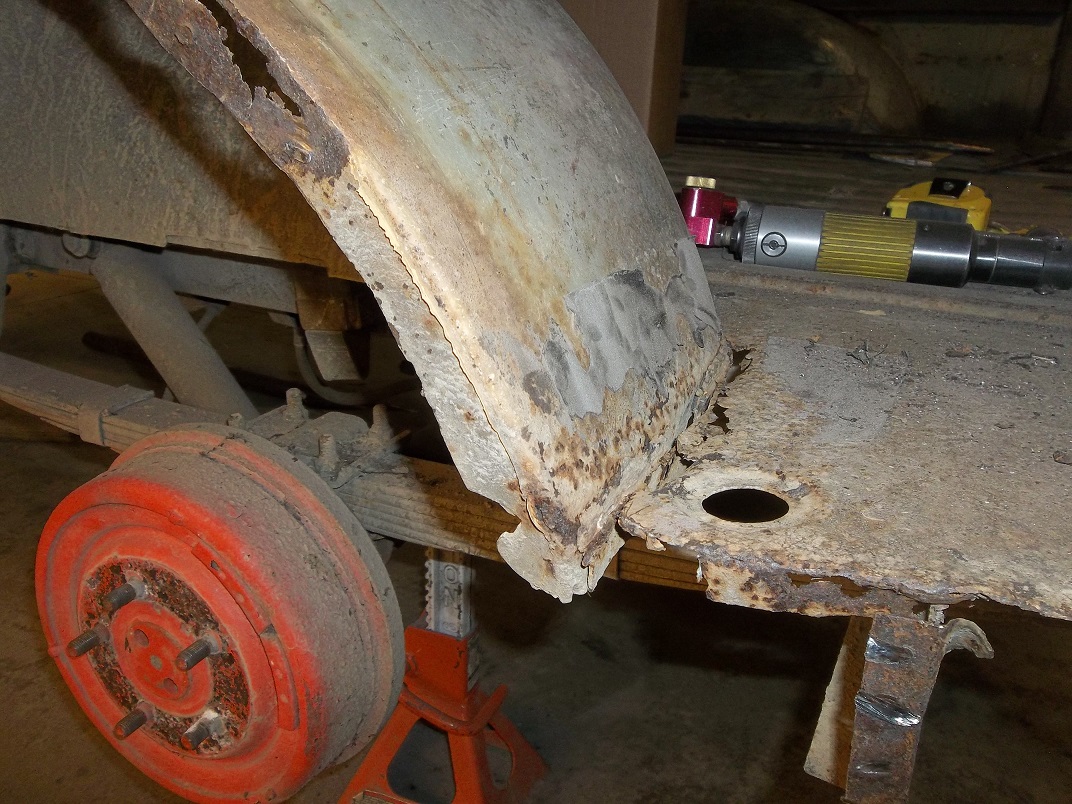

  9. Tear down and inspection today. Put her on the hoist. Found no rust in any of the under body structure. Good news for a unibody! Rear corners are rotted pretty good. The left lower body panel is pretty well gone. I don't know if anyone repops this panel? If not we'll have to make one. We'll start stripping paint tomorrow. I'm sure we'll find some more ugly!:D

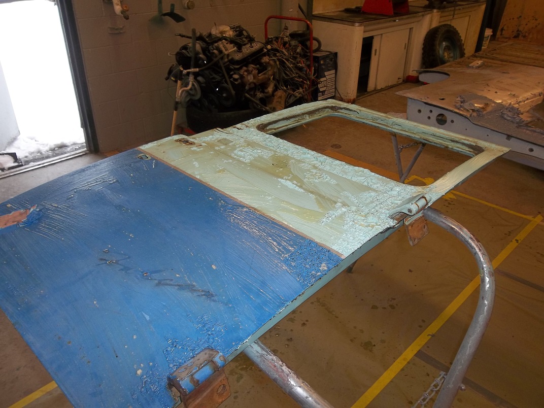

    We got the doors striped today. Lots of dents and dings. A shit load of holes to fill. Poor thing has had every type of mirror ever made bolted to it at one time or another!:D Not to mention a spare tire! We'll have to do a couple of lower skins, but no surprises.....yet!

    The panels I bought from Macs were really nice. I only had the passenger side lower panel and it did NOT have a 90* flange, but the left side might, or it was another option.

    i must say that i bought all the panels back in the day that are available, both rear fenders, both rear corners, the big drivers side lower, and the small passenger side lower and they were all absolute.....shit! HAHA. sorry man, im just being honest. they are definately not a simple remove and replace.....but if you have the skill to take on the job in the first place...you more than likely have the skill to manipulate the pieces to make them work. dont even get me started on how shitty the rear corners are.....but....in all fairness..they are still to this day being stamped from a 50 year old mold.....and hey...what other option is there? i was actually so pissed about the krinkles that are on the corner pieces i bought from mill supply that i went to the place they stamp them in akron an hour and a half one way. i showed them the pieces and the guy showed me a pallet of them.....that all looked the same way. he said "hey man, what do you expect....the mold is 50 years old.?" and away i went home.....determined to make them work. haha.

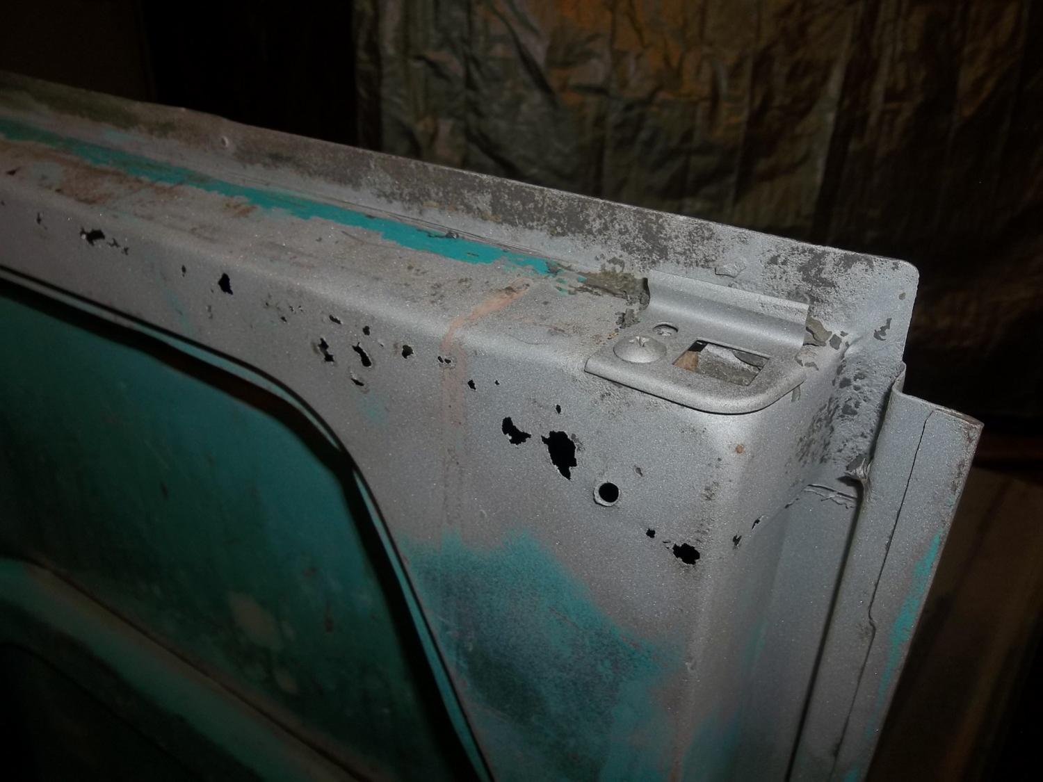

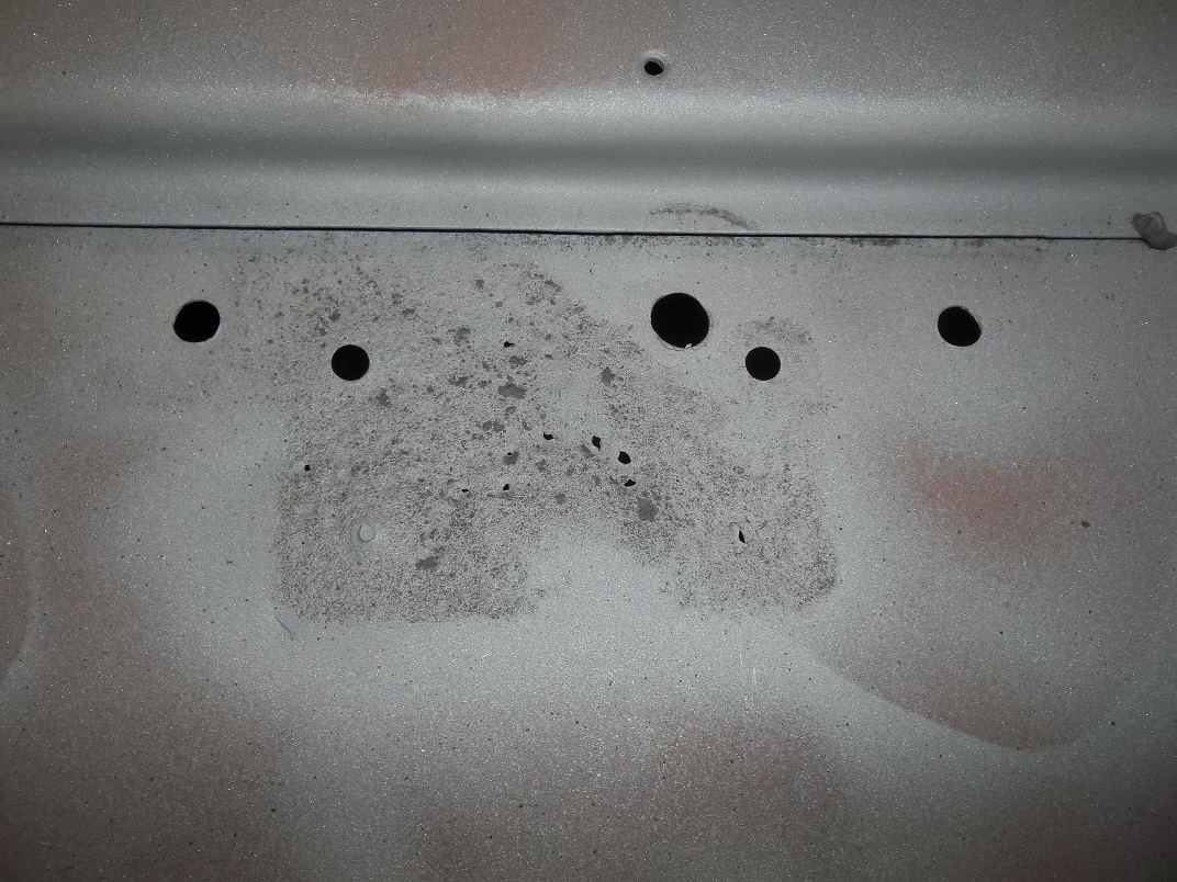

  17. I brought the side and rear doors home for a little sand blasting. As expected they were worse than they looked. Nothing too terrible, but all four will need bottoms and lower skins. One of the rears has enough damage, holes and rust under the licence plate reinforcement to need a skin almost to the body line.
