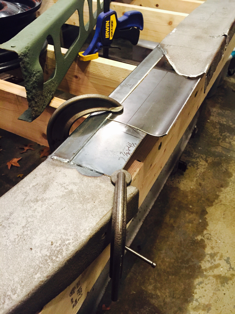

    Looks patchy...... I hope that it is structurally up to it
  27. Runnin shine
    Joined: Apr 12, 2013
    Posts: 3,385
    Runnin shine
    Clem, you would be correct.
    I take this frame saving very seriously. I trust it because...
    Welding on both sides
    Using fish plates
    Partial boxing
    Also this is the area where the X member legs join in to give their "x"tra support.
