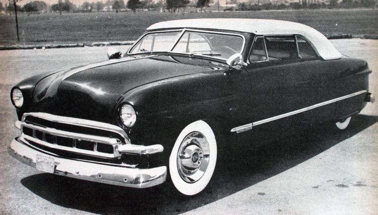

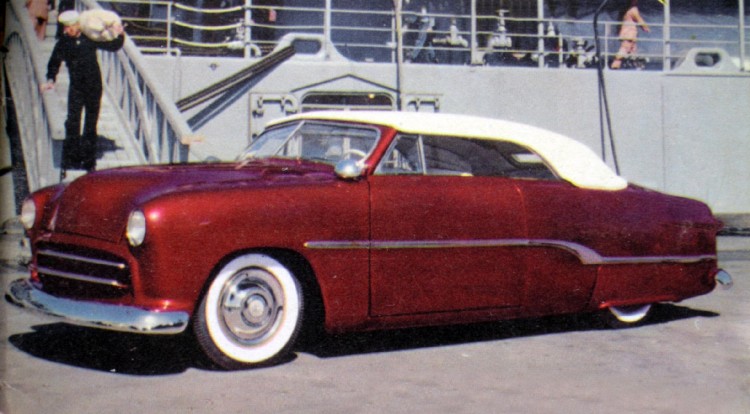

    Ill only chop it if I can just move the mounting location of the rear mechanism so it could be put back if needed but I found these pics on Ricksters site and I cant get over how cool these cars look

    I like the maroon/candy apple red one from rikster's site... looks like you've got a solid foundation to work on!
