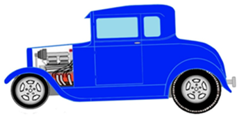

    upload_2024-12-28_5-10-5.png This is what we talked about and proposed for the final Model A build. A 301 SBC motor with a Paxton supercharger… etc.
    When my brother and I bought an old Model A coupe, our thoughts were to make it into a dual purpose street daily driver and weekend racer at our local Lion’s Dragstrip. We knew something was going to hinder us as we sat inside the cab with the stock seats. The two teenagers did not have much “wiggle” room. We were not huge by any standards, but for young teens, two of us in a small cab like the Model A coupe was going to be a challenge.
    Our friend’s 34 Ford 5 window coupe seemed larger and when two teenagers were inside, had plenty of room for stretching out and relaxing on short road trips. But for us, we were already looking into small sporty car bucket seats like our friend’s little sports car. Those seats were not only comfortable, but smaller than most seats. They also adjusted the back in many different degrees of comfort. Not so on the Model A seatback. Or, for that matter, at the time any Detroit stationary seat back that only went forward and back.

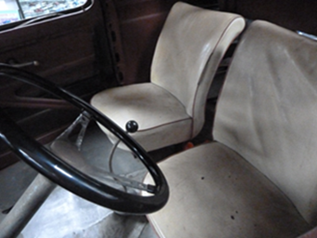

    The smaller sporty car bucket seats looked good, are/were very comfortable and adjust to any size body type. So, we knew our local junkyards had plenty of those adjustable bucket seats. If, and when they were to be installed, they would be moved back as far as possible and set up so it would still be comfortable.
    We sold the Model A within a month and the next time we considered a bucket seat installation was in our 1940 Willys Coupe we started to build for the B/Gas or C/Gas cl*** compe***ion. We selected those smaller sporty car seats and could adjust them to fit either brother, behind the wheel or as a p***enger.
    People are still in the standard bench seat mode and if that is the case, they take up the normal amount of space. But for folks in the 5’9” to 6 feet height and proportioned body style, they will cramp most comfortable driving positions. YRMV
    Similar style sporty car bucket seats with adjustable backs. They had their own bottom of the seat mounts that did not take much to adjust and install...

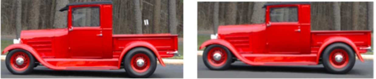

    The whole idea is to get more room for comfort driving. An extended cab certainly would solve the overall dimensions and give plenty of room. But, from an outside prospective at the extended cab, it does not stay within the original Model A truck cab style. A “big” extension would make the “**** end” too big and out of proportion.

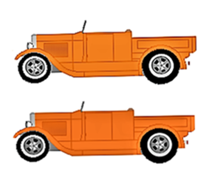

    The larger, better proportions in design...
    The version on the left is relatively stock, but it does need something. So, a short top chop and shortened bed still keeps the proportion, yet it makes the Model A truck look stock appearing. Only those totally inspecting the mods would criticize the larger door and shortened bed. But a longer bed looks too lengthy and hangs over too much. Room for the slight enlargement has to come from somewhere, so the bed gets shortened and the cab technically, moves back a few inches with a wider door and top.
    The idea came from a different truck modification that I saw being done for a huge guy, around 6’6” and he did not fit in the stock cab. So, the builders extended the doors and lengthened the cab roof just a tad to give the space necessary for a comfortable driving position. The plus/loss came from the shortened bed. The other option was to modify the pedal position to move it farther into the motor compartment if there is room. Most of the time there is no more room, so the only way to go is back to toward the bed.

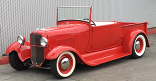

    I got an inspiration many drawings ago. An open roadster with anyone’s longer legs might be a challenge. Most roadsters were a little cramped as the generations grew. Even back in 1960, my brother and I had thoughts of a Model A roadster pick up for another project, but realized two brothers would not fit without altering/extending the seating area back into the shortened bed.
    We were both large for our age and I grew to almost 6’1” and I needed comfort for short or long distance driving. For us, it was a project we liked, but things just moved on in a different direction. The shortened bed was still big enough to haul parts and motors, if needed. Drawing is much easier to see the changes necessary.
    Also, sitting in an open roadster with big shoulders and height might be a challenge. Most roadsters were a little cramped as the generations grew in our society. A single driver might be ok, but a little cramped if one is 6 feet or over. So, the only way to get comfortable for the bigger folks is to extend the cab. The bed will be the item that gets shortened to keep the proportions right.
    There is only so much room modifying the seats and pedals without compromising driving comfort. Extended arm driving versus cramped bent elbows and the steering wheel intruding on comfort, is no one’s idea of cool cruising. Or safety for that matter… here is an orange Model A drawing I have been tossing around for ideas. For some reason, I added a cab top, then an RPU top and it looked awful, so it had to stay extended cab open roadster style for the RPU.
    There is even a nicely finished, red Model A RPU, extended, here on the HAMB built for more room in the cab… check it out...YRMV

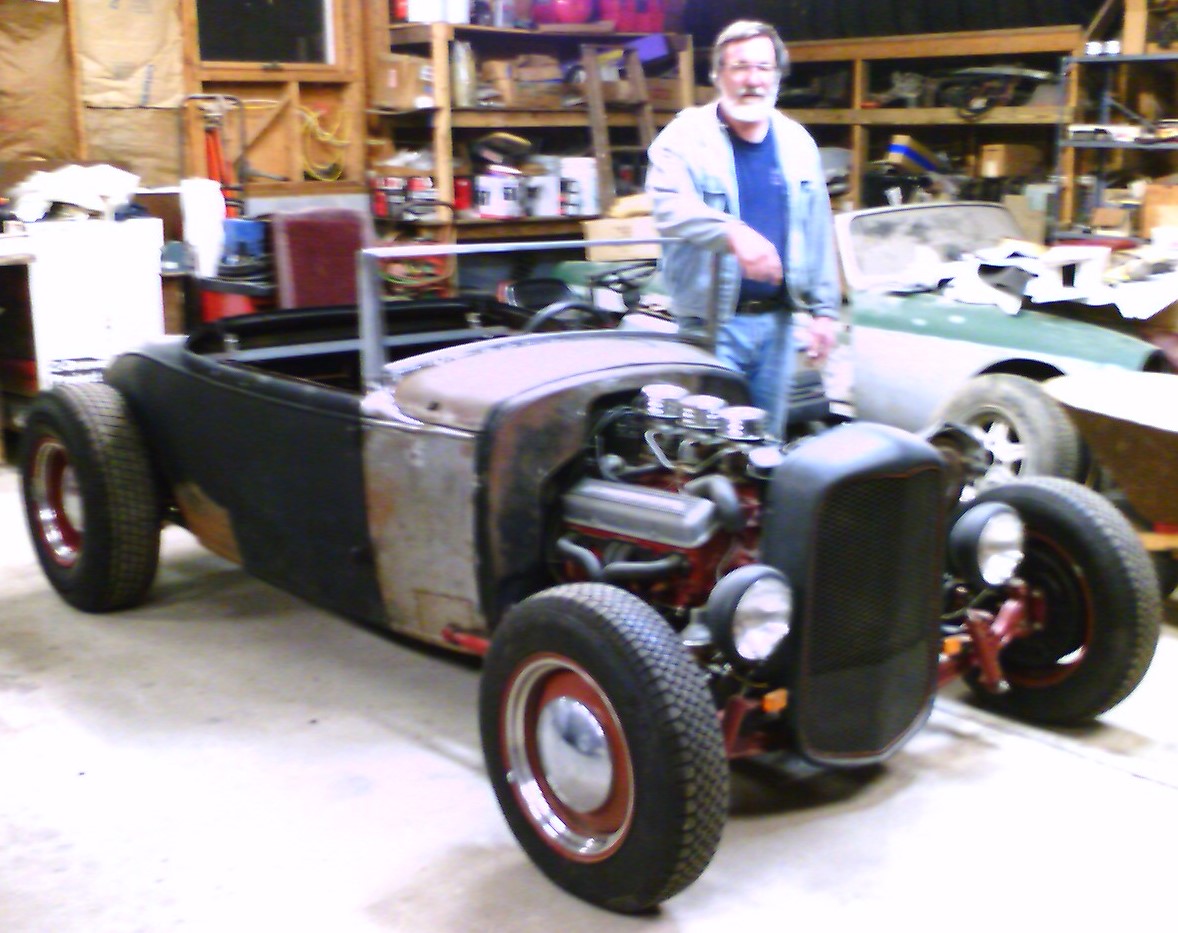

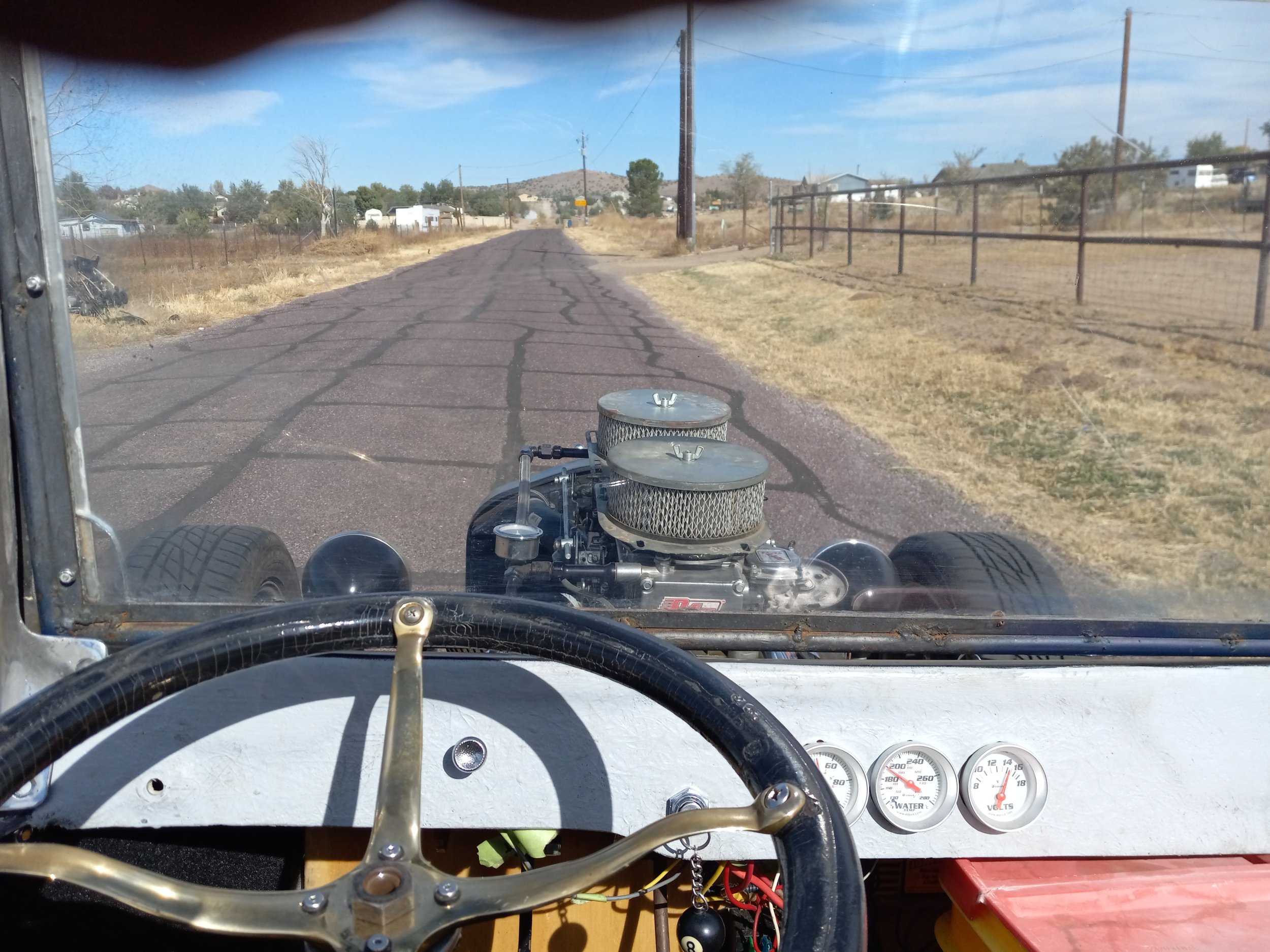

    This is mine. I've been copying from the MGB in the background.
