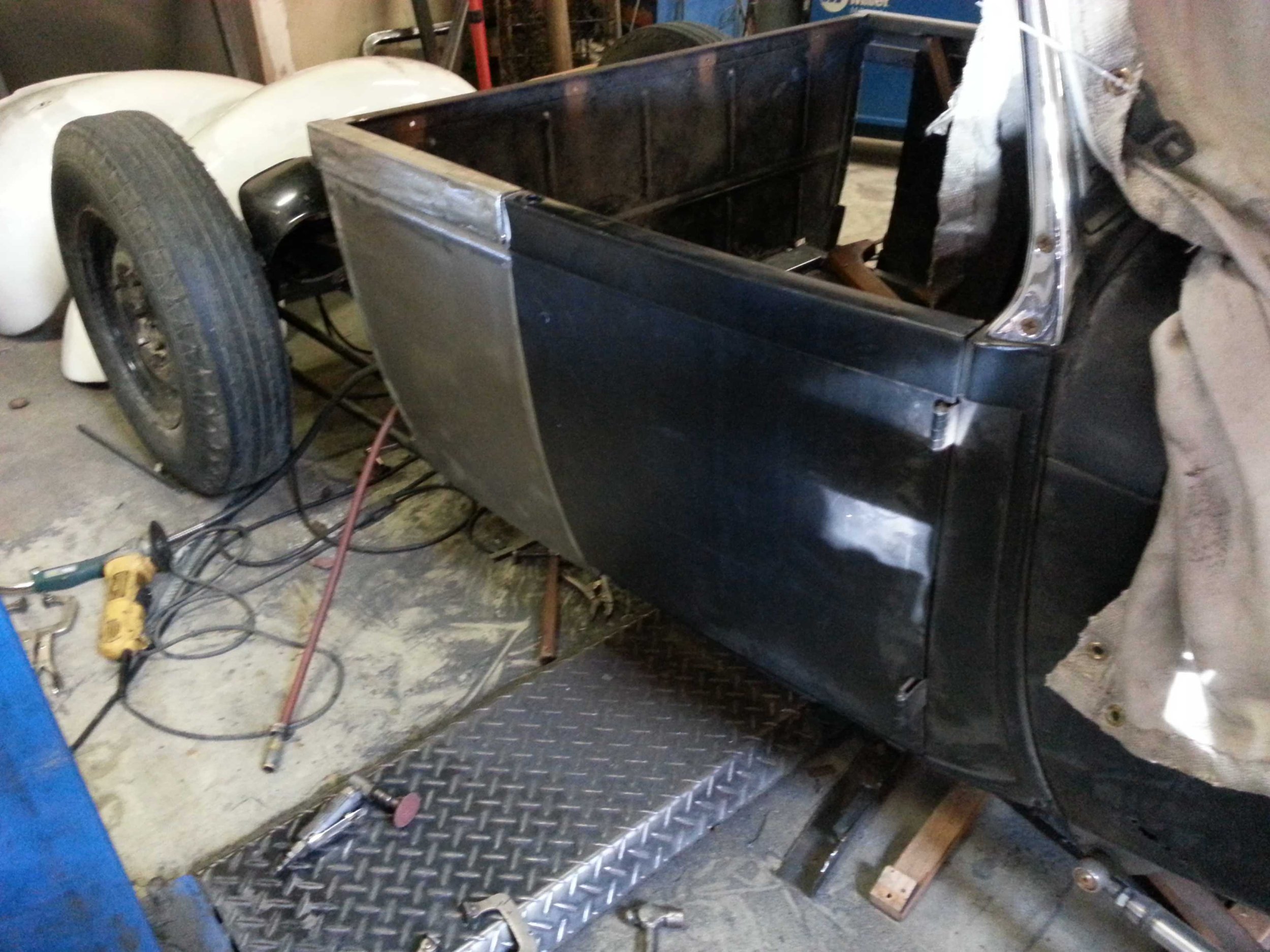

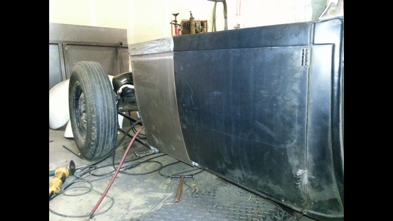

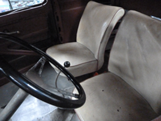

    Done that

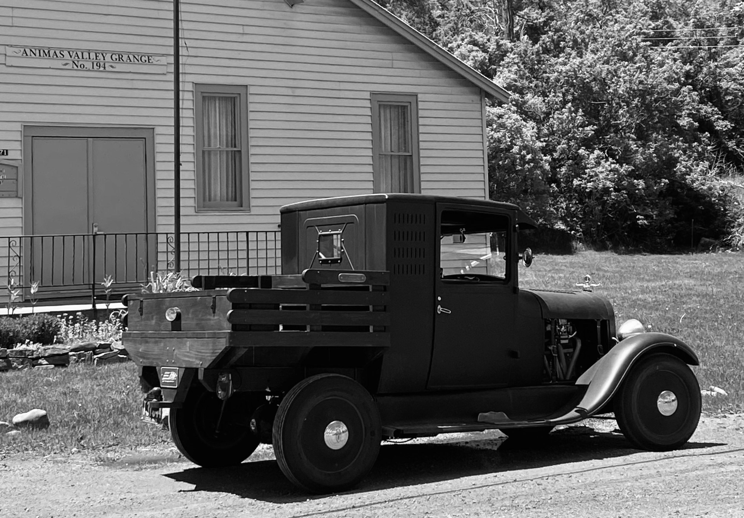

    When I bought my '29 Model A, the cab was a redwood C cab configuration with a stock cowl and windshield. I purchased used doors ($750 each) and new quarter panels that had been extended 6-1/2" along with new rear panel. Seats were brand new Jeep CJ-7 high backs. Used a lot of s**** lumber to get the correct angle of the seat base that I fabricated out of 1” square tubing. Still using the stock A steering wheel position. Plenty of leg room with the stretched cab and mounted the radio on the roof. Still need a prism to see the traffic lights with the visor. IMG_3676.jpeg
