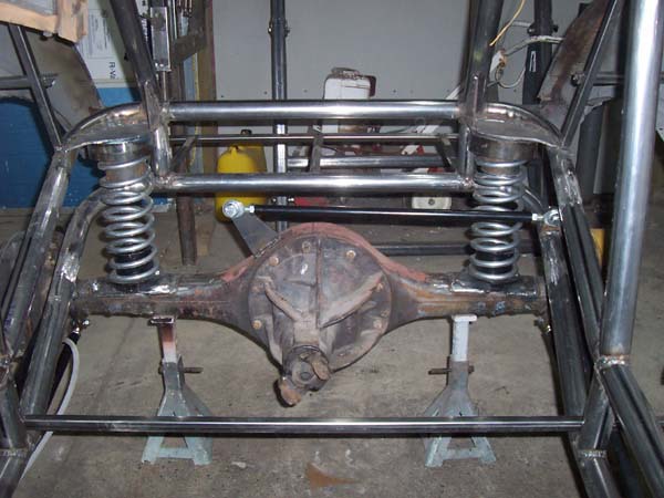

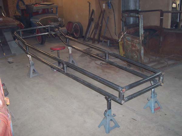

    First came my best shot at a dragmaster style chassis.

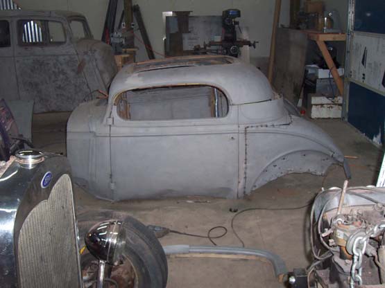

    Then it came time to trim 16 inches from the length, 4 inches from the width, and to take 6 out of the top.

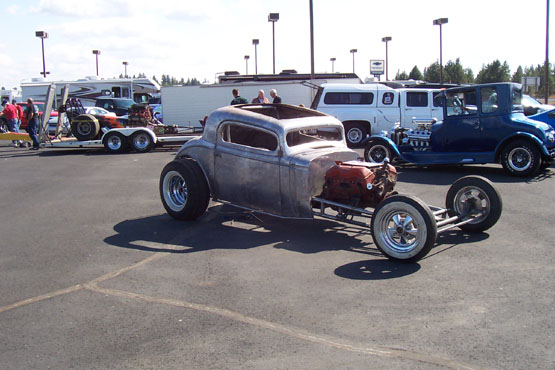

    After putting it together I realized it needed something a little different than the hemi, besides I needed the hemi for the willys gasser.A dual quad 409 seemed to be a natural choice. The 348 is just a mockup motor.

    Now it is really strting to evolve into something. So naturally I wanted to make the body flip like some kind of carnival ride.

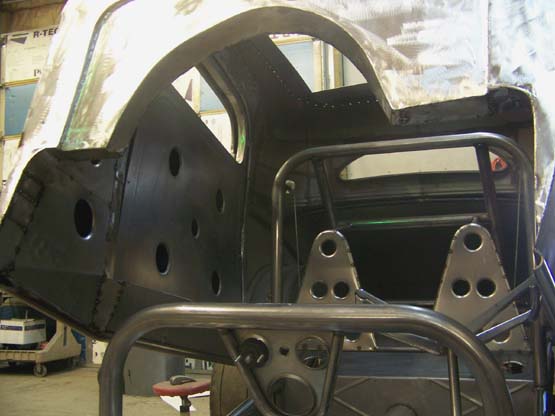

    The firewall has turned into a big job. Make it seal, function, and flip up with the car.

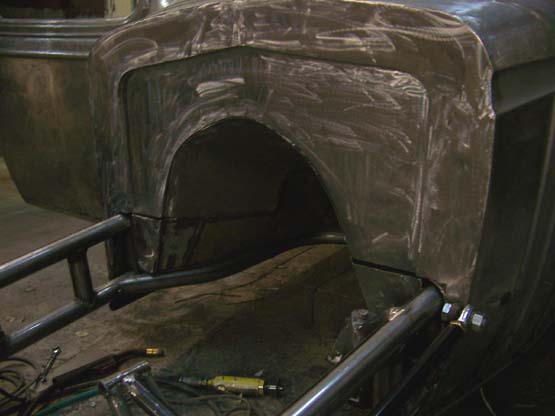

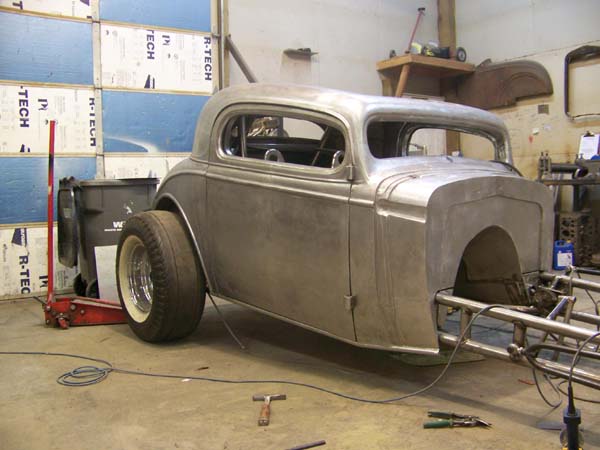

    I spent all day with an angle grinder, d.a and and my mig welder. I just wanted to get rid of any and all imperfections in the body. Not an easy task in a car that has been cut into over 30 pieces. the passenger side now looks like new metal. I am stoked. Tommorow is the drivers side

    Drivers side was a little harder. This side was smashed real hard when I got it. also the body sat on this side in the woods for ever, so it was a little thin in some spots. All of that aside, it looks ready to rumble.

    That thing looks awsome! I like how you made the body tilt. Do you have any more pics showing how you did that? Love the engine choice, I am a w-engine fanatic. Great job.

    Great work and progress as always . Would also like to see more on the tilt body .

    Looks Wild! Looks to be all metal finished? I like the pickup in the background;)
  30. Man that is nice, I am in LOVE with that chassis!!
    Got any before pics of the body? It looks good enough to be NOS!!
