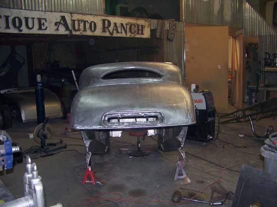

    update, blew it apart. Straightened the decklid area, cleaned up the ch***is. Got a few good pics.Heres also a few for those that wanted to see how the hinge works.
    Jim

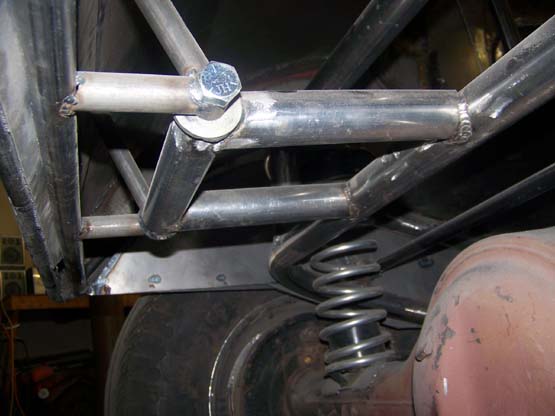

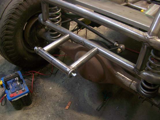

    THANK YOU THANK YOU THANK YOU!!!! This is EXACTLY what I am looking at building for my a pickup. I have full access to a bender, adn have the welder. I wanted to see how others were building theirs...
    I have a couple of questions:
    1. What size tubing are you using
    2. What kind of tubing (HREW, DOM, Chromo, ...)
    3. Why run the parr. frame rails instead of just on tube?
    4. Did yu base the frame off the original one?
    Thanks a LOT for the inspiration.
    DIma
  20. those zoomies look great , im going that direction here as well ..
  21. ALindustrial
    Joined: Aug 7, 2007
    Posts: 852
    ALindustrial
    hey jim -
    what kind are you feelin?
  22. JimSibley
    Joined: Jan 21, 2004
    Posts: 4,055
    JimSibley
    Tubing is 1.75 " .120 wall. welded steel.
    Dual tube is WAY stronger, kinda like a truss setup. Plus I wanted the look of the old dragmaster ch***is. As a matter of fact this all started with a post on the hamb requesting pics of dragmaster ch***is.
    I did not ever measure against an original 33 chevy frame, because I shortened , narrowed, chaopped and sectioned the car. What would be the point?

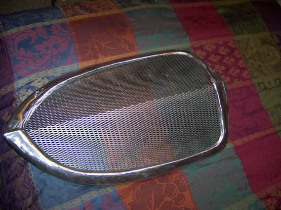

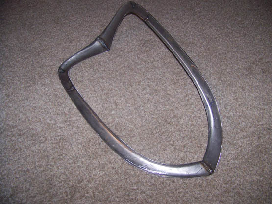

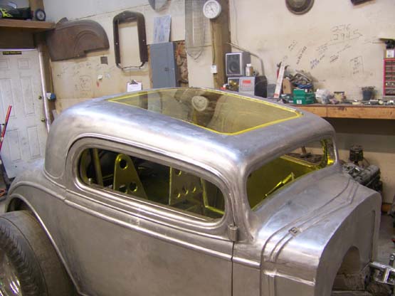

    Well, I have been workin on the grill and the roof. Heres a few shots from the last week.
  24. JimSibley
    Posts: 4,055
    JimSibley
    more pics. Thanks to Chris from the hamb for coming over and donating the lexan. Viva La HAMB!!
