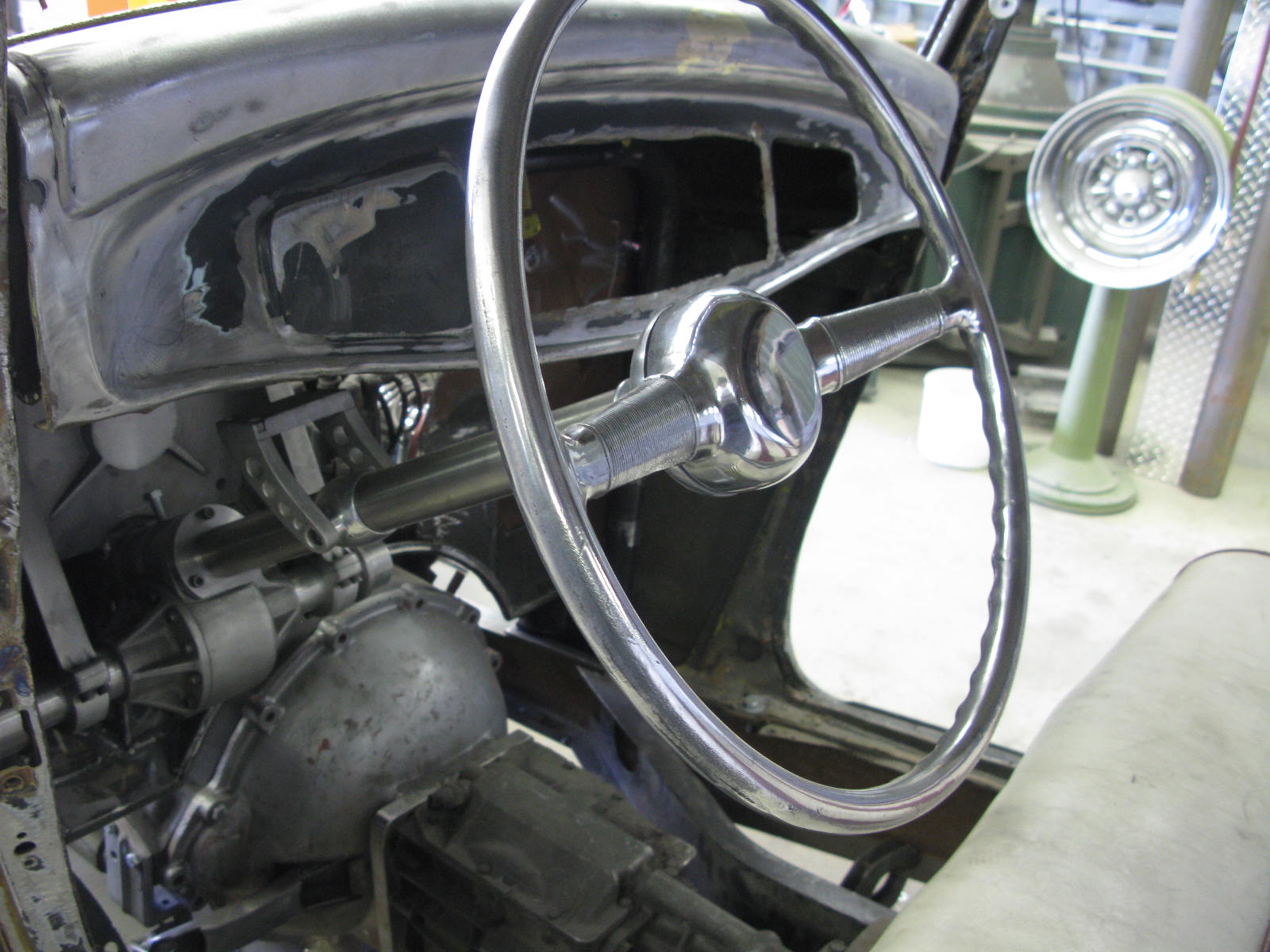

    Carved out a little time Saturday and got the inner hoop all mounted to the frame and to the firewall....very sturdy. I have the column mounted to the box now so that's off the list!!
    I removed the stock aluminum seal plate that was around the 3/4" dia steering shaft and machined up a steel one with a sleeve that the stainless column would press on to. Hope to run one of my 40 Ford aluminum steering wheels but that old lincoln wheel looks pretty good.

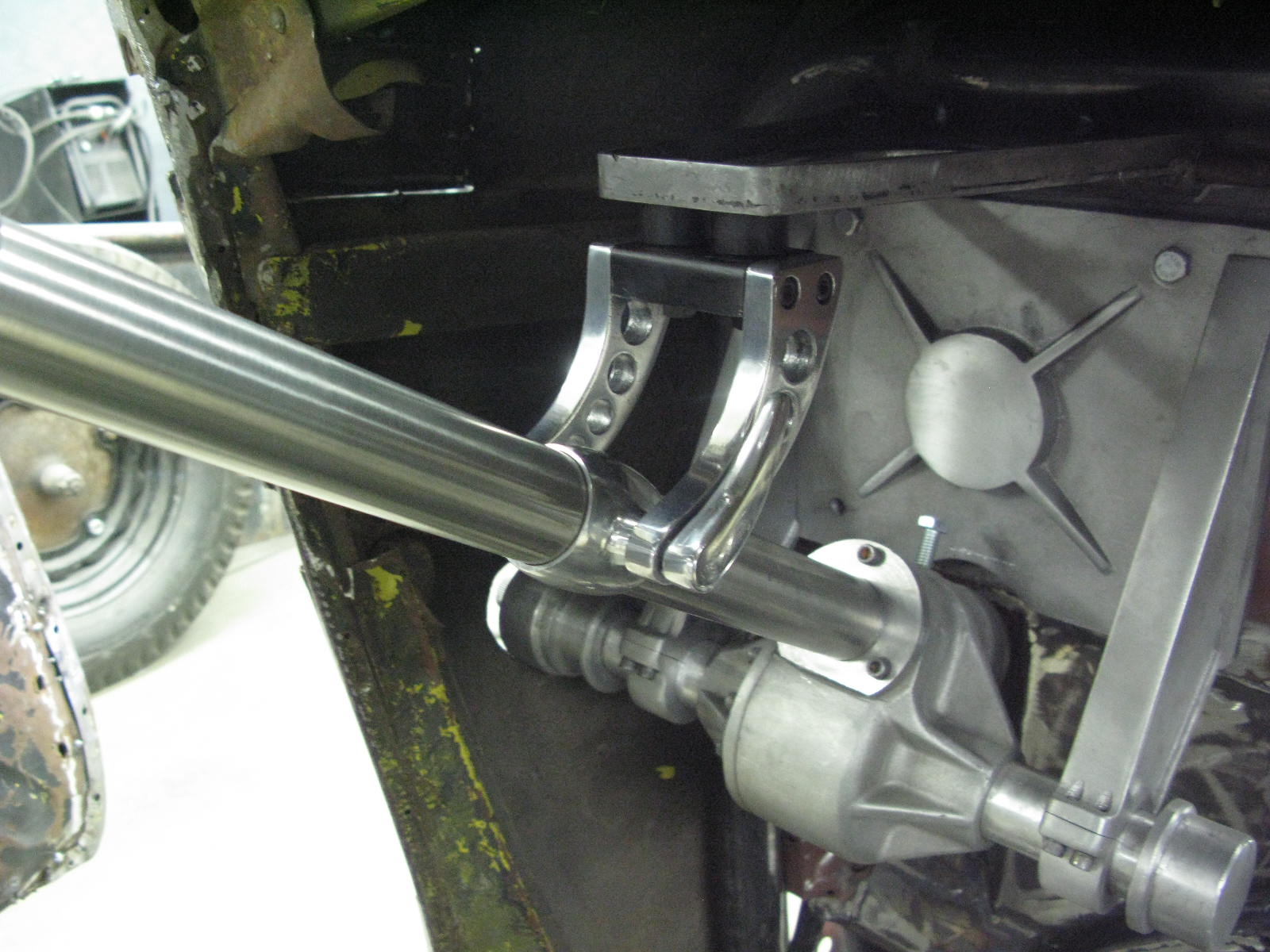

    I got carried away on the column drop today..I was going to mount it solid and call it done but came up with this... it has about 4"of adjustment now so this will be nice on long trips. The upper plate with the 2 large holes is hinged at the firewall letting the locking collar slide up or down the column. I whittled out the small locking arm out of one of my tail light brackets and this locks the collar in place. STEERING almost done!!!!
    Crafty
