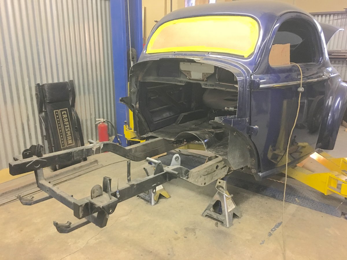

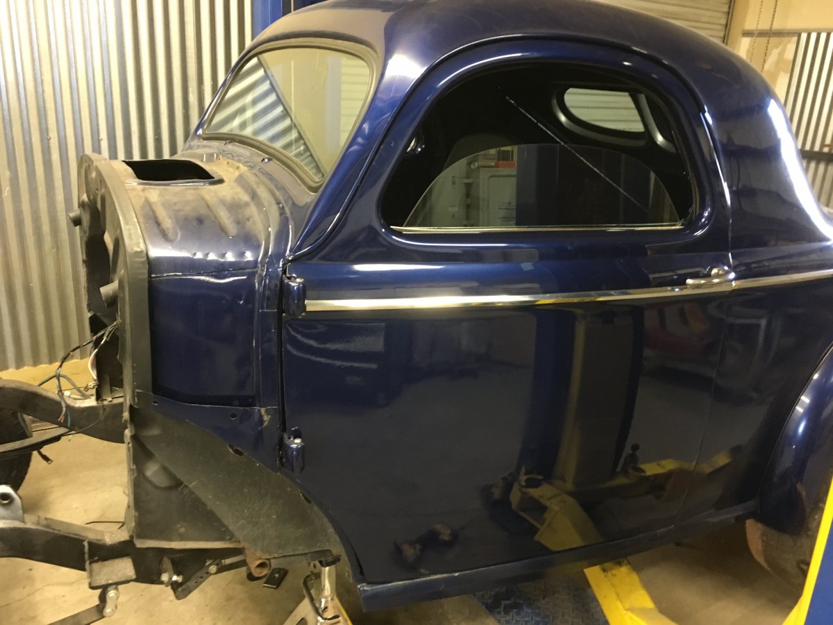

    hard HARD decision to cut firewall out but I have seen too many willys gassers with motor to far forward. so out the firwall comes along with the front frame stubs as we thought they were not worth messing with.

    much cleaner look

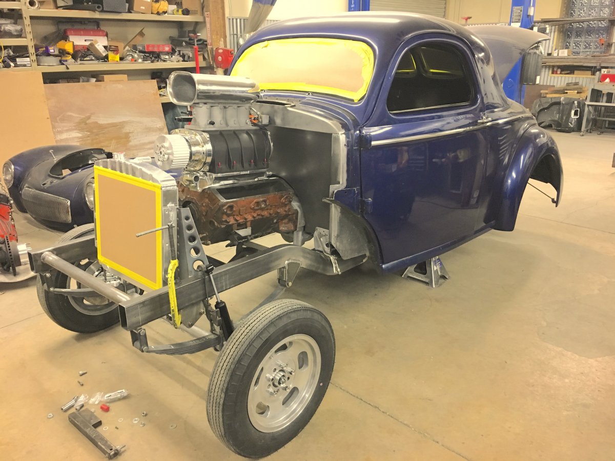

    going to be a sbc, with 6-71 and hilborn 4 port injection setup. electronic injection because i know the true headaches of trying to run old school mech injection on the street. also a m-22 4speed will be doing the shifting. i wanted to put a olds/pont 9.3 out back as i love the one i put in my 57 chevy but after talking with dave at fabcraft {great guy} i will be in for about 4,100 plus i have to put brakes together, . just cant do that when i can get a 9 inch drum to drum for 3000 shipped with all the goodies. still wished i could have the olds rear though!

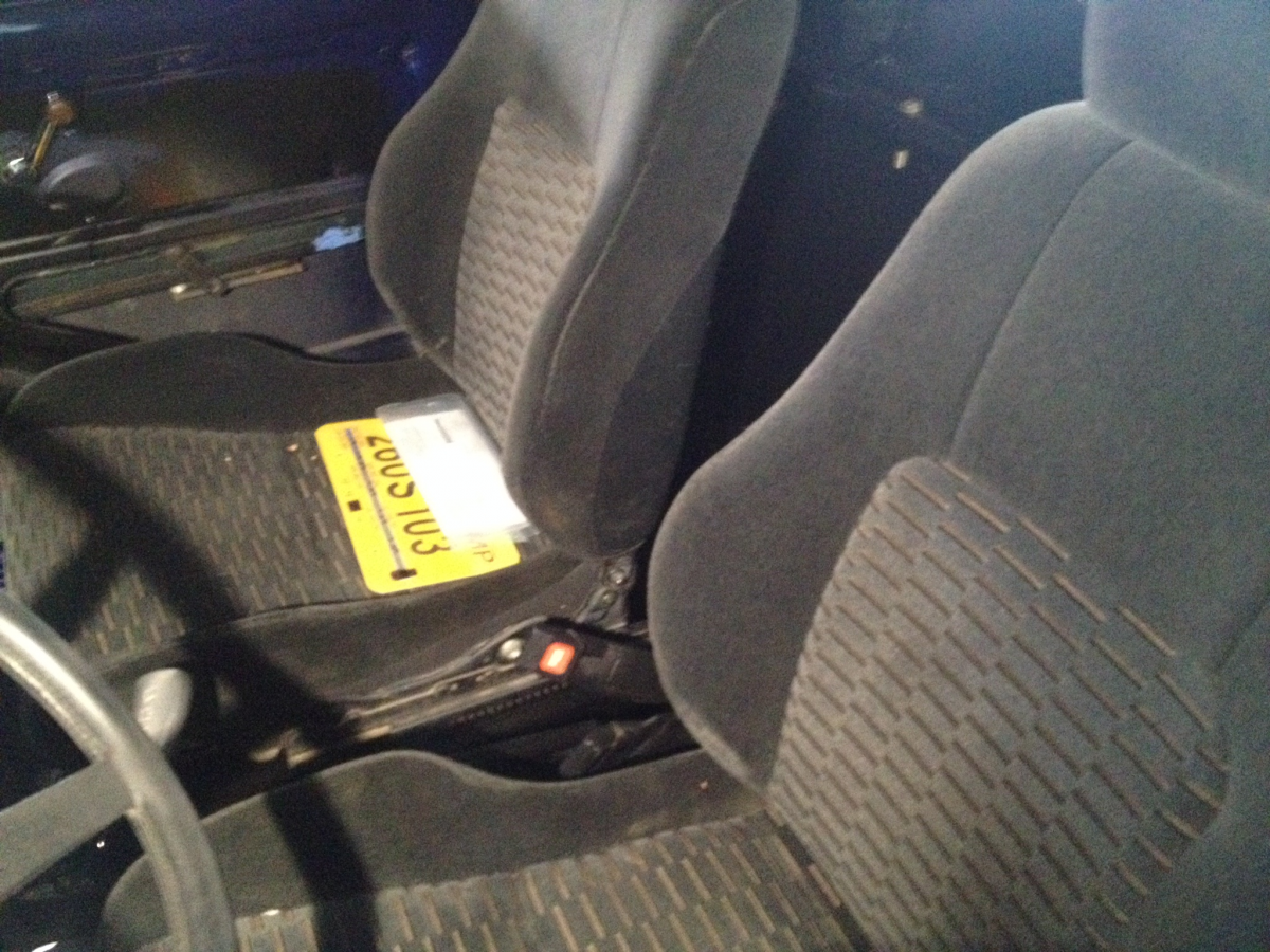

    randy in driver seat, checking seat position for proper arm hangout, ya gotta look cool!!! lol

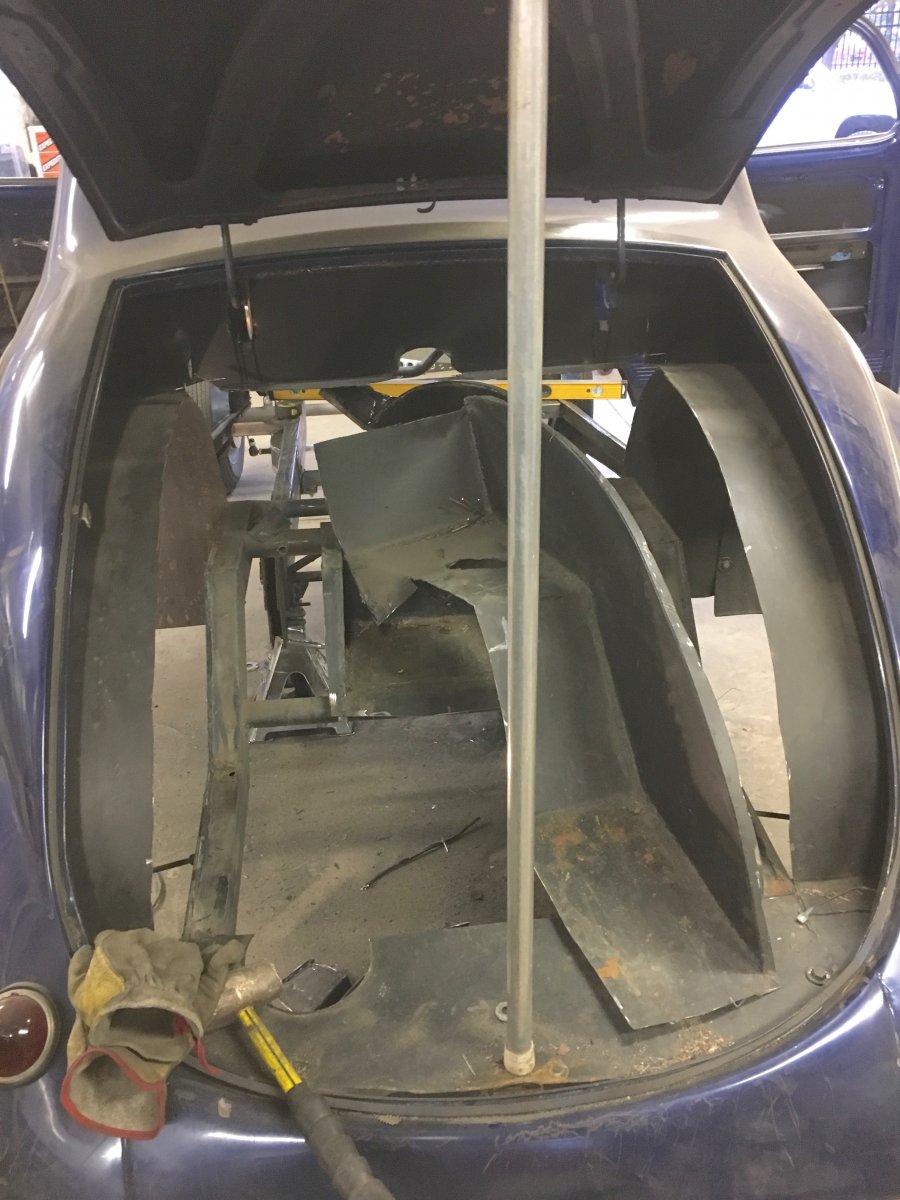

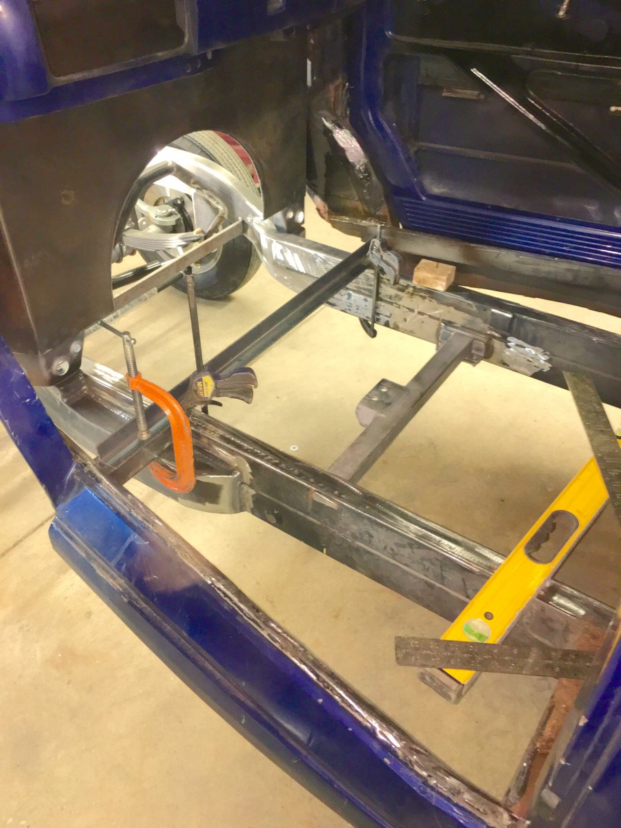

    started checking out rear suspension {4 link} and frame rails to see what was needed and what could be saved, decided it would be better to just scrap the whole rear clip and start fresh!
    kidcampbell71 and AHotRod like this.

    a couple more, man that old rear clip was some heavy duty stuff.

  29. charlierogers
    Joined: Jan 15, 2011
    Posts: 83
    charlierogers
    new frame rails, lean and mean.
    swade41 and AHotRod like this.
  30. charlierogers
    Posts: 83
    charlierogers
    body was very poorly mounted to old frame before and interior floors were crappy 22 gauge metal. new floors going in out of 16 gauge.plus some custom made torque boxes made to bolt front of cab to frame.
