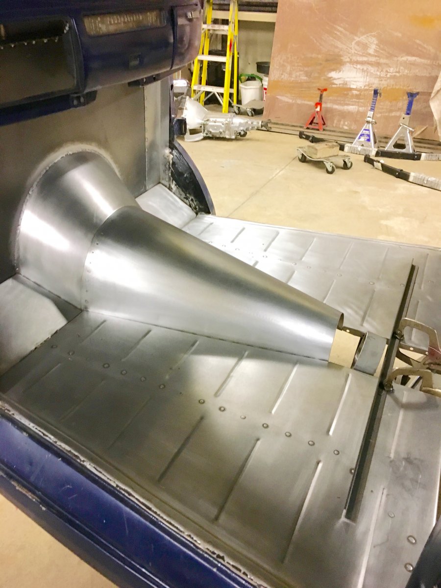

    charlierogers

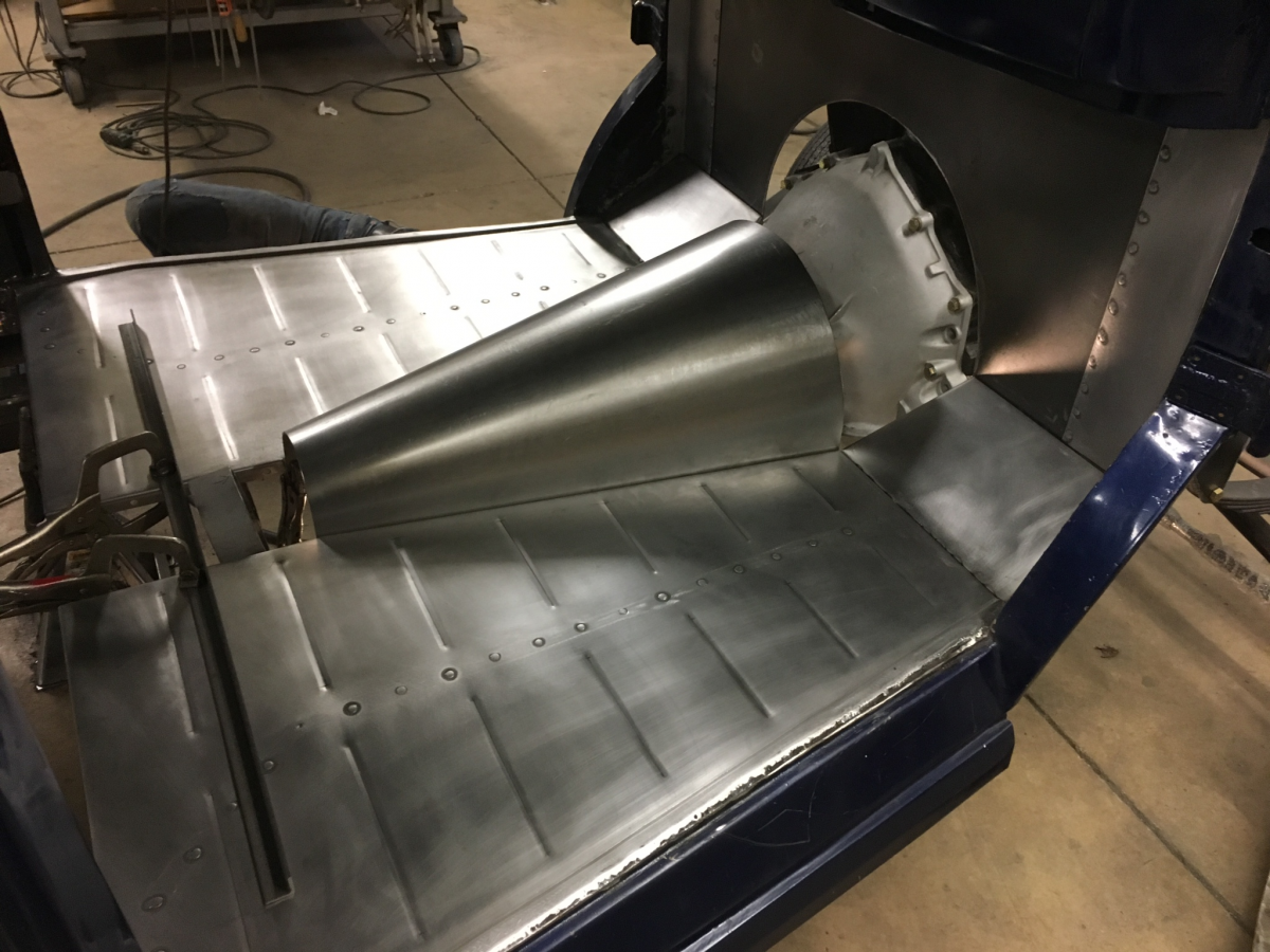

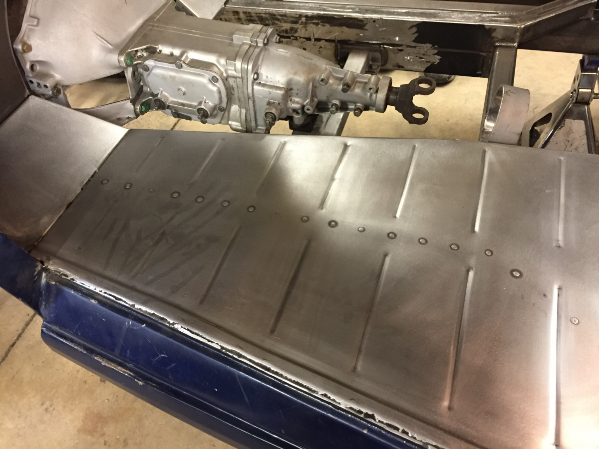

    cant figure out how to make pics bigger? anyway working on floor and trunk

    charlierogers

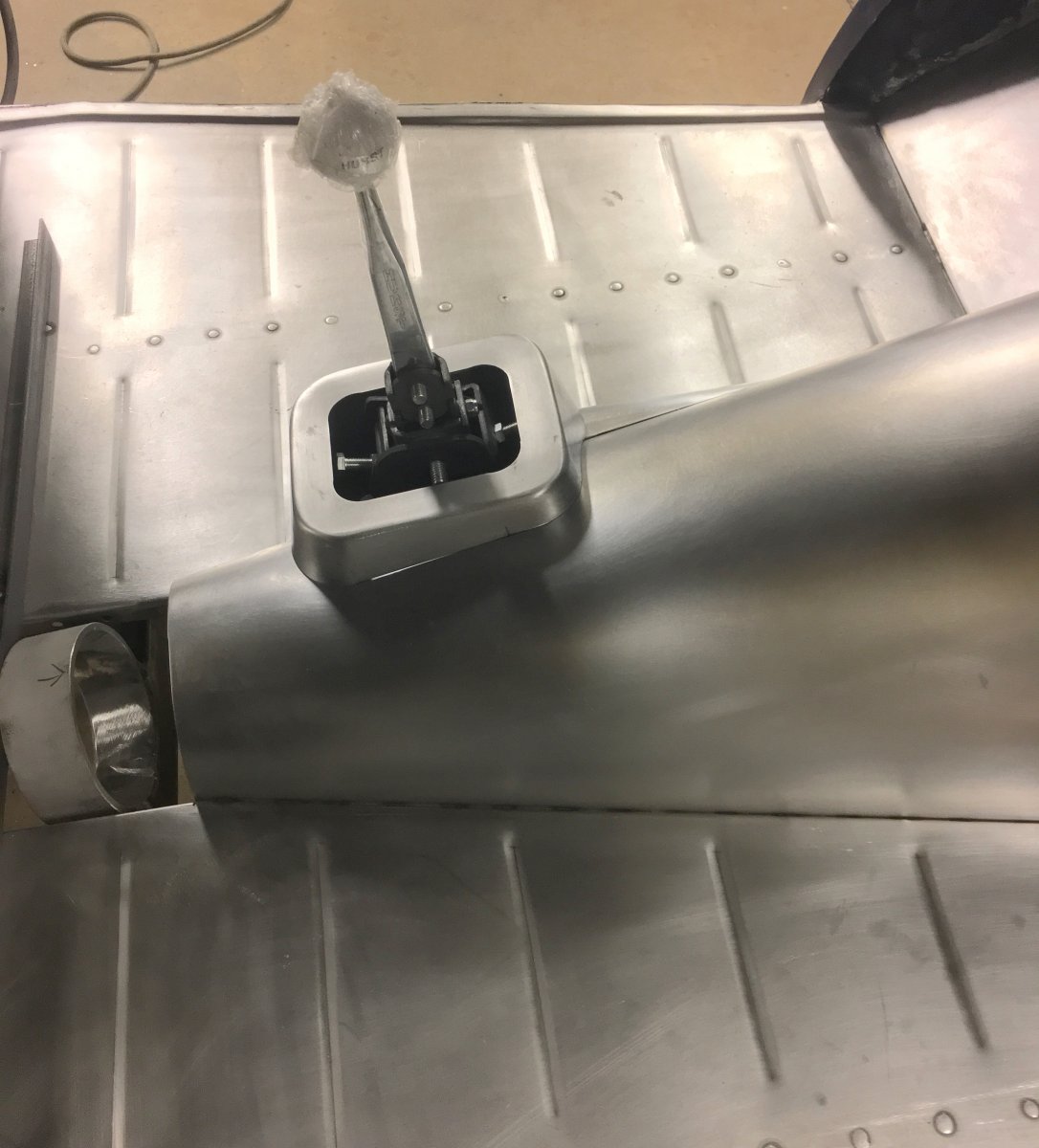

    more pics, have to mount my shifter and cut a hole in tunnel to make cover that I can unbolt to service shifter/linkage

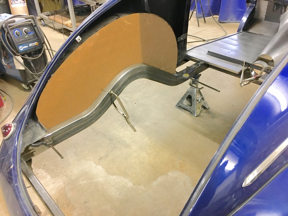

    charlierogers

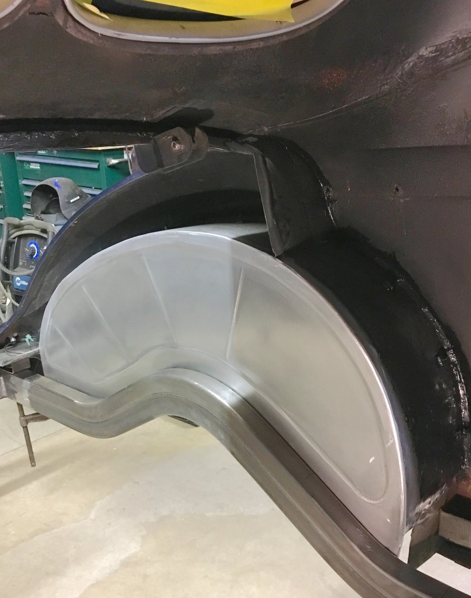

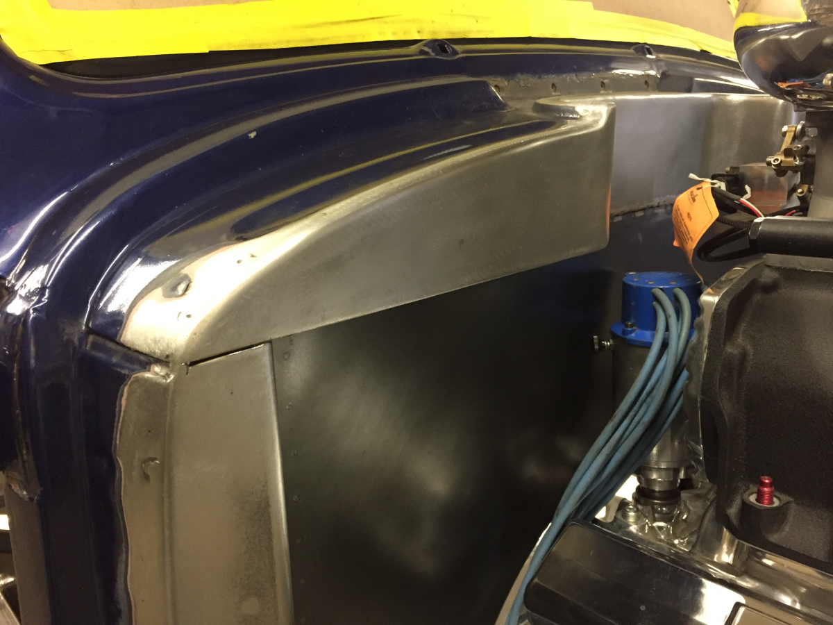

    more pics, starting on rear inner fenderwalls, going to try making them similar {looking} to stock.

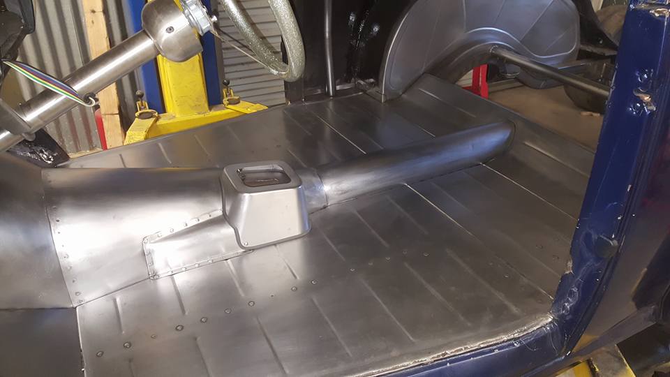

    hey guys heres a couple new floor shots. thanks for the pic tips elgringo 2017-1-24..1.jpg 2017-1-24..4.jpg

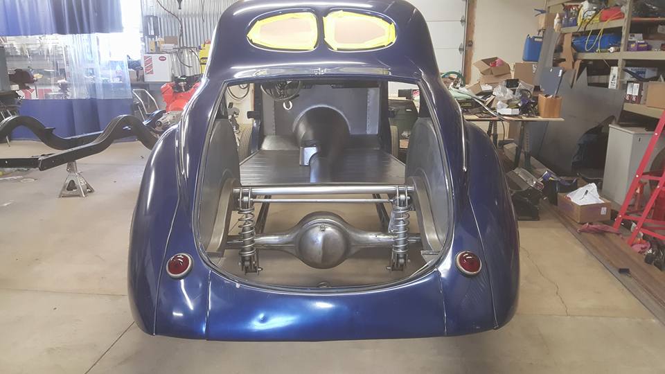

    got my olds 9.3 shortened 57 drum to drum, 4.11 gears, posi waiting on axles from fabcraft

    little update, took a little step backwards on build due to a motor change. keeping 6-71 and 4 port hilborn but s****ping sbc in favor of 409. I have center sect all built and ready to drop in, rear end and suspension done, should get trunk area finished up by end of weekend. will upload a couple pics in a little while {after dinner} gonna do every thing I can to get it to the meltdown this year.

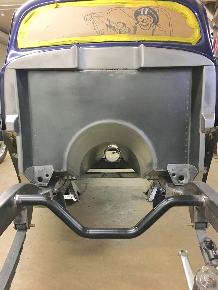

    charlierogers

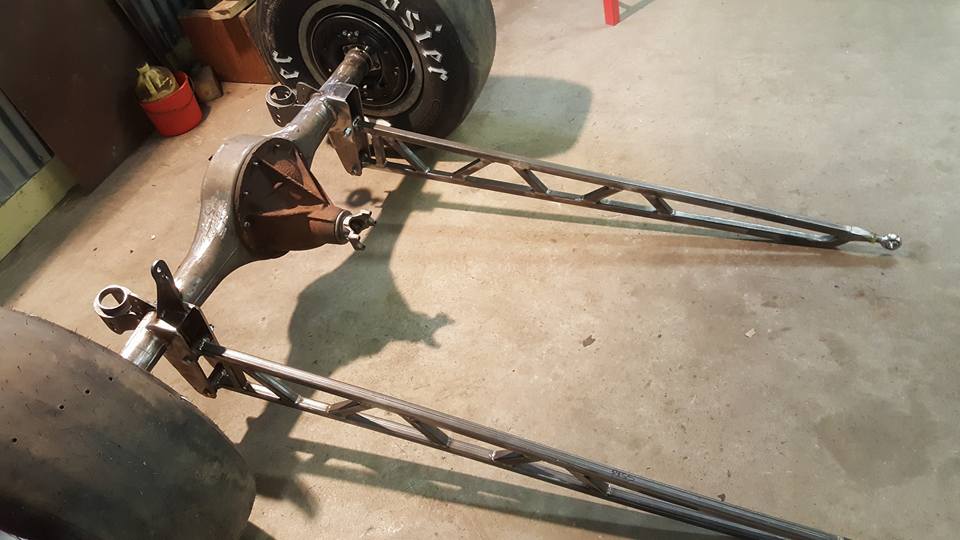

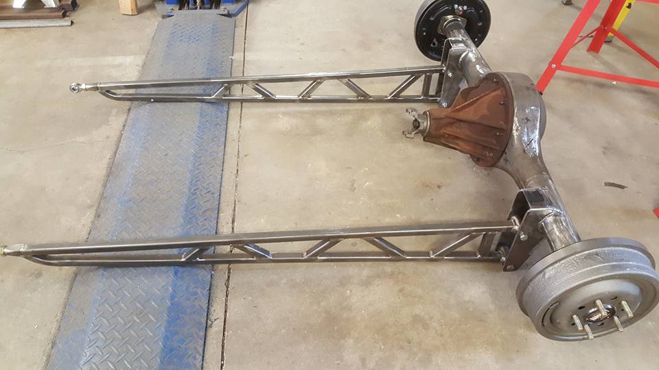

    rear axle, and custom built ladders, center section is just a extra we are using for mock up. 2017-3-6..001.jpg 2017-3-6..002.jpg 2017-3-6..003.jpg

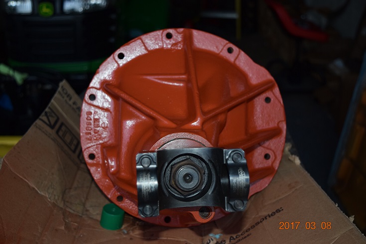

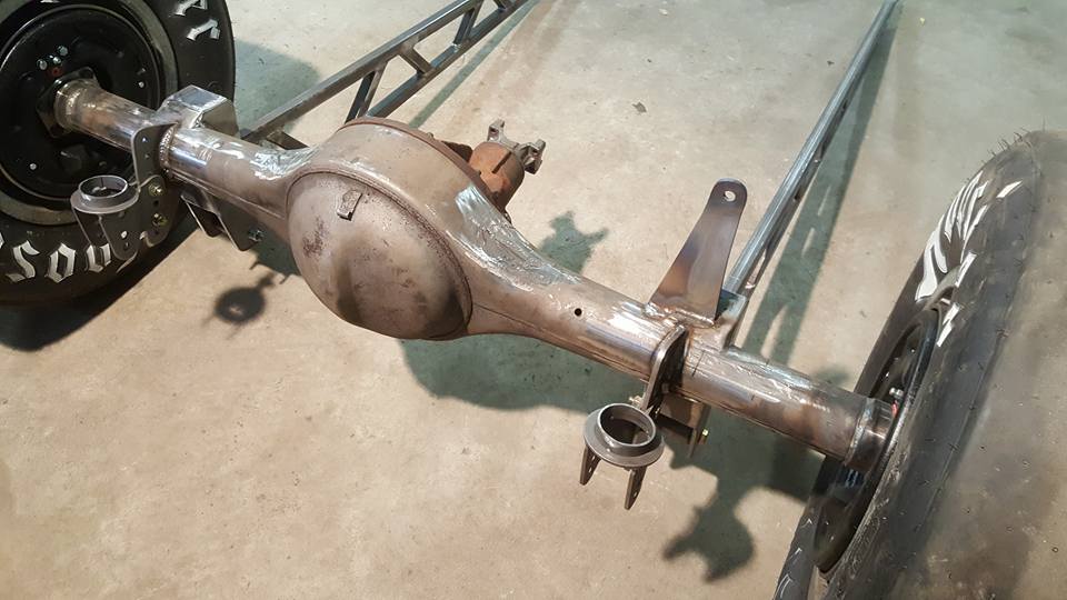

    DSC_0939.JPG center section, 4.11, trophy track posi, {fabcraft} billet main cap and billet yoke+axles from mark Williams for extra insurance! red oxide oh yea...... DSC_0942.JPG DSC_0943.JPG
