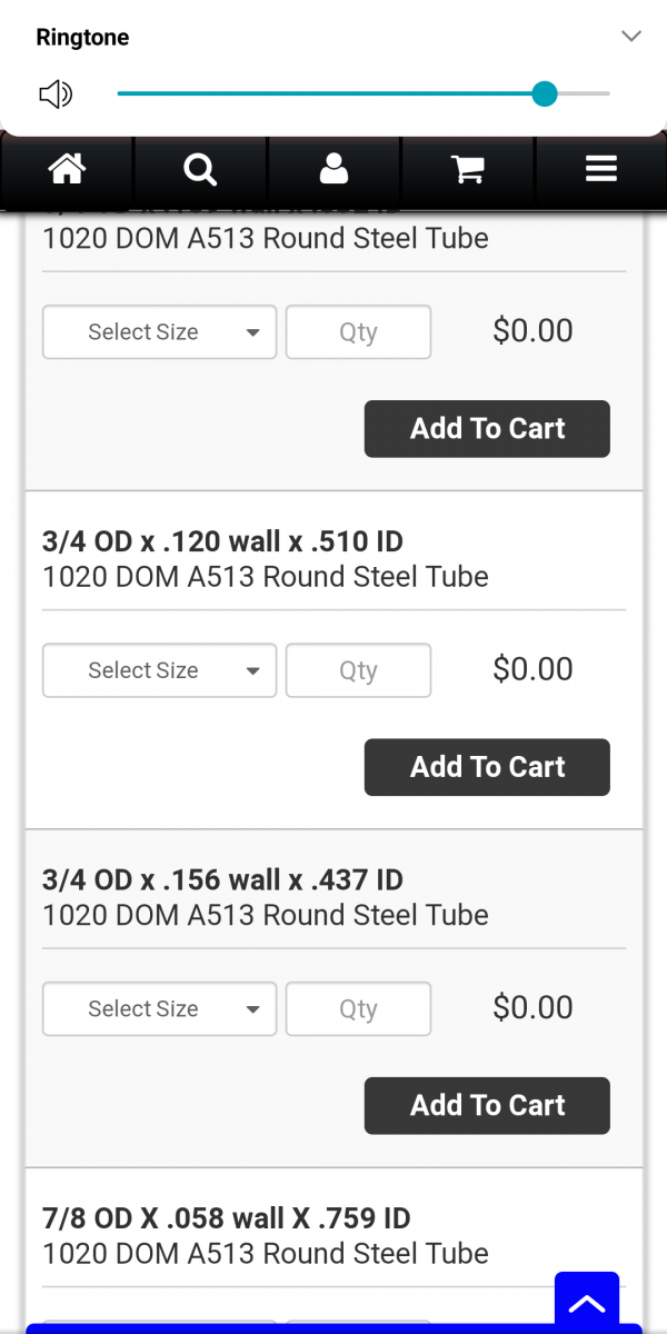

  7. yeah something a 7/16 bolt can fit in and maybe like 7/8 OD? Something sorta thick but I only have MIG
    I did find something online but it only had 5thou clearance I don’t know how well the bolt would fit
  8. I’m not sure what more details are needed, I’ve already contacted many steel shops and all of them do not have it. They all seem to have 7/8 ID and I’m sure a machine shop will charge more than the pipe is worth. Trying to avoid buying motor mounts Or paying the 80$ price tag for pre fab
    I might try the .437 id, the bolt is .432 but seems like it would be tight

  10. .156 wall seems a little thin for a mount don’t it? 5thou clearance sounds about right? For the bolt vs tube ID

    .156 seems thin but its thicker than typical ford frame rail material

    Metal Depot shows the size that Studebakerjoe showed in two ft sticks but at 25 and change it is spendy. https://www.metalsdepot.com/steel-products/steel-round-tube-dom

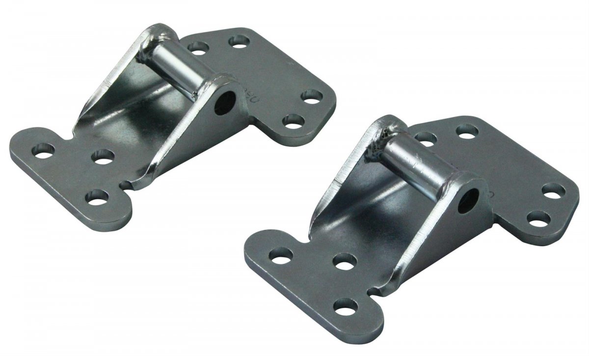

  15. So you trying to build something like this ?
    28C6A211-D912-4095-91EB-EDEB1C216CA7.jpeg 78D31B18-1079-4EB2-A787-CBFD3C82FECF.jpeg

  18. well sort off. But that top one you pictured,is the tube part I want
    it will be welded on the frame with some pieces, and it will slide into the factory early style chevy mounts (the rubber pad with 2 elongated ears)

    With free shipping that will do it.

    Depending on the end wall thickness chosen and the amount of distortion from welding you more than likely will still need to run a drill (or reamer) through it after welding.
    Pist-n-Broke likes this.
  27. that one I found being 5 thou clearance, I’m guessing you’d probably be right. Good point
